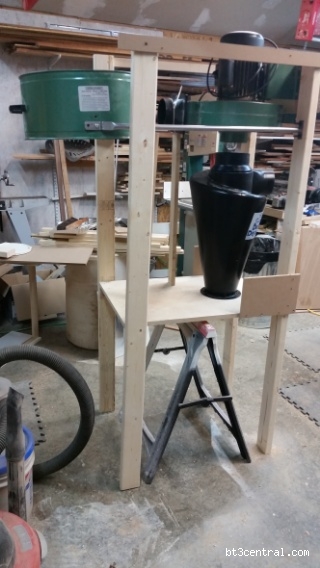

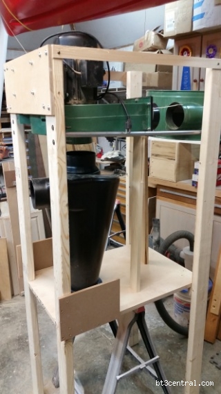

              I had planned to use only scraps but the 1x3s were too scrawny for the legs so today I upsized them to 2x4s and reattached everything.
              I haven't decided which direction the inlet will point but that is where it will be situated. I'll have to detach the board one last time to slip the coupler between the blower and the SDD as well as cut the hole for the SDD and route a shallow groove to accept the gasket that will sit on top of the trash can.
              I have a steel trash can that will be the dust catcher. I'll have to devise something to raise and lower the can under the platform.
              The four corner legs are not tied together yet.
                • 3760

                  I didn't realize there'd be that much suction. Anyway, with the can on the floor, there's about 3-4" of space between the top of the can and the bottom of the board. I think if the can sits on top of the old HF DC rolling base, it will fit, and will make moving the can in and out easier.. I'm still thinking I'll bungee the handles to that board when it's docked, though, just to ensure there are no air leaks.

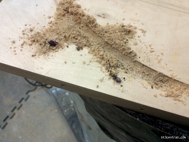

                    I guess if you do something long enough, you'll eventually see a little bit of everything. I made a quick router trammel to route a perfect circle to accept the top of my trash can. I guess I dawdled in spots because the round nose bit got the chips hot enough to make glowing embers. I wasn't sure what i was looking at at first until smoke started to rise out of the dust. Just to be safe, I'll move the dust can outside when I finish for the day.
