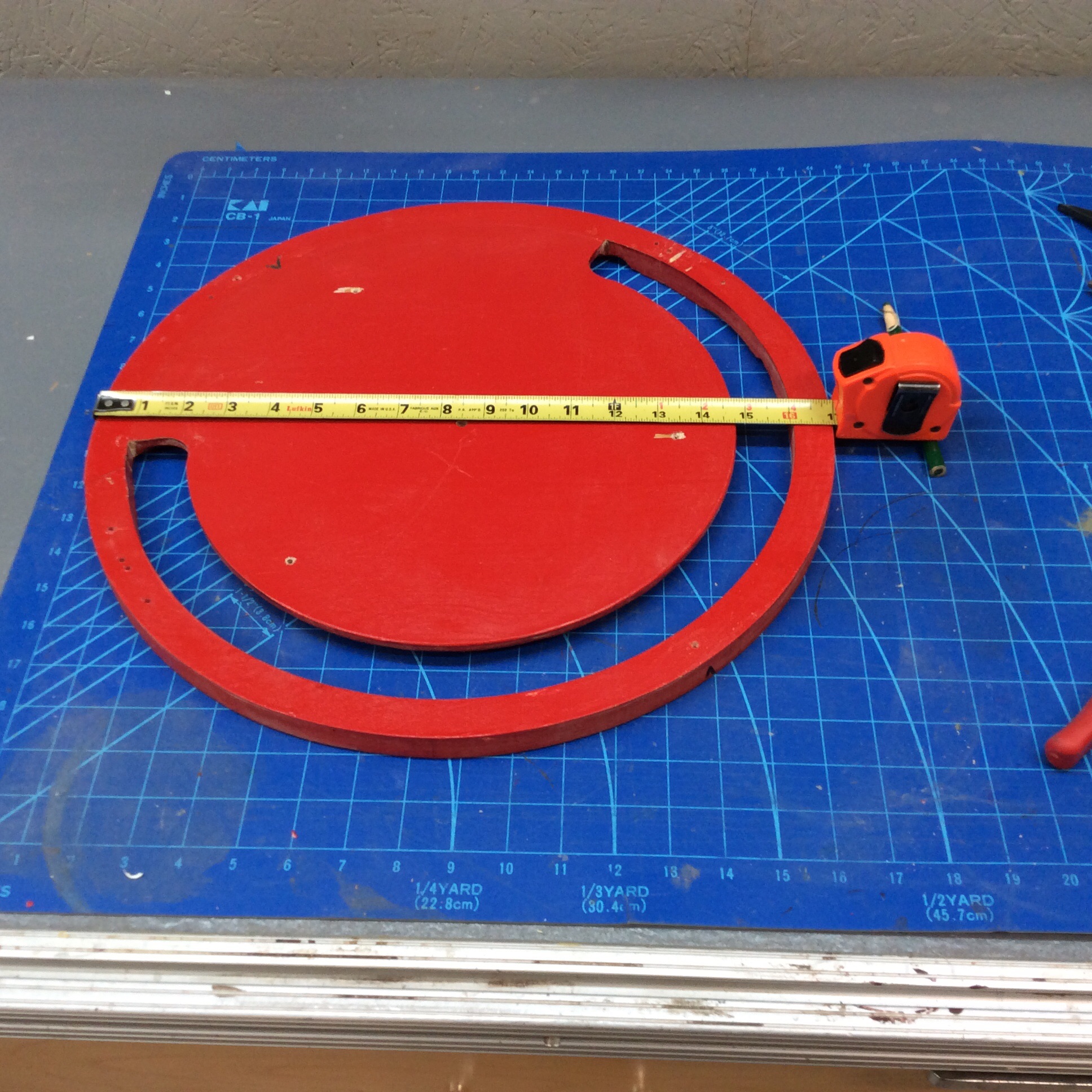

                              Jdon, my baffle slot opening is 1 1/8 to 1 1/4. I stated earlier that I noticed a lot of "reflux" being pulled from the garbage can when the machine was idiling. Today I was going to make a new baffle with a narrow opening but instead I made a sheet metal cover for the existing baffle with a louvered grill that inserts down into the opening. I force fed it 5 gallons of planer chips and none went into the plastic bag and there was no reflux when it was idiling. Then I fed it a large coffee can full of wood flour, I only notice a cloud in the plastic bag when I fed it a large amount all at once. I opened the garbage can and it had a nice late of the flour in it. The canister filter did have some in it though, but not enough to shake out, I could rub some off the pleats inside. I think this was an improvement. It is set up ready to go, I'm thru experimenting for now.
                              capncarl
                                • 3572
                                #30
                                Photo of baffle louvre mod plate
