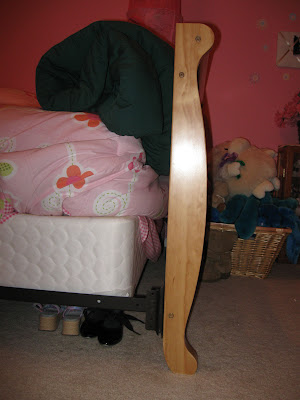

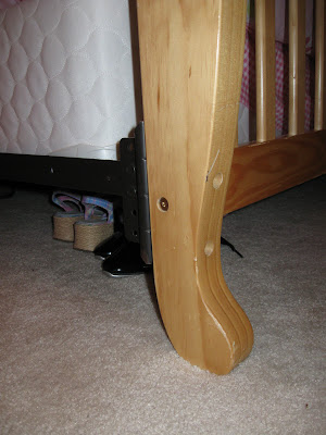

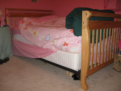

    We recently converted our old crib to a regular (full) bed. However, the bed frames that we had are too long by about 4", so stuff is always falling in between the end of the bed and the foot board.
    So, we have been looking for a shorter bed frame, but it also needs to have holes for mounting a headboard and a footboard. We're having trouble finding one that meets these specs, for a price that we're willing to pay.
    Therefore, I'm currently thinking of maybe making a wooden bed frame myself. It doesn't seem like it would be all that hard, but I wanted to post here and see if you guys had any tips/ideas/etc. for me?
    Here are some photos of the bed in it's current state:

    That looks like a metal frame. Why not just cut it shorter and rivet it together again? As I recall welding is out do to the poor quality of the material used for the angle iron.
    But.... and there is always a but
    A nice wood frame would look much better and you would be creating a heirloom piece.
      • 9548
      Build it. Even if you just used deck screws to hold together some 2x4s, you'd have a better product than most of the junk on the market these days...
        The footboard looks pretty robust. I'd consider just adding stretchers between the headboard and footboard, and run some slats between the stretchers.
        You can find all sorts of bed hardware at places like Rockler and Woodcraft for connecting stretchers to the head/footboards. The ones on my bed are mortised in, and it is about as easy as mortising a butt hinge for a door. The stretcher covers your work, so you don't even have to work if your chisel slips a little.

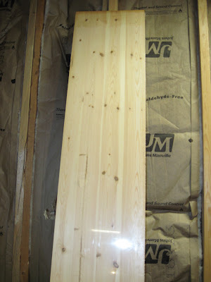

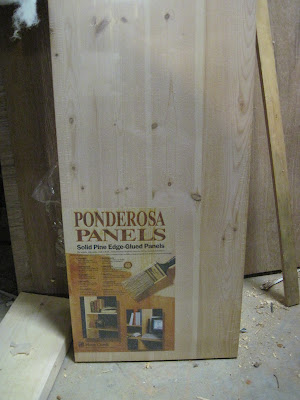

                              And, yes, I was thinking of using some 3/4" pine that I have (got it on clearance a few years ago at Lowes, and haven't had a use for it yet). Do you think that's a mistake? Should I get some 13/16" or 1" stuff?
                              I also have some 3/4" curly maple that I got a few years ago, but I don't think that would match.
