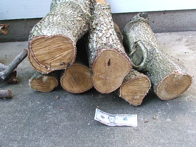

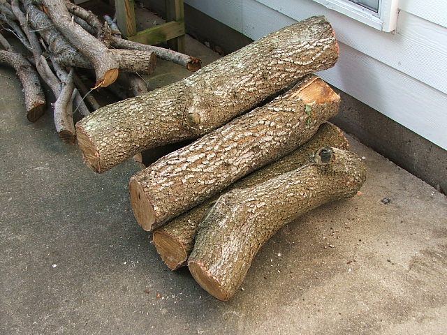

    Today I trimmed a pretty big branch off the live oak in my front yard, its about 17 years old, was planted when they built the house.
    You can see the pic below I saved a few sections that were close to 5-6" in diameter and around 2 feet long. (The $5 bill is six inches long for reference.)
    Is there any hope of making these into some 1/2" x 3" to 4" planks to make some small boxes? Or am I just dreaming.
    What do I need to do?
    rip to rough oversize (3/4"?) planks first then dry or dry and later rip to planks. I assume it will dry faster if i rip first but it may warp? If I rip to planks first how long do i need to dry?
    Do I need to seal the ends with paint to prevent end checking?
    I know to rip I need some sort of milling fixture for the bandsaw, mine has about 6" capacity.

    I believe the "rule of thumb" is 1 year per inch of thickness.
    You can use paint or parafin to seal the end and it is reportedly necessary to avoid checking. I have seen checking in pieces I cut from the firewood pile so I think the need is real.
    Everything I have read says that you need to sticker the boards and some say to weight the pile to control warping. Limb wood is more prone to warping than the trunk would be because the growth rings are different on the top versus the bottom of the limb. I would consider quarter sawing or at least something close to quarter sawn. If you split the limbs down the center and then use the resultant flat surface as a reference, what you cut off will be close to quarter sawn.
    I made a fore-stock for my side-by-side out of a crotch piece of unknown hardwood from the firewood pile. I roughed the piece with a chain-saw. I did not allow it to dry as I should have but it came out OK anyway. The grain in the crotches is very nice. Oak has less showy grain than cherry or maple but the crotches should still look nice.

      Nice fresh almost round already turning blanks!
        I am thinking turning blanks as well.

            so should i slice it first while still green and dry as planks? Take less time to dry but but will the planks stay straight?
            Take me only a year to dry, not 6 years.

              I mill alot of my own wood. Seal the ends asap. I have used lots of different things that I was told to use but after looking in the big guys yard one day I realised that my first choice was the best. PM me and I will tell you the secret. O.K.!!!! No secret. Any good enamel paint will work. I change colors every year so I know when to mill.

                I have read that if you put them in the freezer for a while, it will really speed up the drying time. Freezing explodes the cells in the wood fibers allowing the water out faster. I have some logs that I let freeze this winter, but I haven't gotten any of them sawn yet; so, I don't know if it actually works. It does sound good in theory, though. I have read that boiling them will do the same thing. Good luck.

                    Just a bit of informed guessing here but thinking that you cut them during the dormant time of year, assuming that the tree has not leafed out yet. Seal the ends quickly and then mill into lumber. Stack and sticker and let dry for one year. Quarter saw to avoid cupping. Crooking and twisting may happen no matter what you do. I think branch wood is more prone to this anyway. As the leaves form the weight of the leaves cause the branch to bend down. Once the leaves fall the branches spring back up.
                    Either way, if you are going to cut it now it might be interesting to leave one aside. Peel the bark and seal the ends and then mill it into lumber a year from now and see if the lumber is straighter. Realizing that a year is not long enough for it to dry all the way through.
