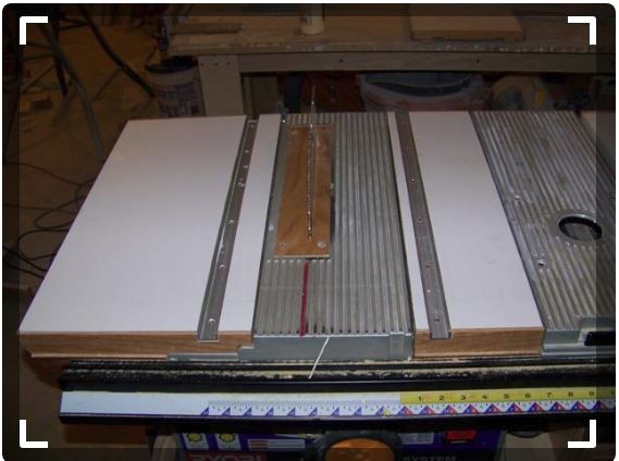

    New to this site , not sure how to get help finding parts
      • 22060
      Look in the separate forums
      • BT3x00 related discussions
      • member classifieds
      often there are posts for items, you can request items, and sometimes people post that they have entire saws available for parting out.
      Another venue is eBay with keywords BT3000 or BT3* and sometimes the name of the part you want.
      This site has a search tool, it works better if you select advanced search. which includes i think a date range (since we have for sale stuff going back 15 years), forum group,
      Also you might look at DIY miter slot tables, they are not that hard to build with prebought miter slot extrusions.
        • 8795
        Occasionally one will appear on eBay too. Some of the best ones that I have seen - have been as Loring mentioned - individuals made their own out of 3/4 plywood or 1 inch board, dado a groove to add a miter slot track. Those work great too.
        Welcome to the Sawdust zone!
          • 22060

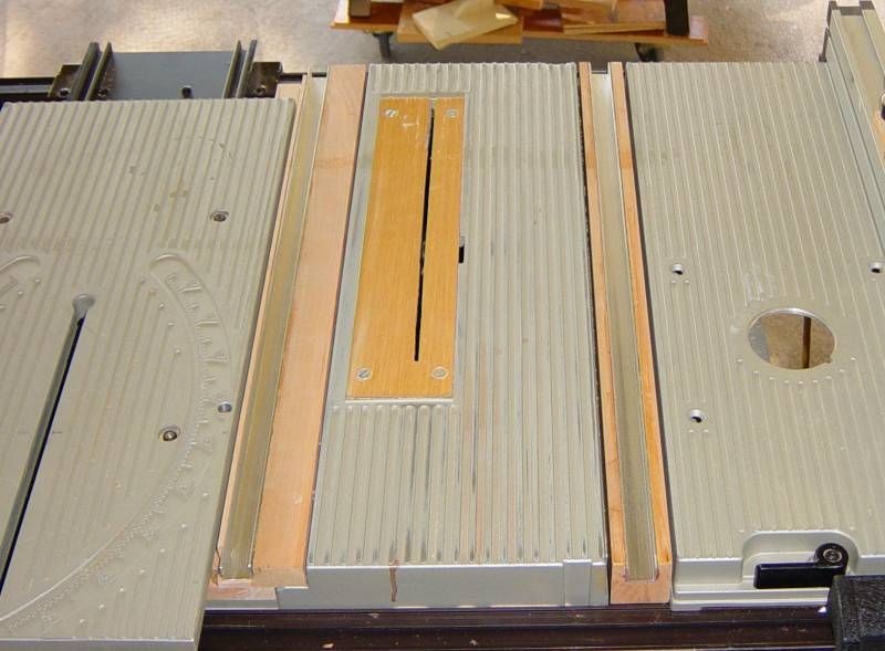

          Click image for larger version  Name:	Jim Ds extension tables with slots.JPG Views:	0 Size:	50.8 KB ID:	841395
          https://www.sawdustzone.org/articles...for-the-bt3000

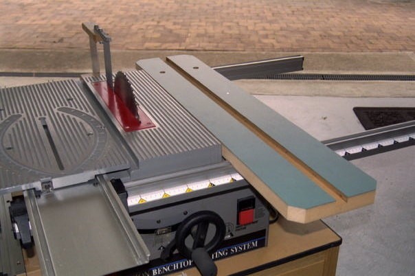

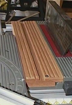

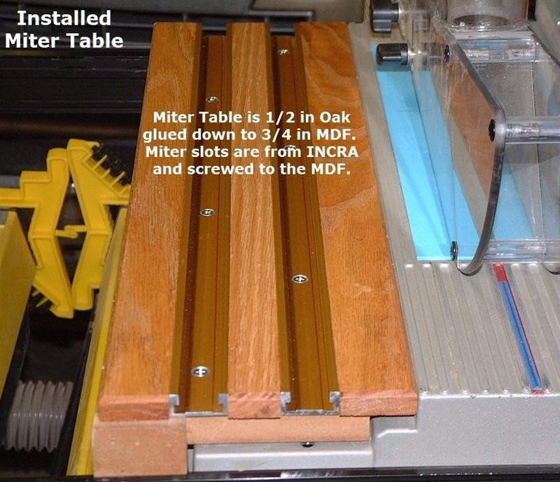

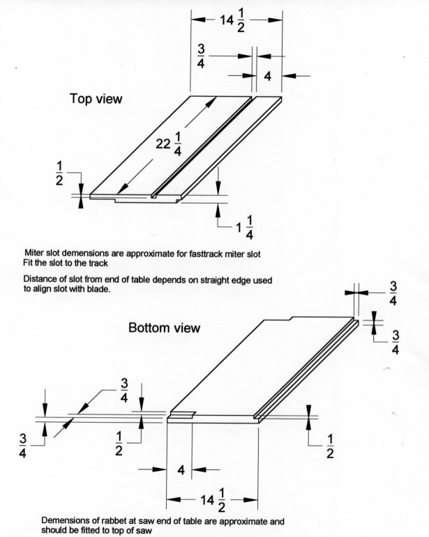

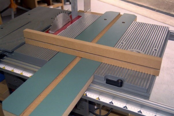

          Click image for larger version  Name:	fetch?id=834497&d=1535405519.jpg Views:	0 Size:	56.7 KB ID:	841396
          Click image for larger version  Name:	fetch?id=834508&d=1535405519.jpg Views:	0 Size:	31.7 KB ID:	841397
          https://www.sawdustzone.org/forum/di...own-miter-slot
          you should really browse the search for items matching "miter slot", I know there's more than what I found above in short order.
          This site is a treasure trove of BT3 experiences but you have to be a little patient and try different terms.
