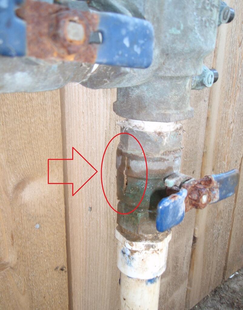

    Well, I found a hidden damage from the big Texas Freeze in February.
    Click image for larger version  Name:	split valve.jpg Views:	10 Size:	102.5 KB ID:	843920
    This ball valve brass body split from the freezing weather, Funny thing is it only leaks when the valve is being turned from off to on or back. When the ball is approx 45 degrees, it is open to both the pressure and to the crack in the side and sprays out about 6 feet. I found it when I first used the sprinkler after the storm, but since it apparently did not seem to leak when full on or full off and it was completely covered by insulation I did not dig it out until today. I drained the expensive vacuum breaker above for the freeze having lost two of them at $35 to prior freezes and insulated the whole exposed pipes and fittings. Saved the vacuum breaker but lost this valve.

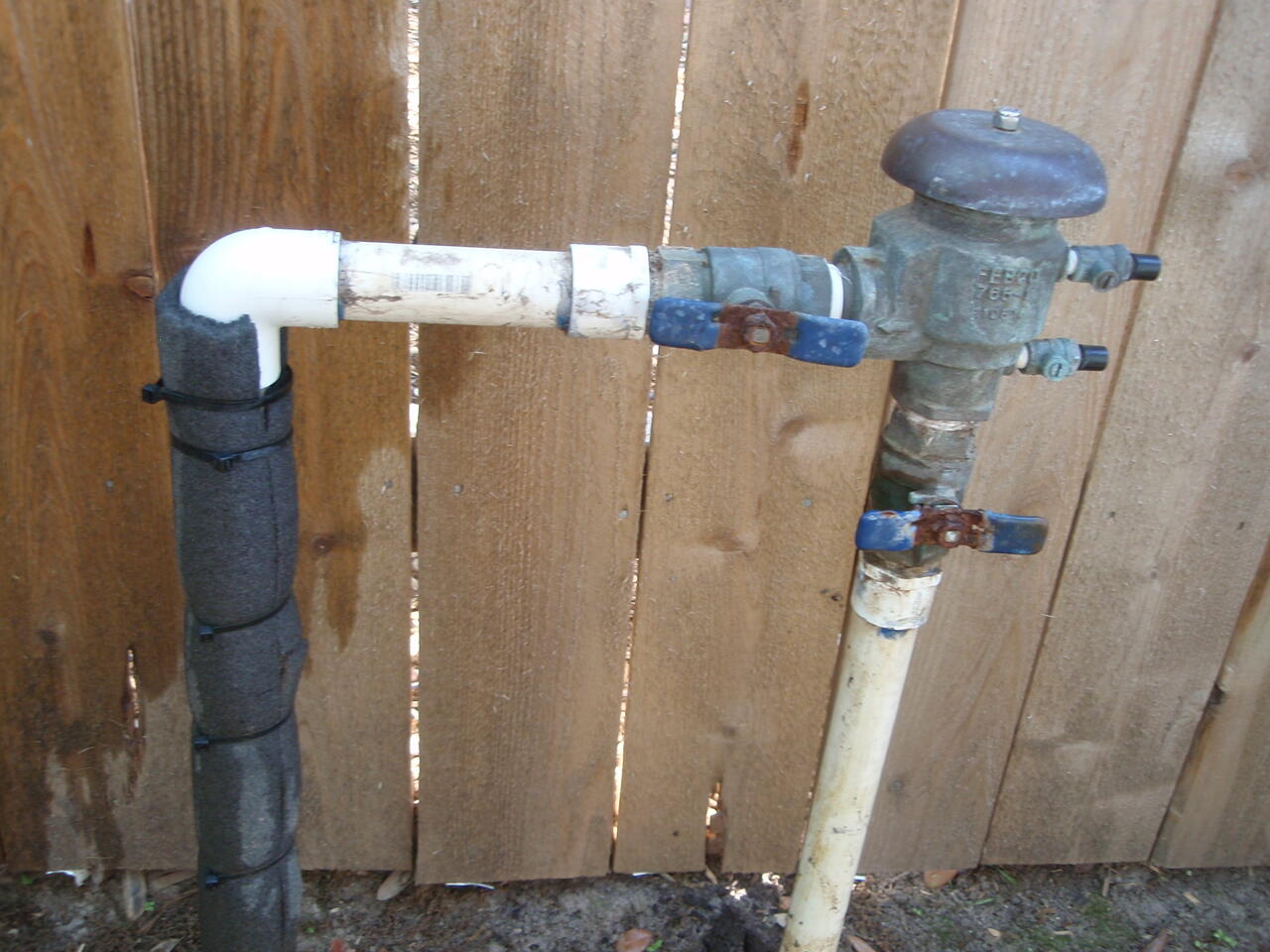

      OK how do i fix it? (the broken valve at the right running vertically)
      Click image for larger version  Name:	P4260358.JPG Views:	0 Size:	152.2 KB ID:	843932
      I think I have to cut the vertical inlet line. Then unscrew the valve from the vacuum breaker above.
      Then replace the valve and screw into the vac breaker. Make up a short length of pipe with a threaded pipe fitting and screw into the valve.
      Finally cement a F-F coupling to connect the new pipe to what's left sticking out of the ground.
      Or is it better to get a compression fitting to use the old cutoff piece and connect it back to the pipe sticking out of the ground?
      I think I've heard that compression fittings were less reliable over time but I also hate making cemented joints where you can't twist the pipe a little when joining.

        OK how do i fix it?
        Back when I lived in Arizona I installed the sprinklers with a compression fitting where it connected to the house hose spigot. Woke up one Saturday morning to board a plane and heard running water, the compression fitting had pushed off the pipe. I don't recommend compression fittings for applications exposed to water pressure.
        Your first approach seems best. If you don't like making the cement joint, you could install a union so that you are tightening a nut to make the seal.
