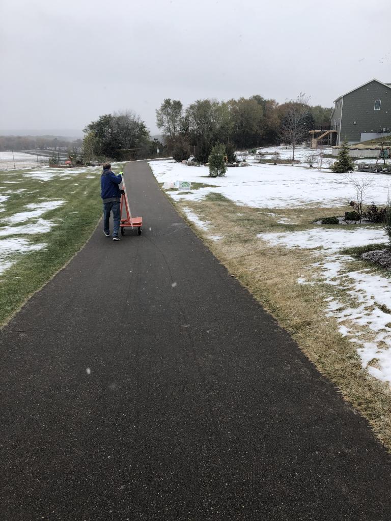

    I can certainly lift and carry a 105 pound 12 foot sheet of drywall. Can I carry it around the house to the basement and lift it onto a drywall lift and then repeat 28 times and still walk the next morning? No. With a little planning I got the ceiling nearly done with very little lifting of drywall

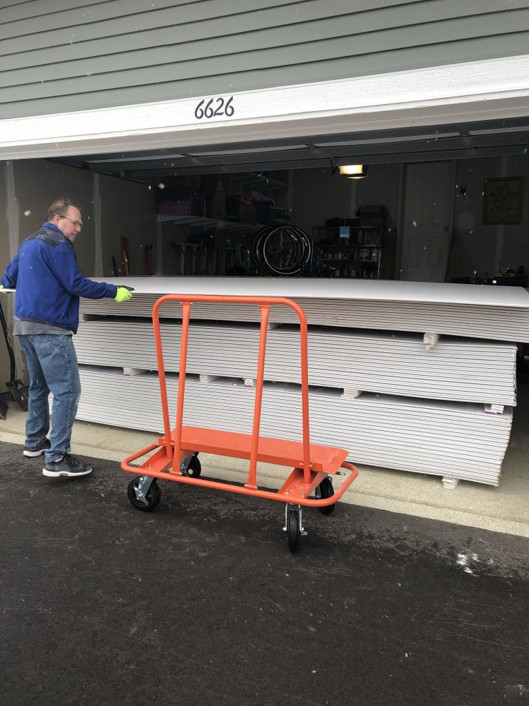

    Step 1 Slide a single sheet of drywall off the stack
    Sliding Drywall off the top of the stack

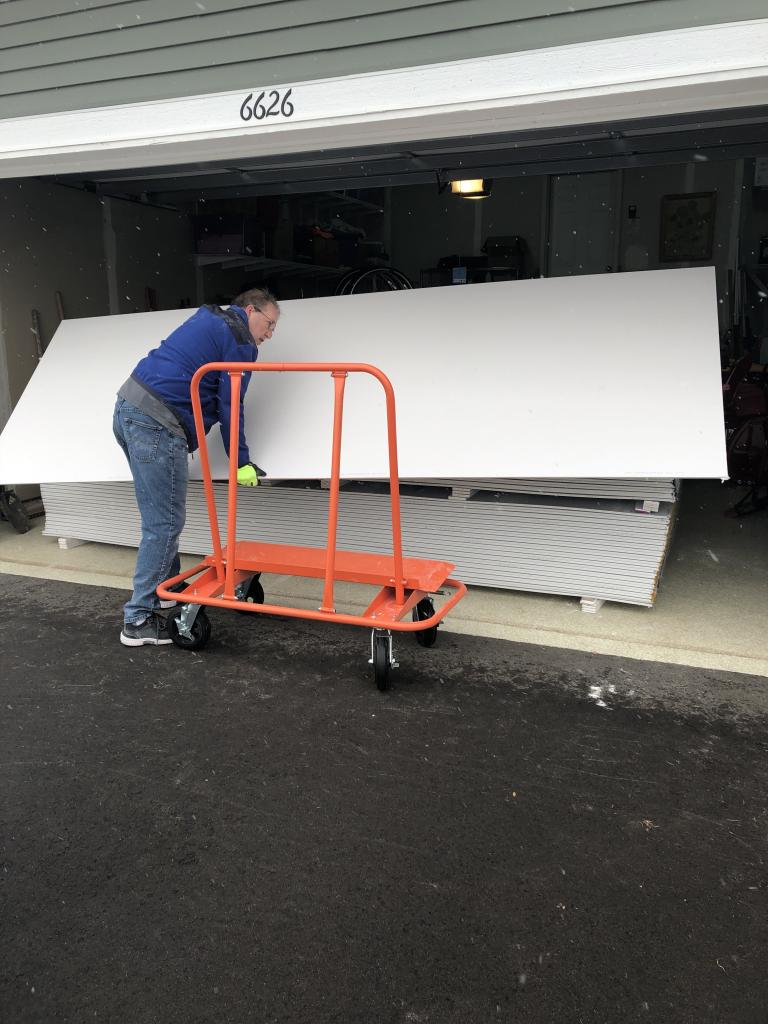

    Step 2 Lower it slowly to the cart using friction as a helper and then stand it up on the cart.
    Lower drywall to the cart
    Step Three, roll it to the basement on the bicycle trail that goes behind the house. Don't mind me, just taking the drywall on a walk in the snow. We bought this lot in part because of the paved trail to the back yard.
    Walking the drywall

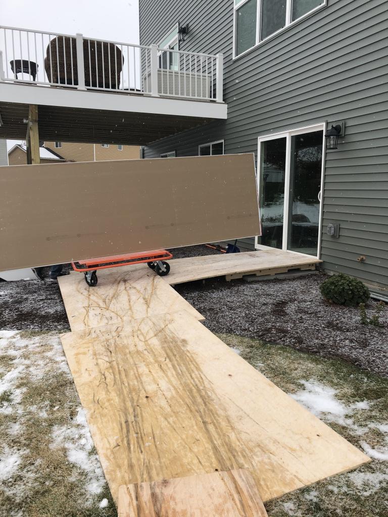

    Step 4 Roll it into the basement on the ramp built from a pallet, piles of excess mulch, and three of the six sheets of cabinet grade plywood that the movers ruined when they used them to roll dollies through the mud when we moved in. They neatly stacked the OSB in the basement
    Shoddy ramp construction

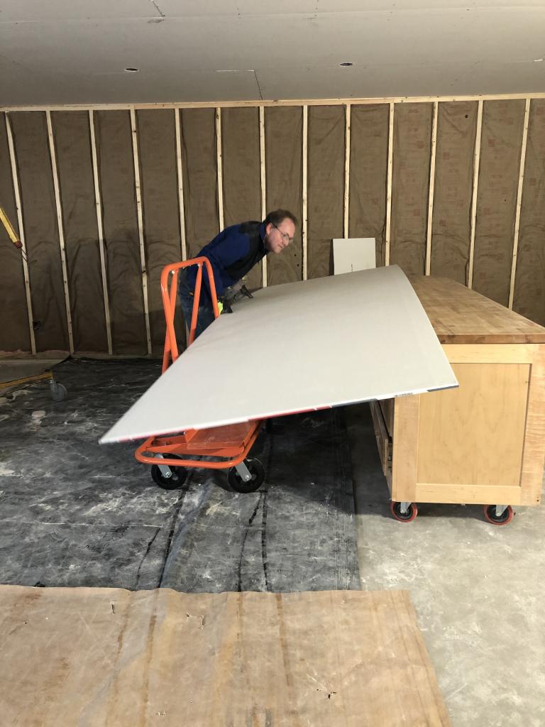

    Step 5 Tilt the drywall off the cart and onto my workbench
    Some lifting required.

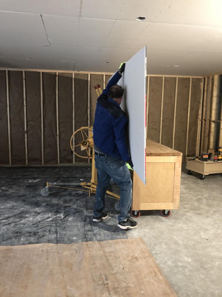

    Step 6 After positioning the drywall lift and setting the brake, stand the drywall up on its edge on the bench.
    Stand it up

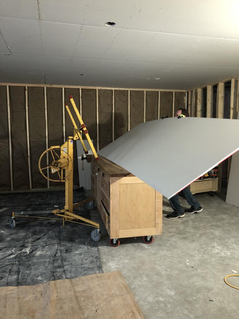

    Step 7 Finally I just need to lift each end a few inches to put the edge onto the hooks on the drywall lift.Put it on the lift.

    Those lifts are most certainly worth their money! They allow old men to do what previously was reserved for young men and middle aged idiots. And 12 feet at that!
