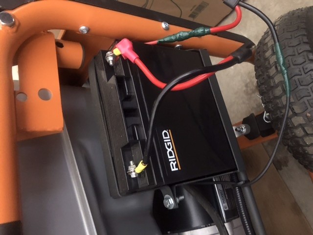

        The battery on my Ridgid generator is 4 years old and still going strong. It is a sealed battery, It is a small battery but it cranks the 10hp Yamaha engine on the generator like it was mad at it, I presume it is an AGM battery It stays parked in the house garage near the 2 lawnmowers and every couple of weeks I hook up the small battery tender to each battery. At the time I got the generator I didn’t plan on replacing the battery with the same kind, probably the cheapest lawn mower battery Walmart offers, but seeing how long it has lasted I may consider exact replacement since these sealed batteries are used in jet skis, motorcycles and other recreational vehicles.... and some actually cost less than the common lawn mower battery. I believe the secret to a long life on an unused battery is keeping a battery tender with a slow & low recharge. When I was houseboating everyone used a small solar panel charger, like HF sells, and the batteries lasted many years.
