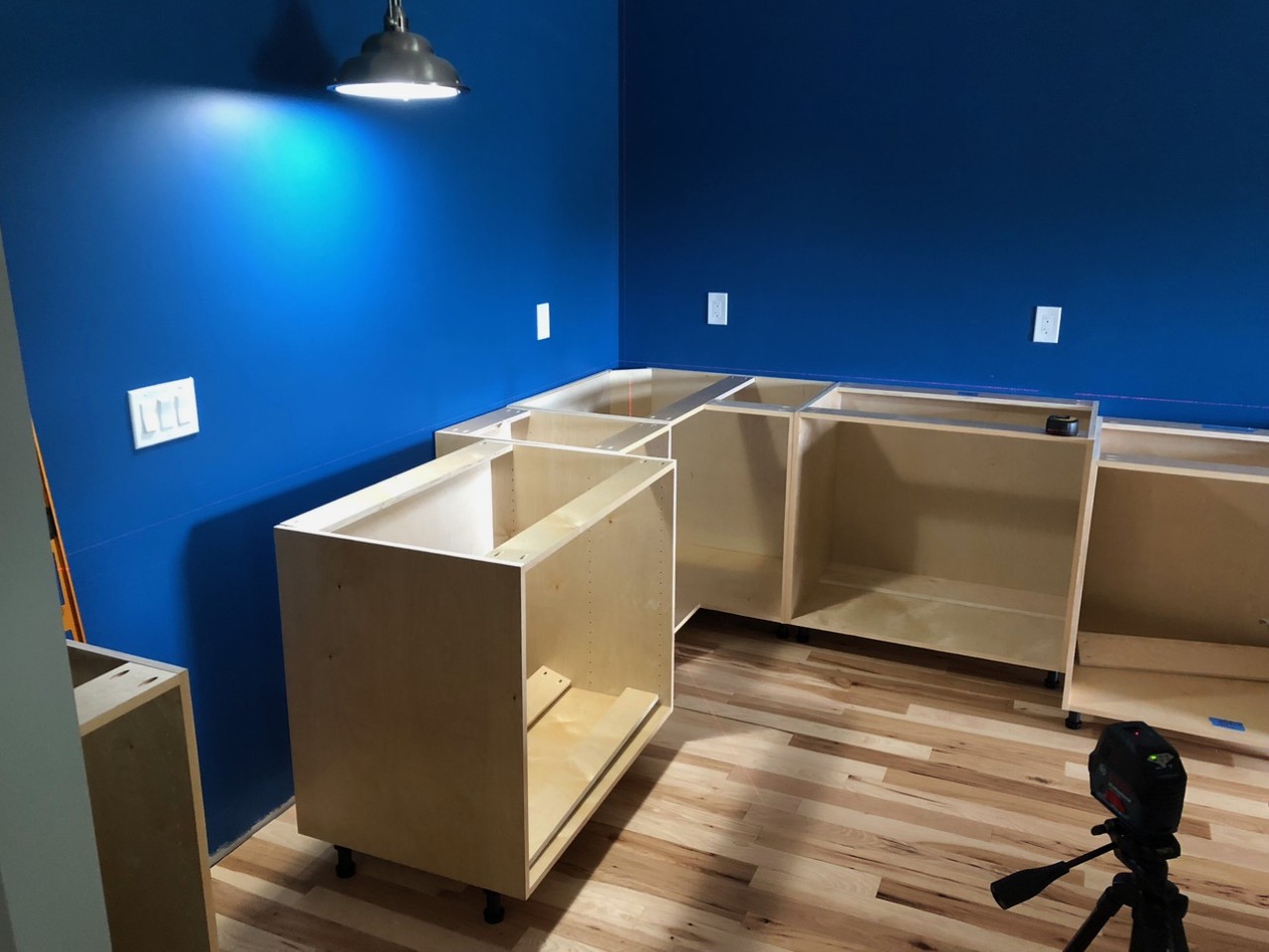

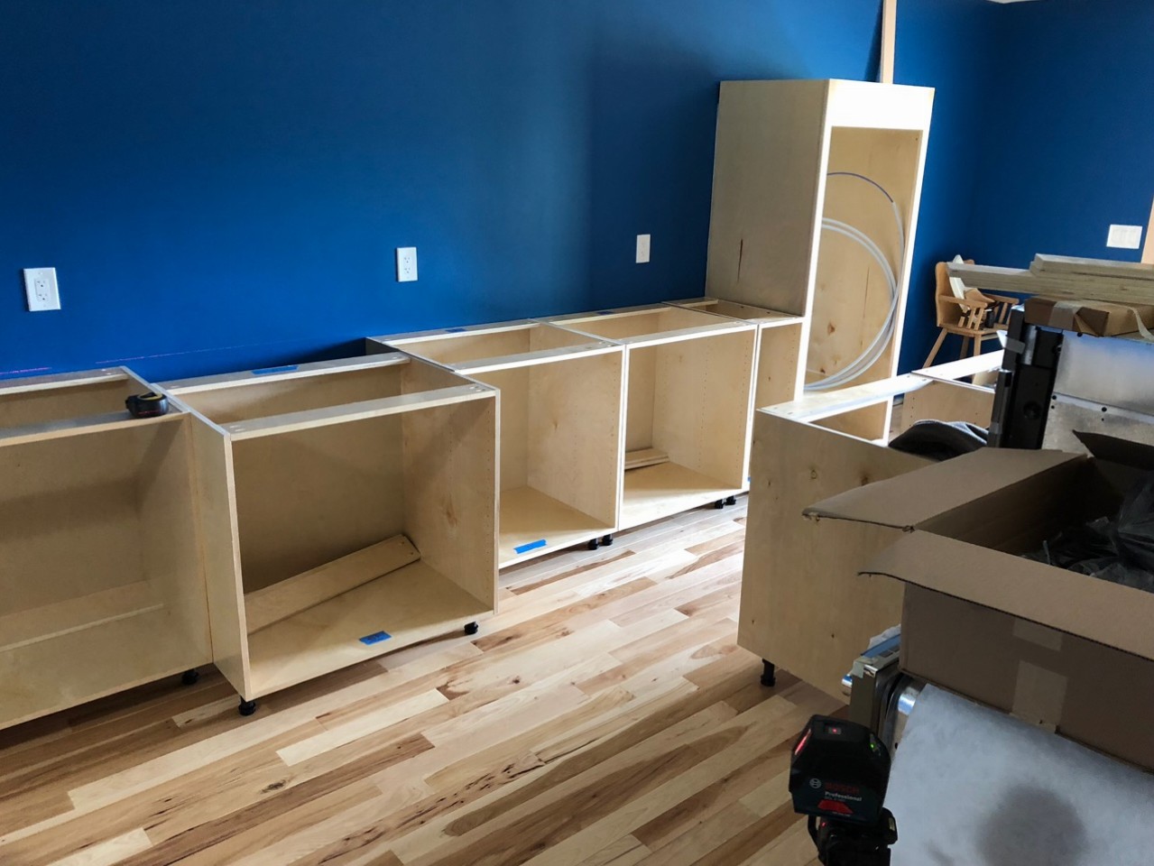

    We are rapidly approaching 2 years with a temporary kitchen in the basement laundry room in our house. Since last summer, shop time has been limited by triple hernia surgery, two bouts of pneumonia, and a blown out knee. Three full days in the shop over memorial day weekend and I finally have something to show for it.
    If I can get these installed this weekend, we can get counters ordered and have a functional but incomplete kitchen by Independence day. Right now we have a toaster oven, microwave, and a sink with 14" of counter space. There's a refrigerator in the garage a few feet away. The two that are away from the wall are the once where I need to cut holes for plumbing and the gas line for the cooktop.
    Long wall of cabinets with Wall Oven setup
    Short wall of kitchen cabinets

    Do you use the plinth legs often? I used them for a couple of cabinets in the kitchen of my previous home. I liked them well enough, I just haven't seen them used very often.
      • 3126
      This is the first time I've ever used them. The floor of this house is out of level enough that shimming traditional cabinets to get everything level would have been a royal pain. The legs have an adjustment range of 50mm or nearly 2" so I'm hoping that will make leveling the cabinets much easier.
      Some background. When my dad and I built the house in 1978, the engineer that designed the trusses wasn't an engineer at all and forged his credentials when he was hired at the truss company ... now long out of business. The company came and raised and braced them back then because they sagged almost immediately, but they've sagged about 3/4 inch over a 28' span in the 40 years since. It isn't really noticible to most people. The floor truss at the back of the cabinets on the long wall is sitting on the foundation wall so it is straight and the next truss 2' away from the wall has the full sag. In the middle of the wall the floor is 3/4 lower at the front of the cabinet than at the back. Just part of the joy of remodeling old houses.

          How do you attach a toe kick onto those legs?

            For attaching the toe kicks, there are little c shaped plastic clips that have a flange. The flange is screwed to the wooden toe-kick, the c-side clips to the plinth legs.

              I got all of them installed late last night. and I have to say leveling cabinets with the legs on them was a breeze. Mrs and I have a date to order counters and a sink and Interstate Building Supply Saturday morning.
              Now I just need to build uppers, doors and drawers.
