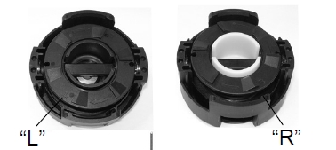

    Interesting--I just bought this about 5 days ago for an Echo trimmer and to be blunt, it has sucked. For some reason, it won't advance the line---in fact, when I "bump" it, it shears the line off at the feed holes and I have to remove the long line and start the winding process over. What's interesting is if I push the head manually and pull the line, it comes out fine.
    Mine is going back this weekend when I have time.

        Take a look at the spool on the inside. I think it must be installed correctly or it will not advance the line based on how your trimmer rotates. Flip it over and see if it corrects the problem.
        http://www.echo-usa.com/getattachmen...3-0dd32dff865f
        "Reassemble trimmer head in reverse order of disassembly. Make sure “L” mark is facing away from bushing when replacing spool fir LH units. Make sure “R” mark is facing away from bushing for RH units. Trimmer head halves will snap together tightly only if parts are properly assembled."
