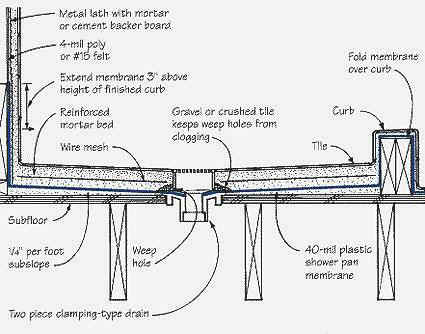

            I differ with the above posts. It might be "typical in the south" but a proper shower installation involves a pan mid-way through the concrete base sloped towards the drain. The drain should have weep holes immediately below the pan elevation to collect the water. The pan could be galvanized steel but it will fail. Copper is far better. Today plastic is used. I would not do this in your case but properly done, it will not result in the issue you have.

                  I've done several mud pans, and have had no issues. There are a lot of different techniques, but the key is in any case the waterproofing that's done. If you do a cement pan properly sloped with a good waterproofing, like Schluter's Kerdi system, or the Homelux stuff that Menards sells, or a roll-on solution like Aquadefense, you'll have a completely watertight system that will ensure no leaks. I do a combination of both- Homelux on the pan and for the walls I do Aquadefense that ties into both the walls and the floor. After that, you have a continuous membrane that will never leak.

                    I am not familar with the specific systems you cite but I will admit I left off the more modern systems involving a pan of some sort (some are foam, I believe) covered by a water proof membrane that is tied to the wall membrane to form a continuous seal to prevent water from going anywhere but down the drain. I have seen them recommended in Fine Homebuilding by experienced professionals so I think they probably work fine.
                        Not only typical and "proper" but apparently code for a long time, not sure if it is still allowed or not. To understand it better, the sub slope was built into the mortar layer, with the tar paper being the "membrane". The drain still had the tar paper coming over it to properly drain the mud work. I hope that clears it up. It's essentially the same as current pans, just in two layers. Mind you this is for slab on grade properties, on wood framed subfloor it is different as those tend to be on second floors in these woods. ;-)

                          I guess to function properly I think a pan should not disappear. While galvanized steel was used it does not pass that test so I think it should not be used. I feel the same about tar paper. It might work for awhile but you know eventually it will go away (at the critical interface to the drain where galvanized fails). We all know concrete is porus so while the slope will get rid of most of the water you have to allow for what penetrates due either to porosity or small cracks. That is the purpose of the pan. If you install a pan that will disappear, you are basically guaranteeing a leak at some point. I would not do that.

                            Here's the old school pan technique. There's your subfloor, then a pre slope layer, on top of which the rubber membrane is installed, then another layer of mud (usually a cement/ sand mixture), and finally tile.
                            The last two pans I made were using a product called Quick Pitch, Homelux waterproofing membrane (it's a Schluter like product that's more like a stiff fabric than a rubber sheet), and a pre-formed flashing by a company called Noble. The website for Quick Pitch has videos on how to do this method.
                            But even with the classic pre slope, membrane, final slope method, I've found that quick pitch really works well for DIY. Home Depot sells the product online, and there are various kits that include the Pre Pitch, Quick Pitch, and Kirb Perfect system. So you can get everything you need except the mud (rubber memberane and drain included) in one package. Not a bad way to go. Though again, I prefer using the waterproofing on top of the pan, so no water even gets to the mud that makes up the pan.
