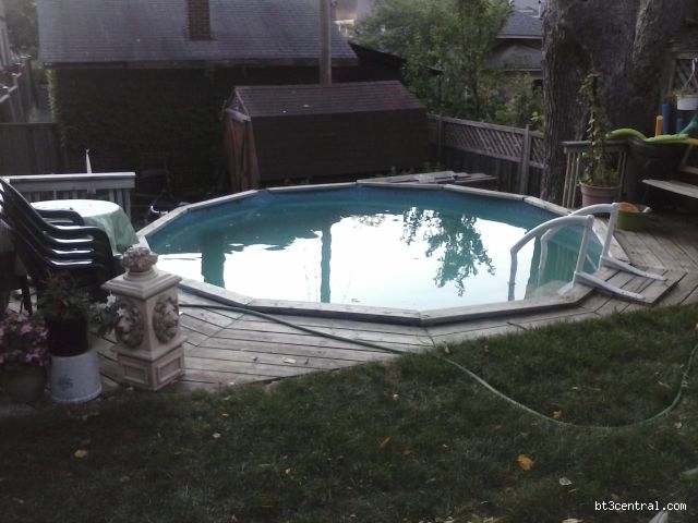

        With about 4' of legs under the deck, I don't to chance the bracing not being strong enough. With the 2 2x10 beams bolted into dados on both long sides, I think corner braces will be more than enough.
        My concern is making sure the ends are stable. I could add a pair of lag bolts through the 2x8 joists at each post along with construction adhesive, but I'm not sure that is going to be enough. Has anyone done a high freestanding deck like this? How did you brace it? Like I said earlier, the end away from the steps will have a plywood storage cabinet installed that could be secured to both the legs and the end joist.

              Don, when we have high platforms for wheelchair ramps (think mobile homes - the doors are at least 36-40 inches off the ground) we put diagonal cross braces between the legs. Triangles are nice sturdy shapes.
