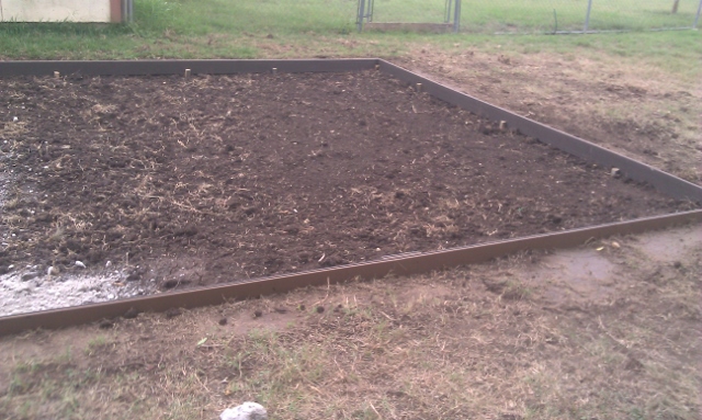

    My main 'vacation' project is to put in an above ground pool. The hardest part was prepping the area for a good 'pad' to set it on.
    The area was dug out with a backhoe/front end loader.
Name:	2 (640x383).jpg

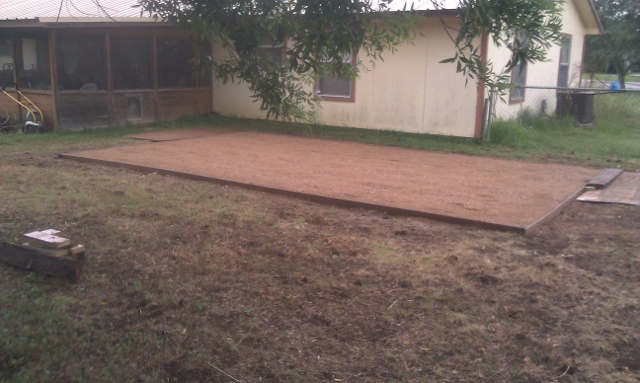

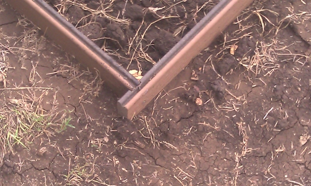

    After building a border from Trex decking I scored at 1/2 price the area was back filed and leveled with dirt, soaked down and allowed to dry overnight.
Name:	4 (640x383).jpg

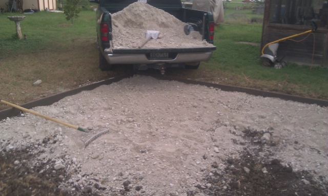

    To save $$$ the area was back filed with free recycled concrete slag to about 3" deep.
Name:	7 (640x383).jpg

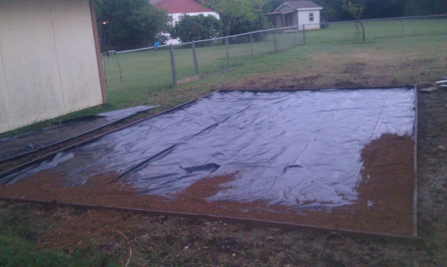

    I put down 2 layers of 6 mil plastic and was able to get some decomposed granite around the edges and along the seam to hold it in place before some evening rain hit.
Name:	IMAG0454 (640x383).jpg

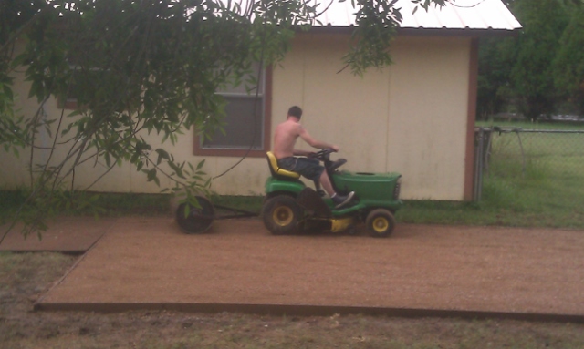

    After filing the forms with about 3 1/2 yards the decomposed granite it was packed down with a water filled drum roller.
Name:	IMAG0456 (640x383).jpg

    That looks like a whole lott'a WORK! Impressive site prep.

      I say this with all respect do: Pappy, you are too old to be doing that much site work!! Is this your third in a year? Clearing, forming and in this case just short of pouring You are one hard working guy, kudos!

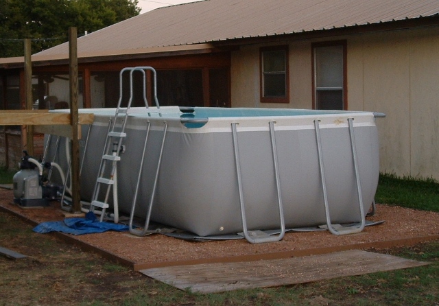

                    I got the pool up, filled, and the salt and acid added last week while I was on vacation. The filter/pump is set up to run every morning from 6-9 AM.
                    The water temp is up to 80 degrees and I took the first swim this weekend to cool down when I was cutting parts for the deck.
                    Gonna be nice to come home to after a day in an un air conditioned mail truck!

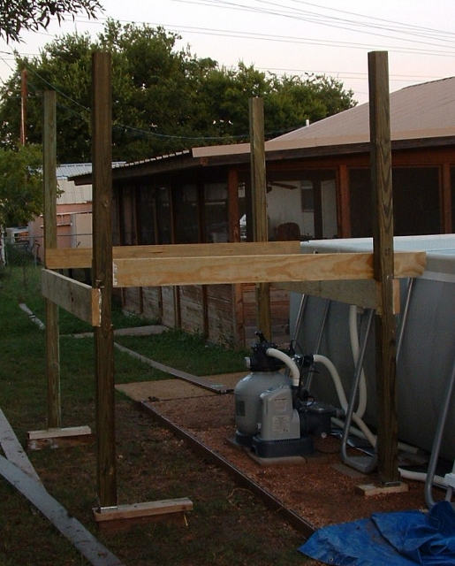

                    We had some rain this weekend that slowed me down but I got a good start on the deck. Except for the braces and rounding over the ends of the deck boards, all the parts and ready to go. I got one beam installed on each side of the legs and the 2 end joists installed so I could set it in place determine the location of the footings and piers. Three of the beams are set into 1/2" deep dados which makes it solid end to end. The outside beam is set 3/4" deep so a facia board will be flush to it. The braces on the ends will be added before I try to move it. Next is to pour the footings and bolt it down so I can measure for and cut the stair stringers.
                      Added the last part on an edit and couldn't add another picture.
Name:	Deck Frame.jpg

                          I might have poured the footings first, but you're probably better at getting them level than I am.
                          FWIW, the documentation I've seen always says that a "patio" is not a sufficient footing.
                          I like the beams set into dadoes. Theoretically knee braces might be in order to mitigate racking, but the dadoes should help in that regard. Are you planning to run bolts through the beam and post connections?
                            Originally posted by JR
                            Looking good, Don!
                            I would like to have poured the footings first, but it is kind of 'design on the fly'. Original idea was 5'x8' but after laying out the deck boards I added 2 more to, taking it to 6'-5" wide. With the frame in place and the inside deck board clamped on I was able to get a locate on the inside footings. I'll pour them first and then measure to get the location of the outside footings.
                            The beams are set for now with Loctite construction adhesive and 4 screws each. I have some galvanized carriage bolts on hand and will probably use 2 per joint when I add the other beams.
                            Cross braces will be permanent on the stair end (closest to the porch). The other end will get temporary corner braces to hold it rigid until it is bolted to the footings. They will be replaced with a plywood storage cabinet for chemicals after it is in place.
