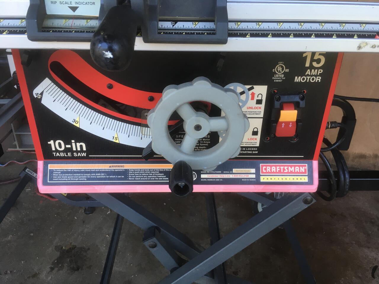

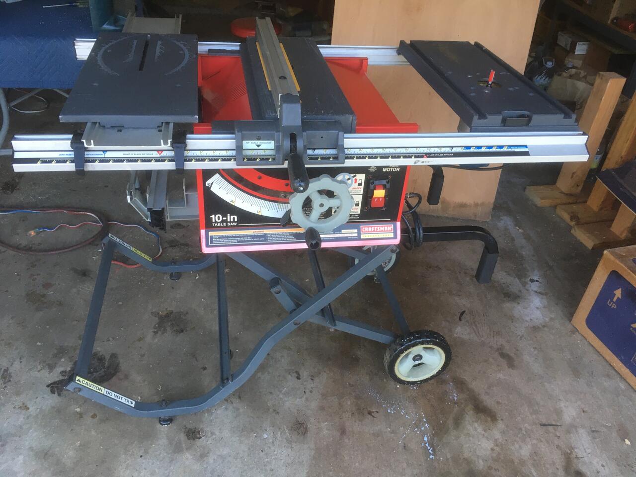

    Just got the Craftsman Professional 315.218290
    And I followed the review from from 2008 on the lumberjocks forum to this forum here (a post mentioned this). I just got the unit in the garage, it can use a proper cleaning, but I'm looking forward to having it.
    Apparently the Ryobi BT3100 and the craftsman are very similar. I got this for exactly the reason the guy in the review describes: have a two car garage that I also use to put cars into, and otherwise have limited space; Additionally I need the router table bit. I have the bosch router table right now (the plastic one), and it didn't work for my purposes which frankly infuriated me. The insert didn't sit flush properly, the piece I was using snagged and wobbled as I pushed it over it. This made me so angry, I will sell it immediately.
    The Hitachi table saw is excellent, but I think this has a higher rip capacity.

      Also: pics posted b/c everyone likes pictures!

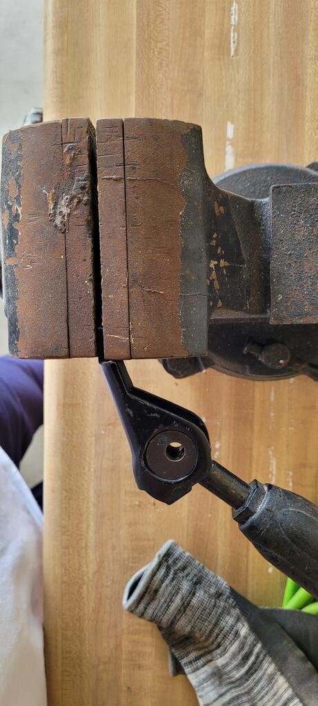

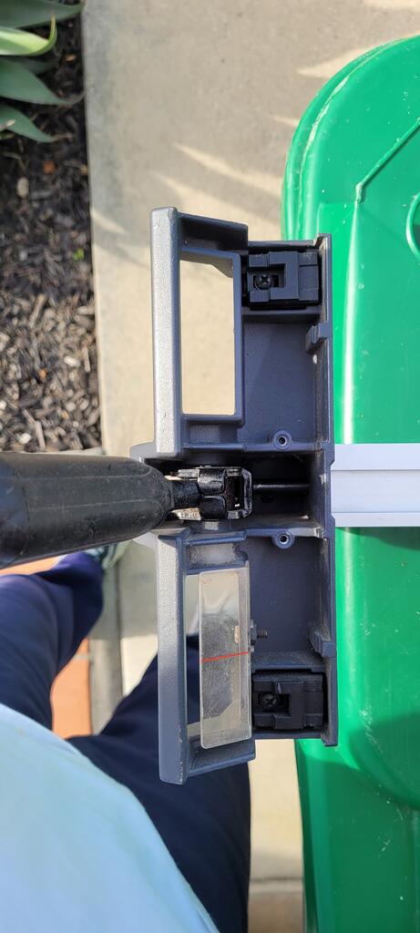

              Fried Chicken - I just purchased this saw from a Craiglist private party who was moving. When I got home I found the rip fence would not tighten down on the rails. I downloaded the manual and have taken it apart and put it back together on
              both ends. It doesn't seem to be pushing the rod when I pull the handle down like it should. Any thoughts or suggestions you might have would be greatly appreciated! I uploaded a video to Youtube but it would not allow me to link it from here.

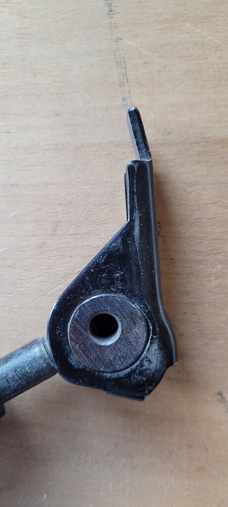

                A common issue on the rip fence is the metal ear on the handle cam (called "Clamper A" in parts diagrams) being bent backwards. This ear is what pushes on the internal rod as the handle is lowered... somebody gorilla-ing the handle, pushing it down way too hard/too far, bends the lever. The normal handle position is pretty much horizontal when the fence is locked; if the handle needs to be pushed down well past horizontal odds are the ear is bent.
                Look at the latter posts (6, 7, and 8) in this thread: bent Clamper A discussion
                The pics show a replacement part with a small bend in the ear; some BT3 owners have Clamper A parts with even less of a kink. Read twistsol's reply in that thread for details on how the rip fence locking sequence should operate. It is part #19 in the parts diagram attached to post #6.
                If that isn't your issue, post a picture of your rip fence innards - the mechanism in the underside of the black cast section. We'll look to see if anything appears to be missing or incorrectly assembled.

                  mpc - thanks for your help. I spent some quality time with the fence. Read thru the comments and took the **** thing apart and put it back together 3 times. I got it working finally. I bent the tab in on Clamper A with a bench vice. It probably didn't need it but that was the first thing I did. After the many times of taking it apart I realized that I was putting the plastic plate (plate not shown in photo) that covers Clamper A on backwards and also that this rip fence clamps "up" to the locked position. That seems backward to me but that is how it locks.

                      What do you mean by "that this rip fence clamps "up" to the locked position" ?? When unlocked, the handle should be pointing almost straight-up as Superbowlen's picture shows. To lock the fence in position you push it down to roughly a horizontal position. Your first two pictures show the handle in a normal "fence locked" handle position. Folks that don't understand the nuances of the BT3 fence system - and thus have not adjusted it properly - will push the handle down past horizontal... sometimes so much that the handle end points towards the floor. That's what bends the Clamper part.
                      At the far end of the fence (the outfeed end of the saw) is a small mechanism with a finger that is supposed to latch onto the rear fence rail. At the top of that mechanism is a screw that adjusts some of the freeplay in the fench mechanism. The finger should slip past, and then under, the top part of the aluminum rear fence rail. As you push the fence knob down, the mechanism inside the fence squares the fence to the front rail, grabbing it a bit, then once that end is tight the Clamper part pushes on the long rod to make this finger latch onto the rear rail. A little more downward motion on the handle fully tightens the fence. So the front part of the fence - the stuff in the black housing by the handle - grabs the front rail and assures the fence is parallel to the saw blade. Then the rear finger clamps onto the rail to make the fence very stiff laterally and to keep the far/outfeed end from lifting especially if you have fingerboards or other hold-down gizmos attached to the fence. Many other table saws lack any sort of clamp/latch at the outfeed end of the fence - the BT3 fence is superior in this respect. It also makes the fence far more rigid when using it with the router table.

                          I had a problem with "clamper A" as well. Mine was bent just like the photo in this thread. I had a tough time getting the roller pin out to take the assembly apart. I later discovered that the handle had to unscrew from the assembly because it was locking the pin in place and was preventing me from punching it out.
