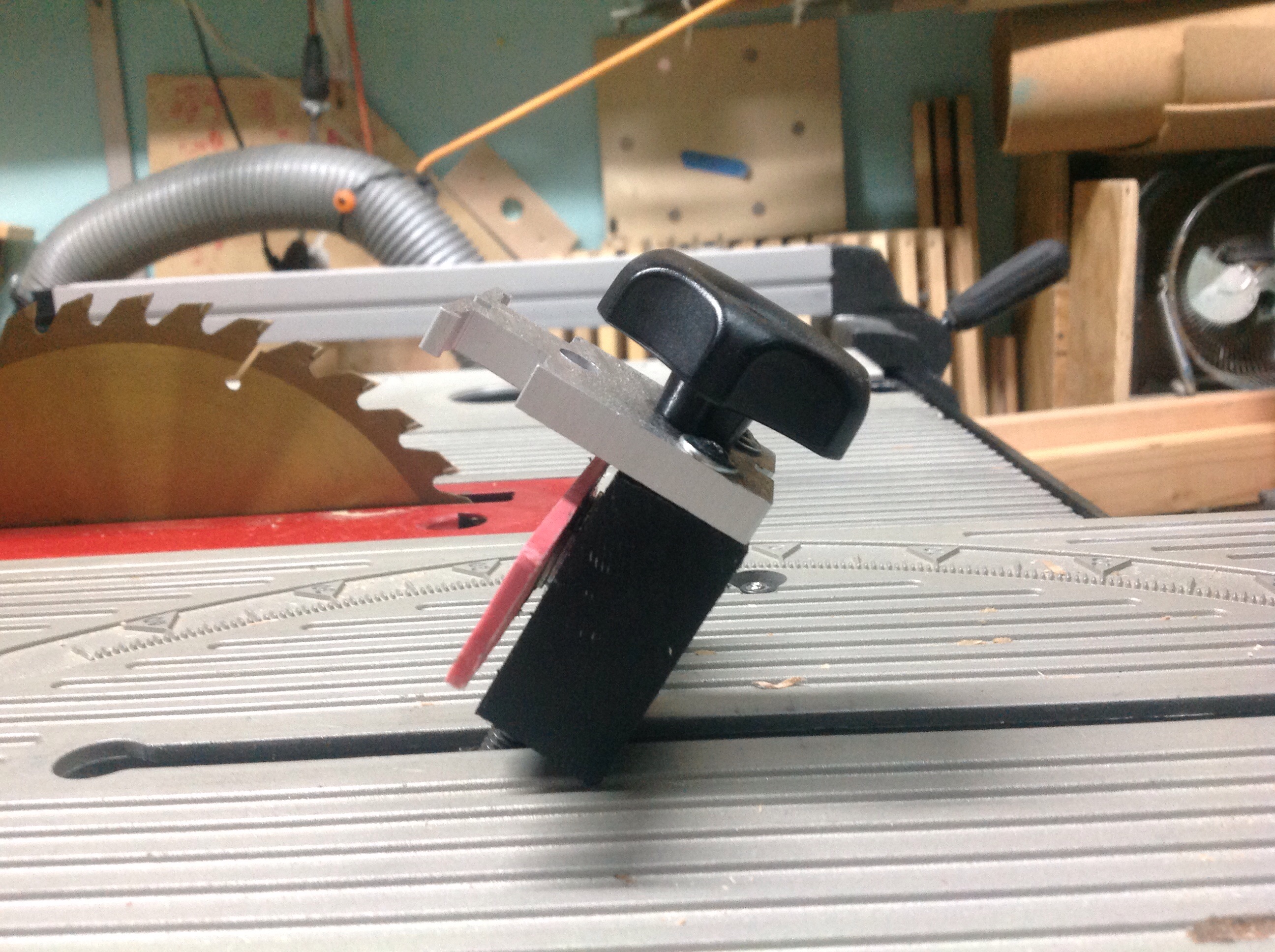

                Thanks for all the detailed responses I didn't get to read the post till after it's been purchased, commandeered, set up, tuned up, and used. I have to say I did pay up at 175, call me a loon. ( figured it into the job I start Monday)
                I thought Home Depot/Lowe's/Sears base models are still going to run you about 140 for a plastic box that does not have rails and all the capabilities this saw has.
                This was a homeowners saw, used a few times 👉brand-new👈 collecting dust. The tabletop was hardly scratched so I ran it, bought it, took it home.
                I cleaned off the cobwebs, lubed the guides and tracks, dropped a square on the fence and the slider and everything was spot on. So far I'm pretty impressed with this little unit, just comparing it to long dead and buried son ZRRTS10 and his brother RTS20 who's in Nicaragua but that's another story! I'm presently married and living with their Mom the "cave woman" Grizzly 715P. Believe me once she moved in, she's hard to move at all!

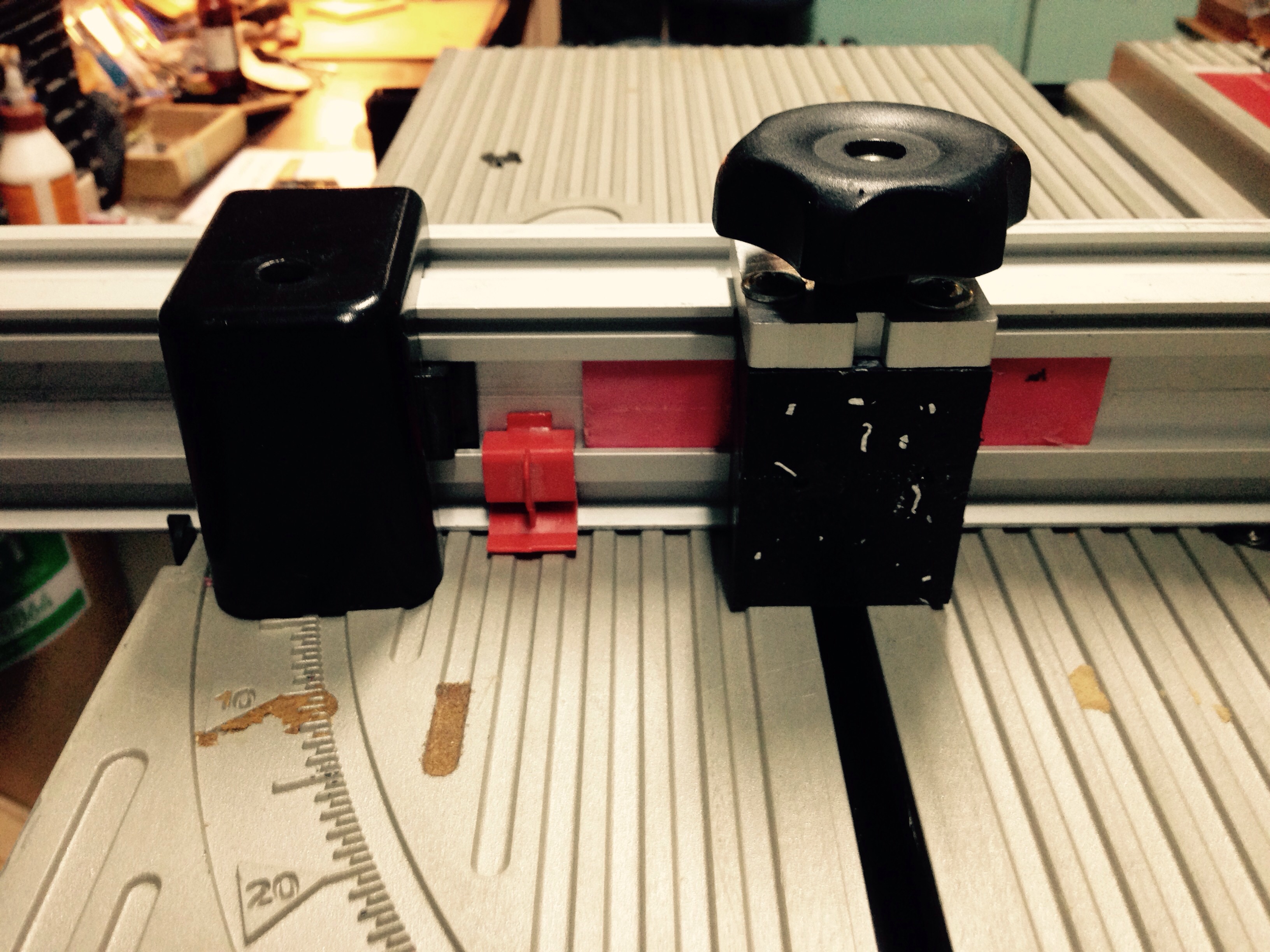

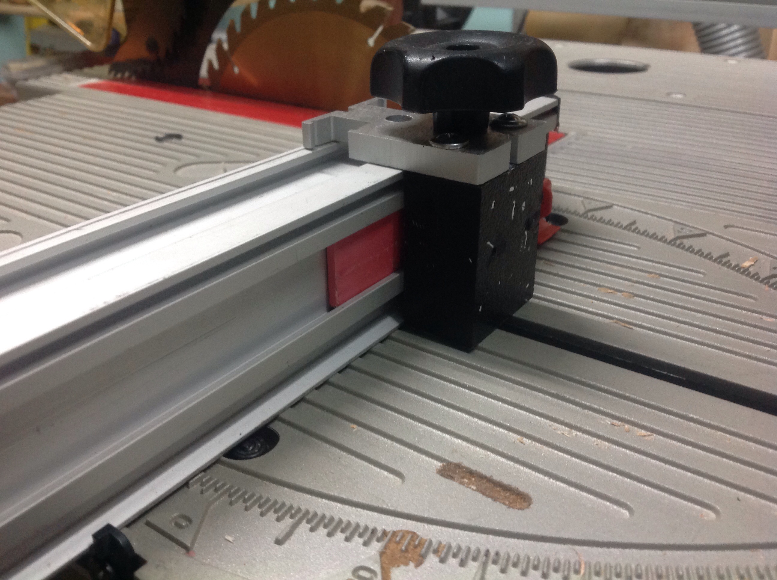

                Anyway, I broke the plastic miter fence lock down when I closed the rear door the SUV, so I made a new beefy one. The fence has slots so I'll make some hold downs who knows when.
                So when I was done fiddling, I cut a piece of true 2"x4" red oak reclaimed from skids, not bad!
                As far as job sites, I'll be moving, setting up, and using it so it's not going to take abuse I see on commercial job sites where I earn my living.
                This seems perfect for mid to high residential restoration work to small commercial Jobs that require woodworking. If I rip even 25 or less 2x's per day, it would be occasionally.
                This coffee shop job calls for using reclaimed skid material so I figure 2x rips, 1/8" Masonite, 1/2" pine or oak slats cross cuts... that's Nothing!
                I read all of your considerate responses and as prescribed, I'll put on the white gloves and treat it like a Stradivarius 👌.
                It may be newlywed fever but I'm feeling this saw, and I can put it under my arm and walk a flight or two.
                I hope to get years of use producing quality finishes.
                Thanks again for the feed back. I look forward to dropping in to see how some pimp out your rides😉. I'll post some pictures when I can . Glad to be here and now a member of the club...

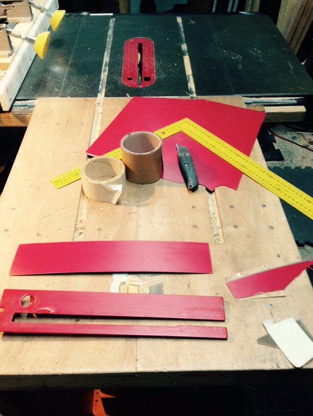

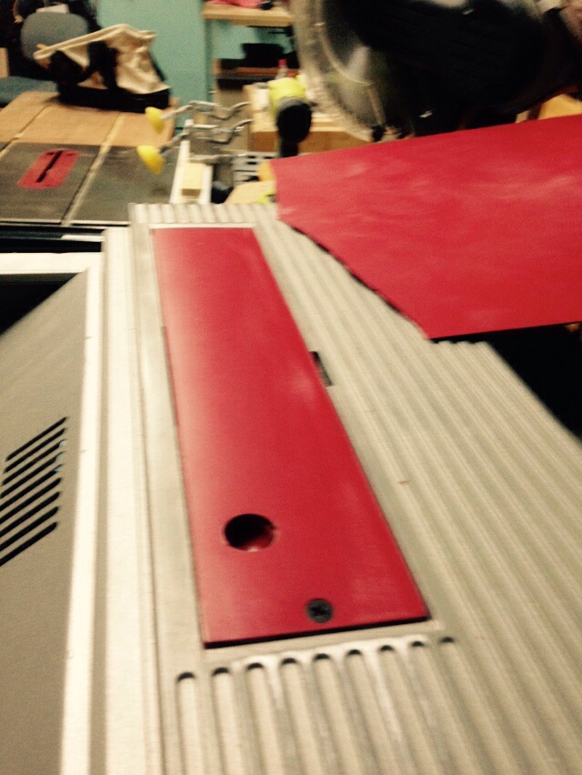

                      New SMT Fence Holder &amp; Factory Throat Tune Up

                        I'm of the opinion the keeping a sharp blade on this saw helps extends its operational life more than anything else.
                          • 22109
                          good solutions to the miter fence clamp. That's the second one I have seen, the first one was all wood and belonged to an Australian.
                          I think you are in the spirit of the saw, making custom pieces is easy because of all the hooks and attachment points, it's fun for the creative mind!
                          Good luck, make lots of money with it.
                          If you're interested my BT3 FAQ has a lot of tips and facts on the saw in it. See my sig line below for how to get it.
                          There's even a item on five things a newbie breaks on a BT3.
