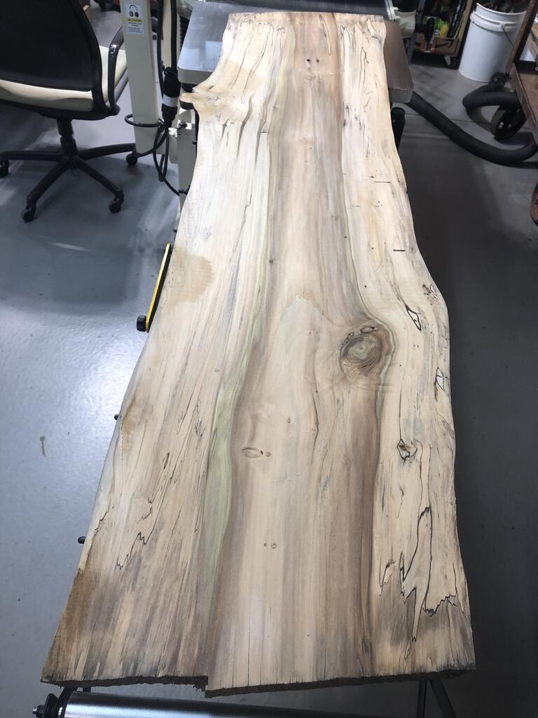

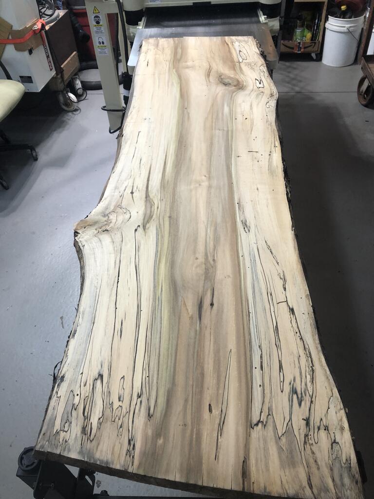

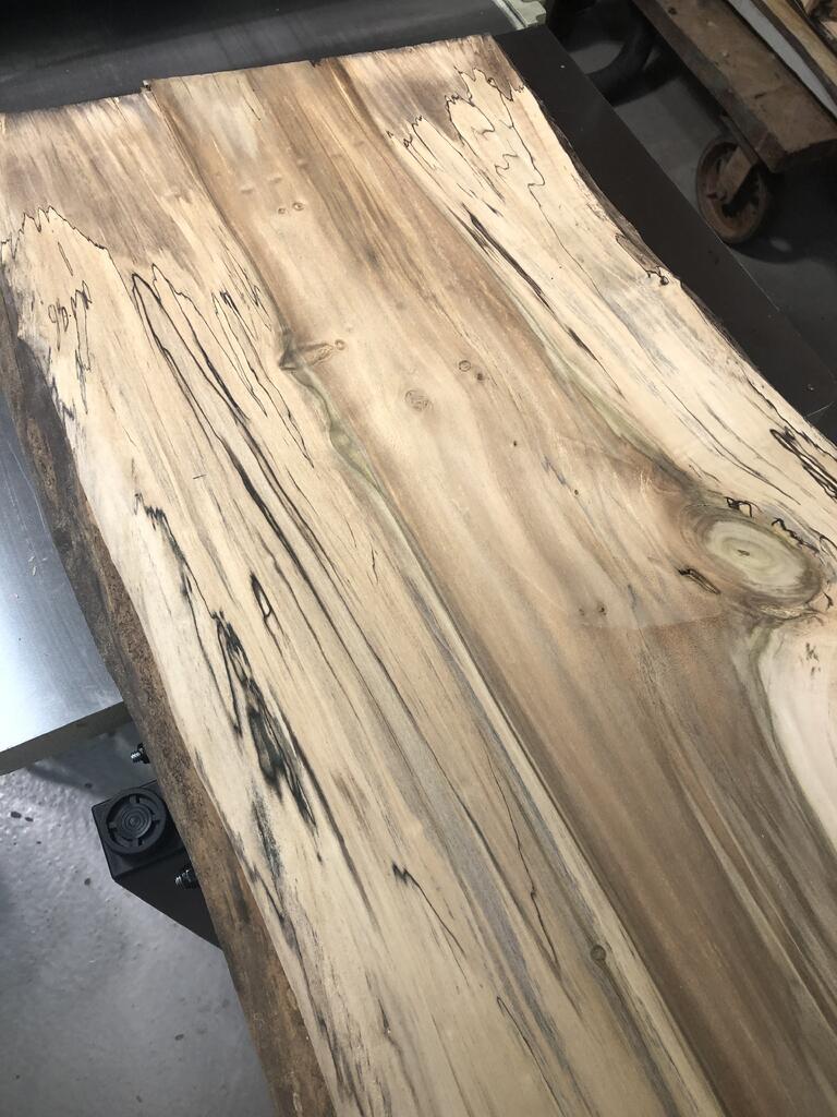

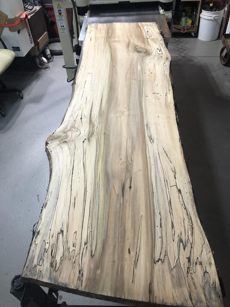

ID:	861411 My project yesterday was to prep 3 slabs that I purchased from a local sawyer. I believe them to Sycamore, I’ve stored them in my woodshed for several years and it’s time to get them ready for some special Tiny Tables. I sat the planer up across the front of the shop rather than front to back as intended as a quick run rather than move anything around.
