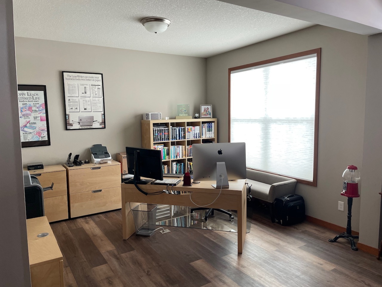

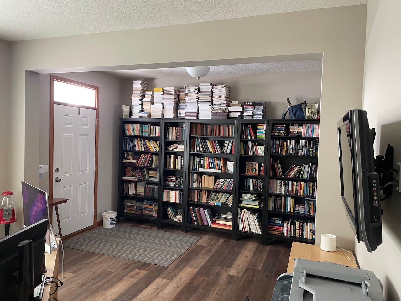

    It seems like I rarely post anything in finished projects and this may be premature, but at least the first part is done.
    My home office is in a bonus space right next to the front door. The opening was 11' of wasted space and we clearly needed additional space for books

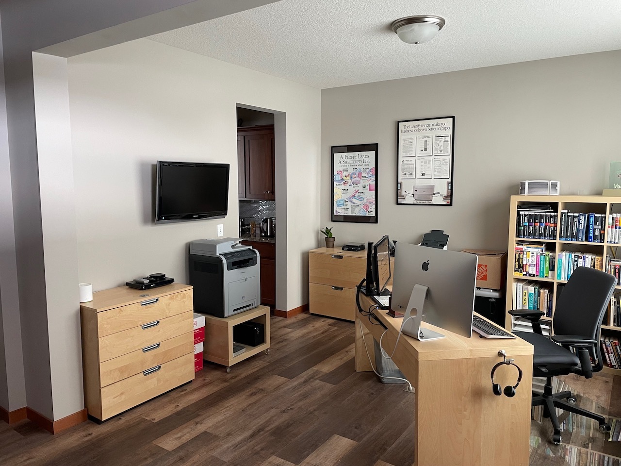

    ​The next two pictures are of the lovely Ikea furniture that came back from the kids college dorms that they didn't want in THEIR new houses.

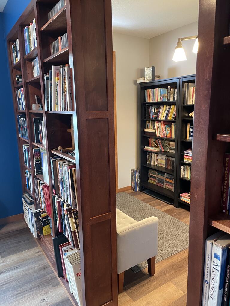

    Below is the first completed phase. I mostly filled in the opening to the hallway with 4 2' wide bookcases which have been in place for months. Last week I finally finished the end panels, floor trim, and doorway top and got those installed.
    The bookcases viewed from inside my office

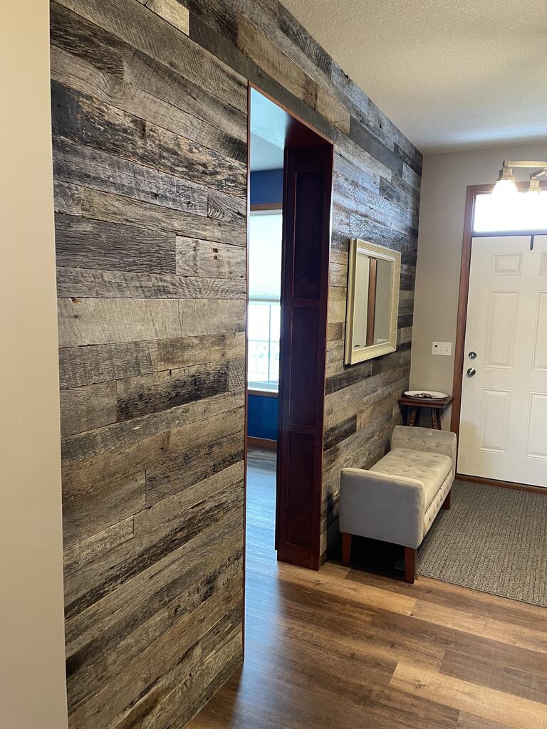

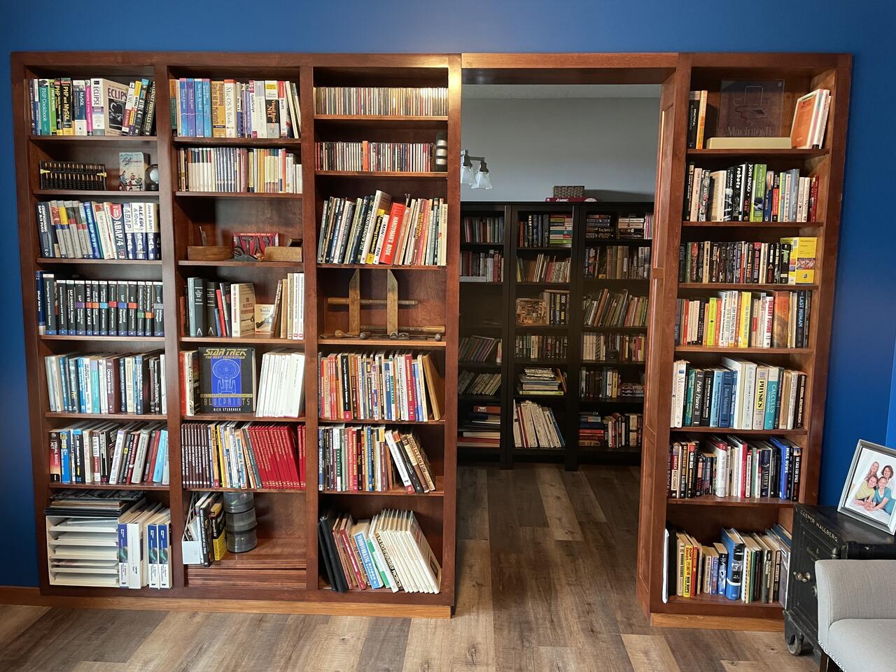

    And finally, the reclaimed barnwood wall which is the back side of the bookcases. I am planning on adding a rolling door that will match the woodwork on my side and be a barn door on the other.

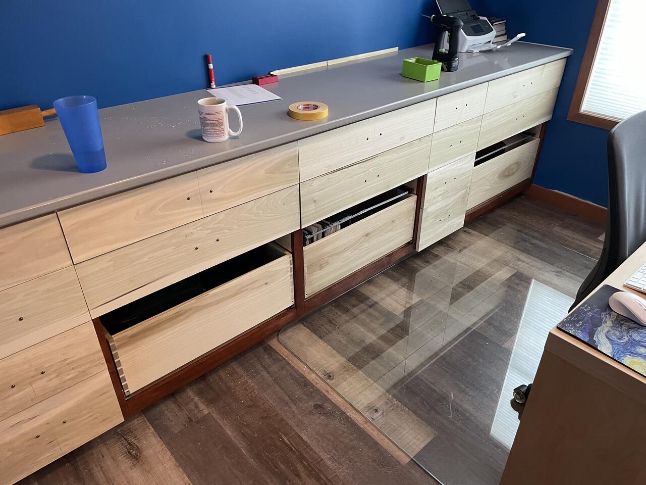

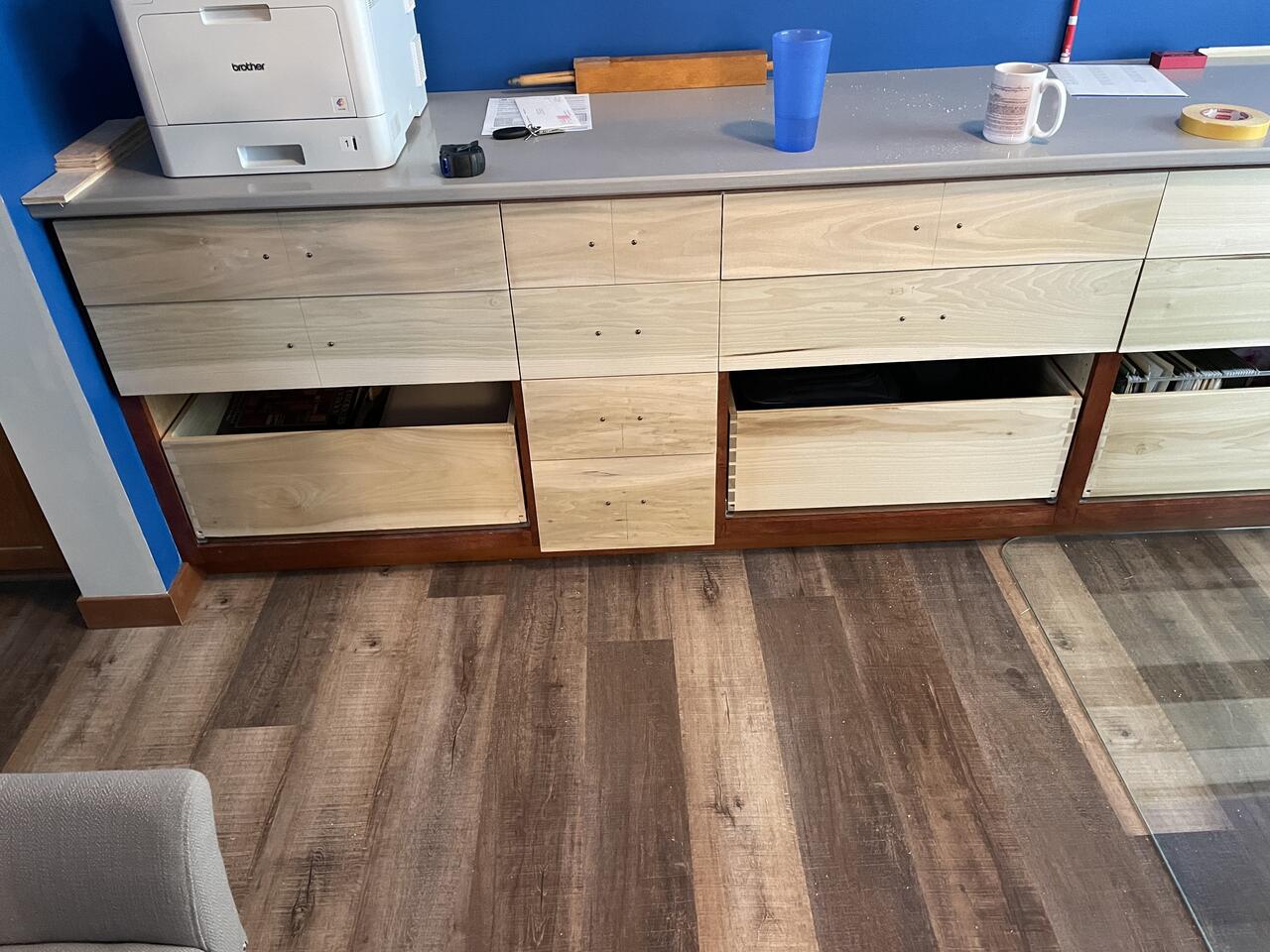

      I got all the drawers finished and installed a couple of weeks ago. The base cabinets were installed in July of last summer and it took Home Depot 6+ months to get the the counter tops installed after they cancelled my order due to supplier issues and then upgraded them from Corian to Quartz, so an overall win.
      I fitted most of the drawer fronts on Friday and the rest on Saturday. They are ready for the finishing room, but I'm out of stain and it won't be delivered until Friday.

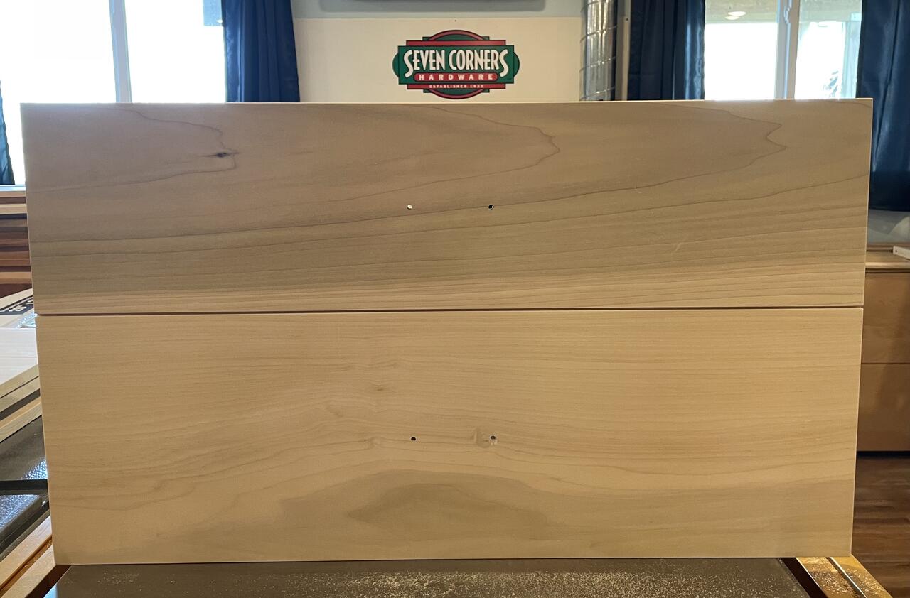

      For the large lateral file drawers, I glued up a panel the height of the bottom two drawer fronts. + the gap between them. I then cut a 3mm shadow line across it so the slab front gaps will be consistent across all 12 feet of cabinets

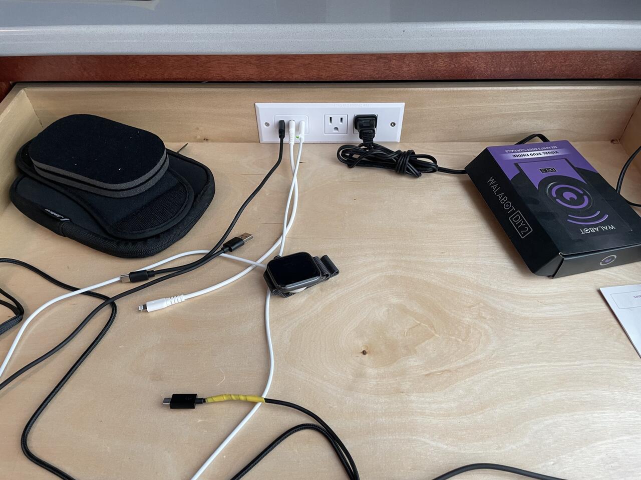

      Two of the top drawers have power for device charging so all the random electronics that are now required for life aren't all over the counter tops when being charged.
      Note that the yellow tape on the one cord is not to repair damage but so I can tell the difference between the USB-C cables and the one Micro USB cable in the drawer.

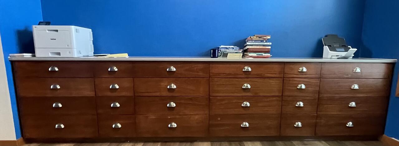

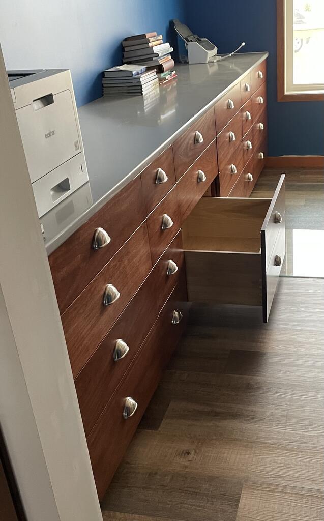

        I finally finished the lower cabinet drawers in the office. 20 drawers in total.
        Click image for larger version  Name:	IMG_3072.jpg Views:	0 Size:	52.6 KB ID:	855021​
        There are 4 30" wide x 14" high lateral file drawers for all the paperwork that goes along with my job, and the vast majority of the paperwork is imaged and stored digitally.
        Click image for larger version  Name:	IMG_3075.jpg Views:	0 Size:	73.4 KB ID:	855022​
        After looking at everything together, I think should have used maple or birch for the drawer fronts instead of poplar. I think I'd have gotten a more consistent color in the final product and the cost difference wouldn't have been too much.
