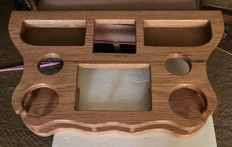

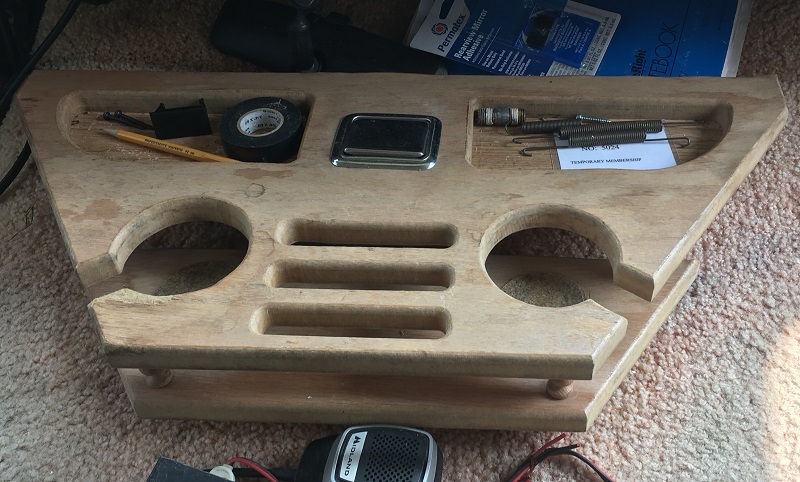

    The console on the engine cover in my '92 RV was in bad shape. It was made of MDF with Oak laminate and there were places where the laminate was gone and the edges/corners were damaged. Plus I didn't like the way it was positioned. It was off center toward the driver side making it hard for the wife to reach, and my cup holder was too far forward. I had to lean forward to reach my drink and had to look down to put t back.

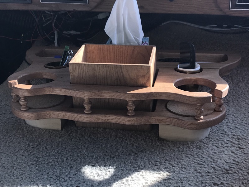

    I went through 4 different cardboard templates before we decided on a final design. I kept the trays and added a small waste basket along with pencil cups as well as a space for tissues. The waste basket turned out to be perfect to line with the small bags at Lowe's. When I run low I ask the check out clerk if I can snag a few!
    Construction is all Red Oak except the plywood used for the bottom of the trays, stained with Ipswitch Pine and sprayed with precat lacquer.

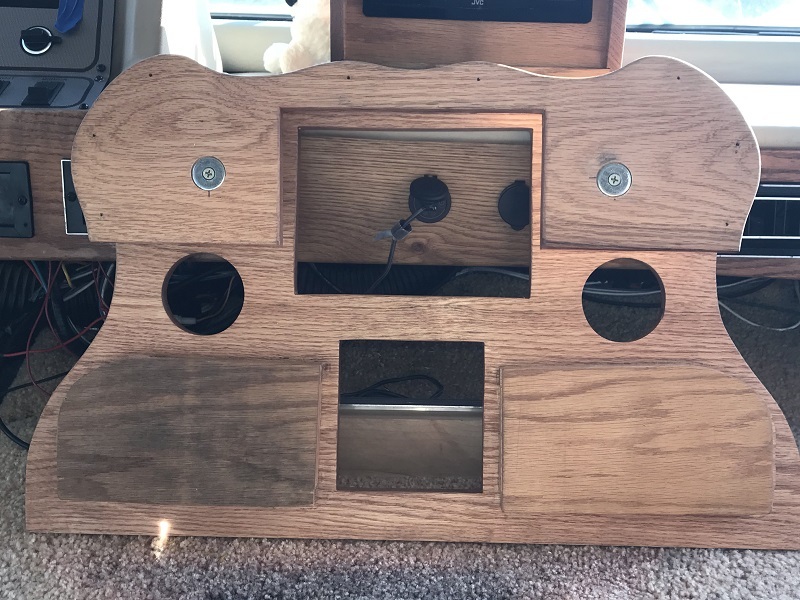

    To protect the console from damage when the engine cover is pulled I wanted to be able to remove it. I used a piece of aluminum angle in front that fits into a groove. The rear blocks have rare earth magnets in them that match up to heavy washers in the bottom of the console. the front and rear mount blocks are made of Poplar. I am going to go cut the front one down as low as possible and remake the rear mounts to match that height. The new rear mounts will be oak and shaped to match the console. Lowering it will also let the brass pencil cups stick out the top a little more.
