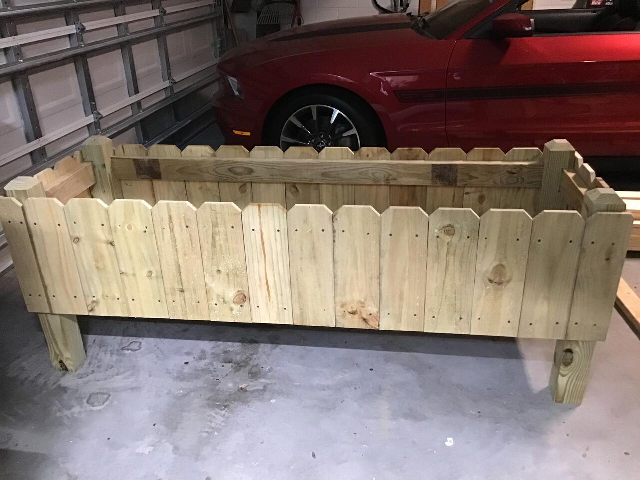

    The wife wanted something off the ground to plant some vegetables so I got started looking at pictures and made a plan.
    the plan was to wing it and work out any issues as I go. This thing is a tank and weighs more than I do.
    now to get a crane service to lift it into place after she paints it. Click image for larger version

    Wow! It needs to be heavy duty as when filled with dirt will be quite heavy.

      Looking great !
      Just a thought - Is there some PT lumber in there like the 4x4 posts? If so just a bit concerned about using it in a vegetable bed due to any chemical leeching.
      Or it may be regular material - just the light making it appear as PT lumber.
      - NG

        Just heat treated for the frame and cedar for the rest. He plan is for plastic tubs anyway so leeching shouldn’t be an issue.

          My wife has been after me to make some of these. I really like the dog ear pickets. Nicely done.

            11 of the pickets were like that from Lowes. The rest I cut.

          I’d suggest putting each leg on a 12x12 concrete paver to prevent settteling.

            The legs are on pavers for that very reason.
          24" x 75" looks like. Maybe 6" deep.to the bottom of the upper rail.
          If topsoil is 80 pounds/cu ft then you are looking at 430 pounds for the dirt alone. Might be heavier when wet.
          12x12 concrete paver under each leg a good idea
          Weight of dirt/ soil per cubic foot:- on average, weight of dirt mixed of top soil can weigh 80 pounds per cubic foot which is approximately equal as 0.04 short tons, in general it can be range between 74 – 110 pounds per cubic foot, dry loose dirt can weight around 76 lbs per cubic foot and while moist loose dirt can weigh around 78 lbs per cubic foot.

            You are correct on the size. Depth is about 12” give or take but we only filled it to about 8”
