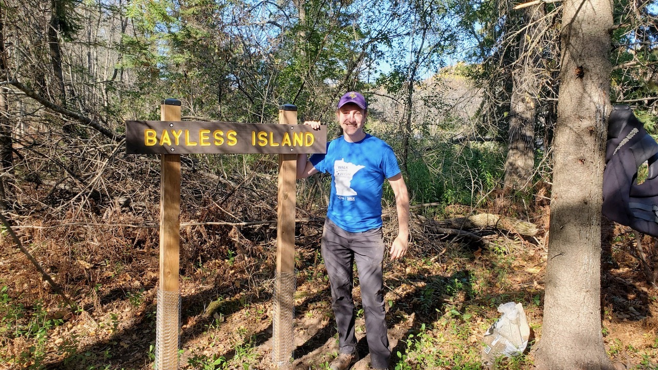

    My son in law owns a small island in the Duluth Superior area. I have never been there so I don't know exactly where it is. Anyway, it needed a new sign so we made one with the Rockler State Park sign making template on Sunday morning. He stained and painted it and finished it tonight.
    It was his first time using a router and he got hung up a bit on each of the "S"s but all in all it turned out pretty well.
    I did the vertical line of the "B" and he did everything else. It's made from a 4' pressure treated 2x8 so it should easily outlast me.

          The problem he had was the tape we used to hold the template in place. We used Gorilla duct tape and the router hung up going over the edges of the tape. My next attempt will use double sided tape and hopefully that will eliminate one source of error. I'm sure I'll find plenty of new sources of errors.
            • 3128
            He got it installed on the island.

              I like it when we come back and show the final result in its natural use setting.
