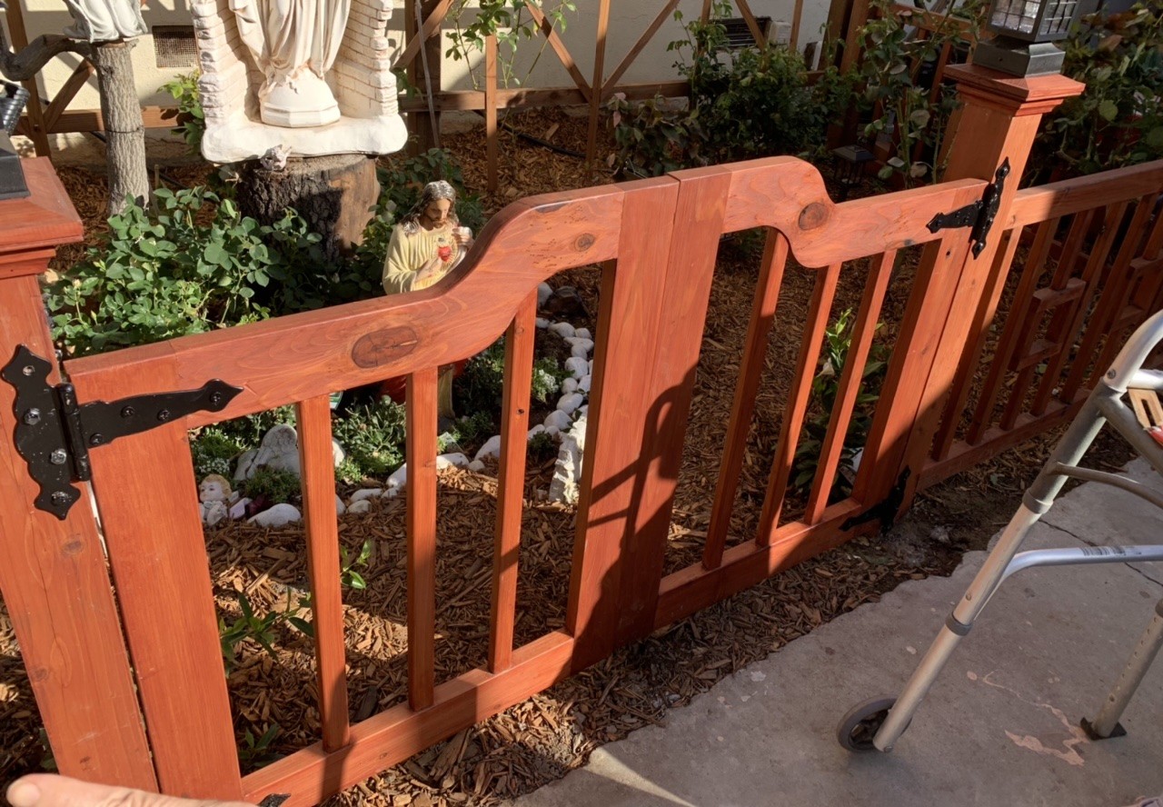

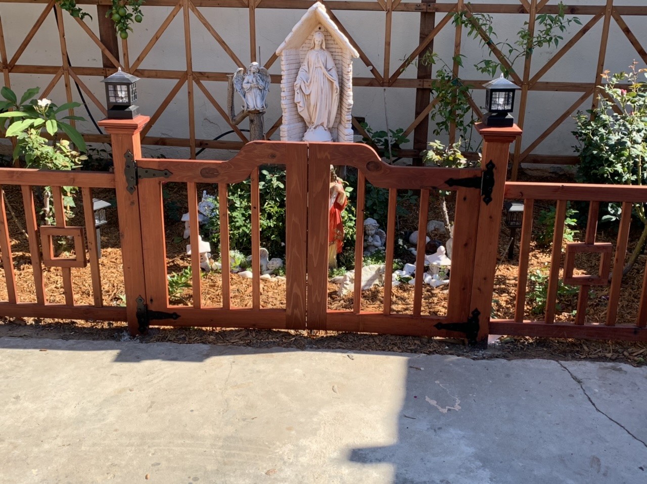

    An early Christmas present for mom. Been stuck at home since covid so gardening is her only form of exercise. Made out of recycled redwood bleachers. You can still see some of of the stained bolt holes. Decided to leave them in instead of cutting around them.

      I forget if it was from a school or maybe a park? About a year ago someone listed it on Craigslist. 15-20 foot redwood boards. 2x8 mostly. He was a contractor hired by the city to tear the bleachers down. I ended up buying a couple dozen boards. He prob had close to 200. If I had the room to store it I would have bought twice as many. When I cleaned it up it was pretty much all heartwood. Best part was the price. $3 each. Not bf but each board.

        That redwood looks so good! Unfortunately we don't have any here in FL. What sort of finish did you use?
        Your design of the fence and the gate is very neat!

          Thanks. I forgot the brand but it's the standard type they sell in Home Depot. Build was pretty straight forward. Finish is just a stain. All the joints were done using dominos except on the curved part of the rail on the gate. I couldn’t figure out how to do that with power tools only. Ended up establishing the walls with a slot cutter and chiseling out the rest.
