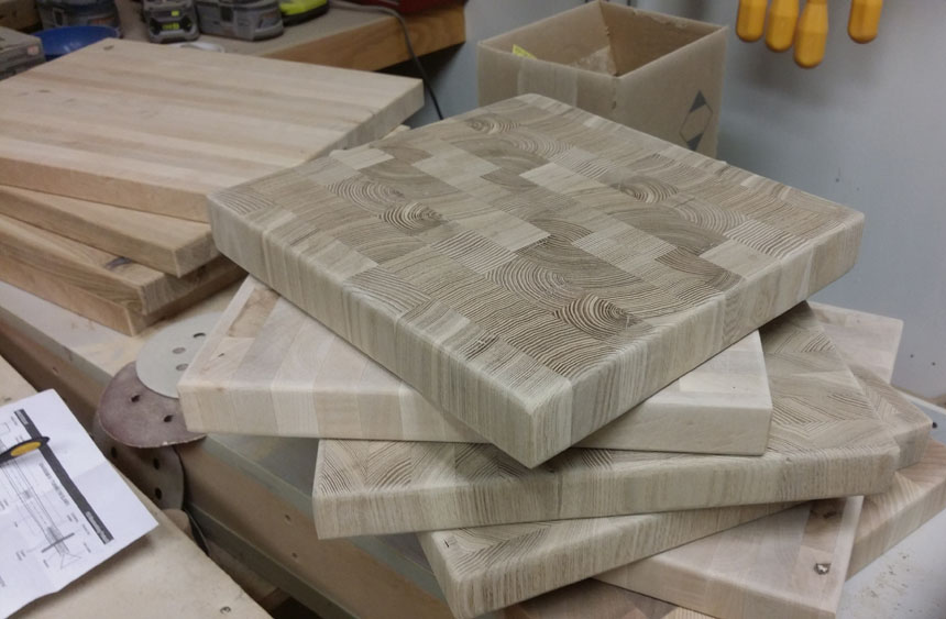

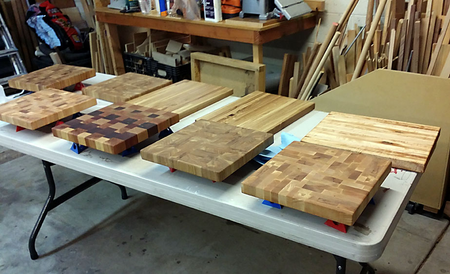

    Wrapped up 10 cutting boards this weekend. Those pool table legs worked out really well. I can make 2 of this sized board from each one, either approx 12" Sq end grain or 12"x16" long grain. I have another technique for cutting them up that could yield larger boards that I will try next. I think I have 8 or 9 legs left so that's quite a few boards, although if I quarter them length-ways it would yield 4 x 3"x16" turning blanks that could become pepper mills. If anybody has any other ideas let me know.

    OHHH Ahhh those are nice!

              Great looking bunch of cutting boards!
                That is a lot of glue up! That's an impressive array. I kind of remember the pool table thread. They weren't all made from the same species of wood? Looks like white oak, maple, and cherry?
                  Good memory. There is one different board in there that I had started a while back but had not yet got around to finishing. Its the 2nd in from the left and IIRC it has white oak, cherry & walnut. The legs seem to be pretty much maple or oak although there may be a random odd piece that sneaked into the original glue up.
                  There wasn't quite as much glue up as you might think. The legs are essentially ~6" x 16" and are a laminated construction. I took slices either with or across the grain and then reassembled the pieces. For the end grain ones it is 4 slices joined together. If you look at this one you can clearly see the 4 identical slices. I rotated each 90 degrees which I think makes for a very pleasing design. The only limitation with this method is that I am rather stuck to making boards that are direct multiples of the 6x6 square. A 12"x18" board will be a good size and I think I will do at least one of those. 18x18 I think is a bit big and aligning 9 pieces will be rather a pain. I do want to try cutting a couple into either 2x2 or 2x3 by 16" pieces and then gluing back up as one would a regular end grain board. it should create some interesting patterns.

                      Those do really look good. When you first posted photos of the pool table legs I though you had gotten a bunch of firewood. Smart re-use of materials.

                          I always try to pick out my favorite when people have posted a bunch of something. I'm stumped this time though, every single one of those cutting boards is really nice.
