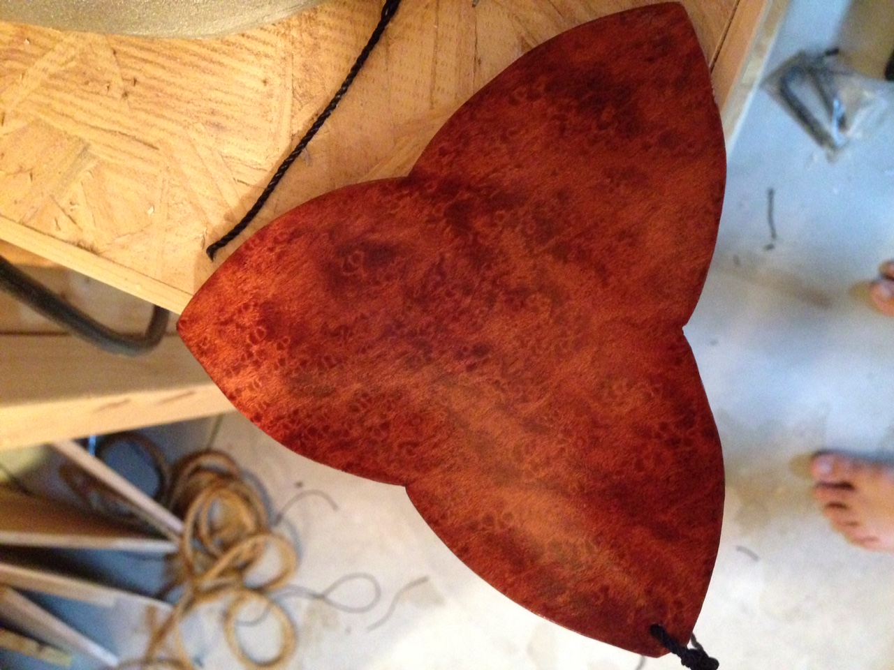

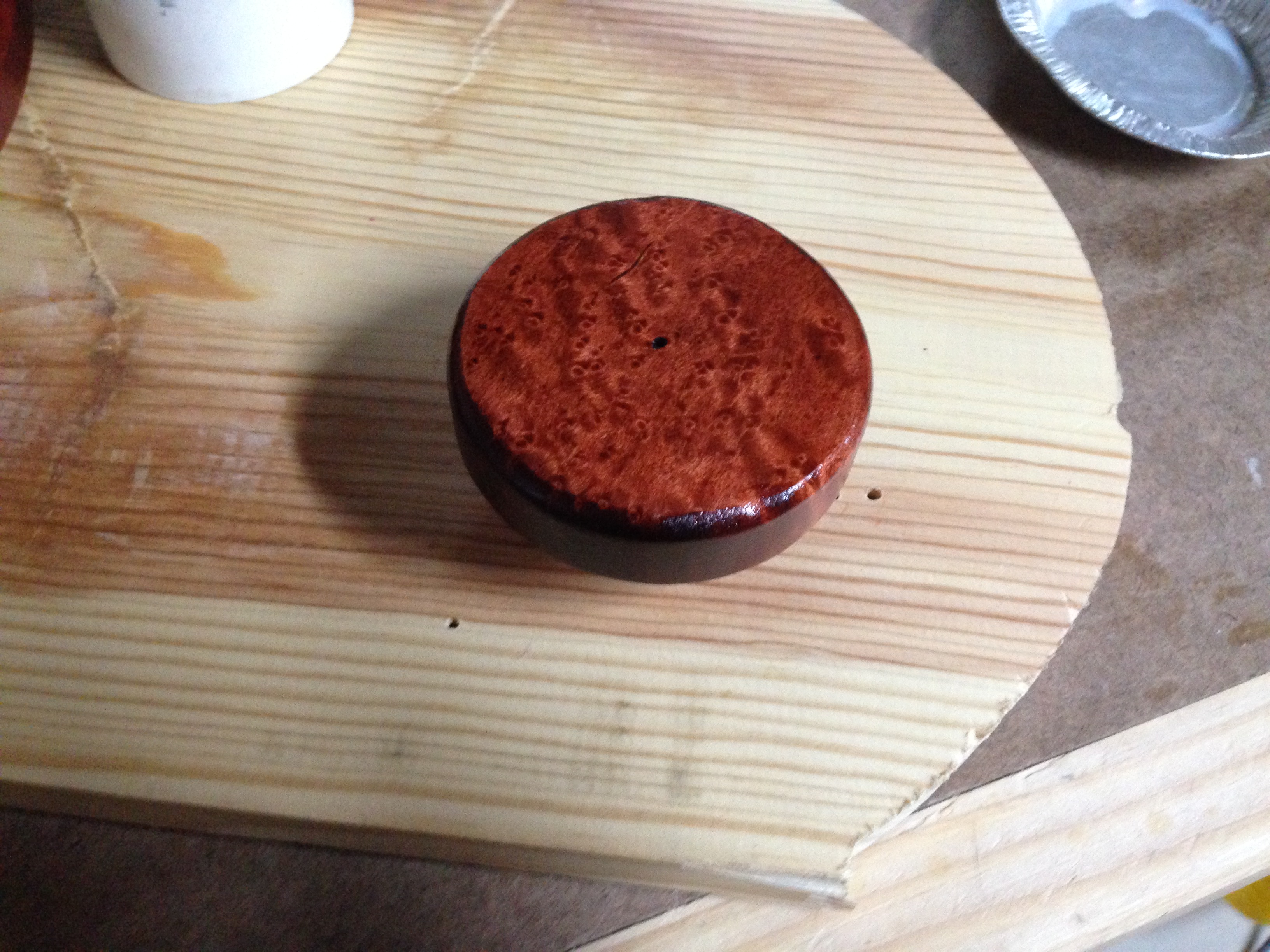

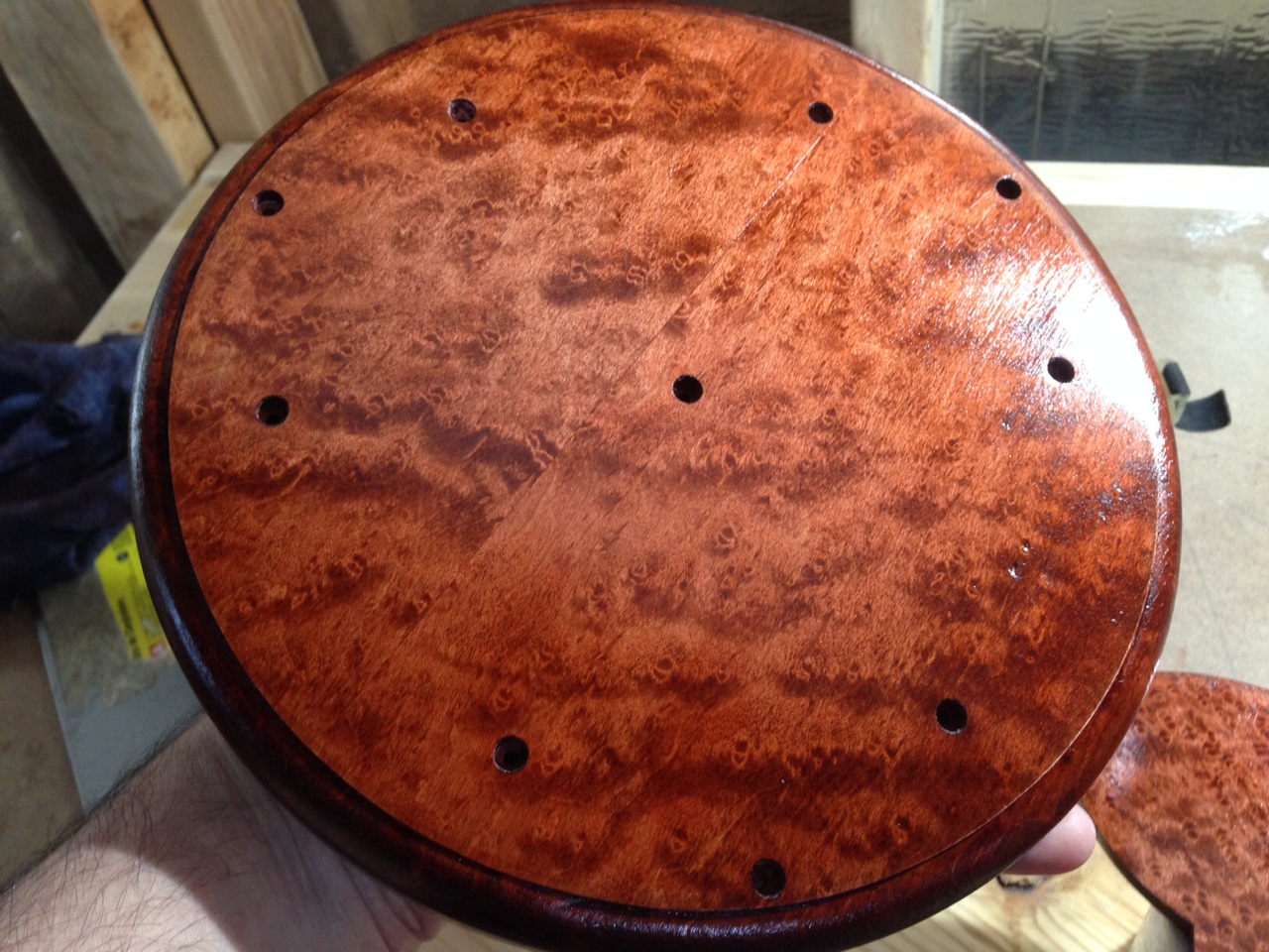

    Here's a set of windchimes I built for a family member's wedding present. Wife asked me to do it as the person getting married values hand made items much more than store bought. The chimes themselves are a bit large, which makes them unique. They are 2" aluminum pipe, the longest of which is 41-7/16" and there are 6 chimes. The wood top, striker, and windsail are Spalted Maple that started as scraps from Rockler. I used my jointer to get them flat and then glued up the resulting pieces to form a 10" circle for the top. The edge is a simple round over bit. The wood is stained cinnamon red and is finished with a clear outdoor high gloss varnish. You can't really tell, but after staining and finishing, the wood almost has a "shimmer" or luminescence to it. I stopped counting somewhere around 8 coats. I hand sanded the aluminum tubing with 320 and the 800grit wet to give them a "brushed" aluminum finish. All in all, I think they came out pretty good. The pics aren't the greatest, but hopefully you get the idea. As a musician, sound was important to me and I can honestly say the sustain is amazing---They ring for at least 2 mins after striking (I have to give credit to leehite.org as anything you could ever want to know about windchimes is there.
    Definitely not up to the level of some on here, but given that this is the first time I've tried to actually glue up smaller pieces, I think it came out ok.
    Thanks for looking.
