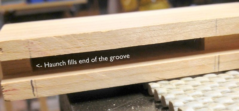

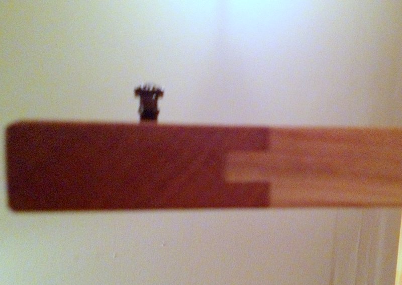

        Beautiful work. Curious as to why the tenons needed to be haunched?
            The haunch basically fills in the groove that runs all the way around the inside frame edge. The groove accepts the panels, glass and the other munions? mullons, muttons, whatever you call them
            It would add some strength and help with alignment too I suppose. Here are some shots of the mortise and a fuzzy pic of the end of the frame haunch with the groove filled in.
