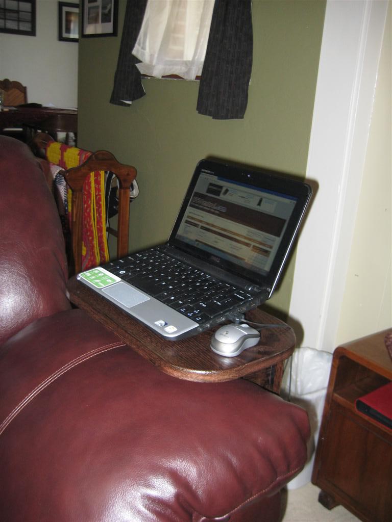

    Hi guys,
    Just finished a little table that slides underneath my "man-chair" to hold either a cup of coffee or a netbook while I try to wake up in the morning. It's not the most difficult project in the world, but it represents what I love most about woodworking -- the ability to custom fit a project to your needs. I wasn't sure about the physics of such a table, and got a lot of good ideas from the sofa table projects posted here.

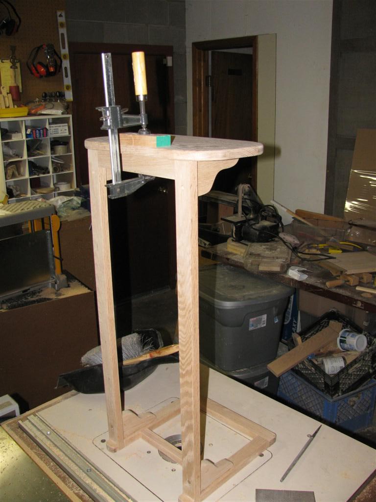

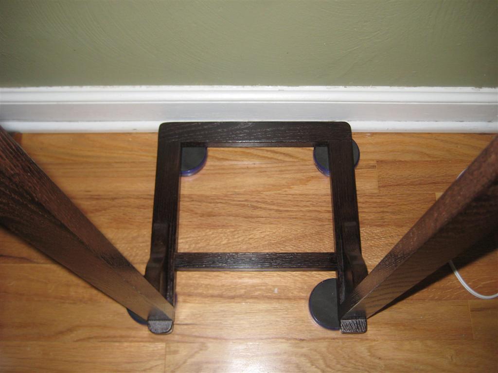

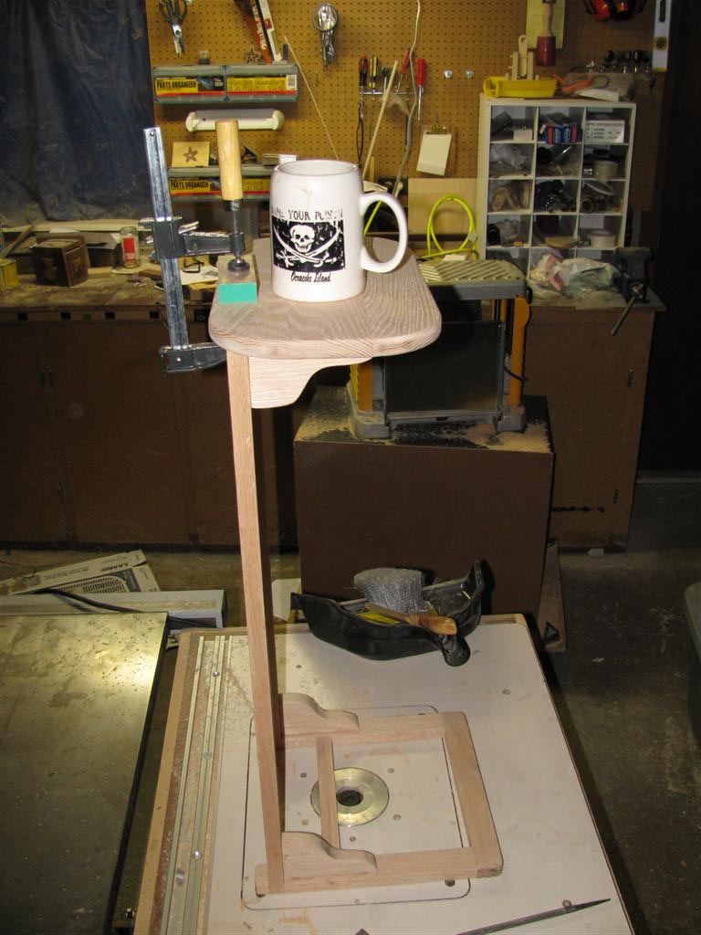

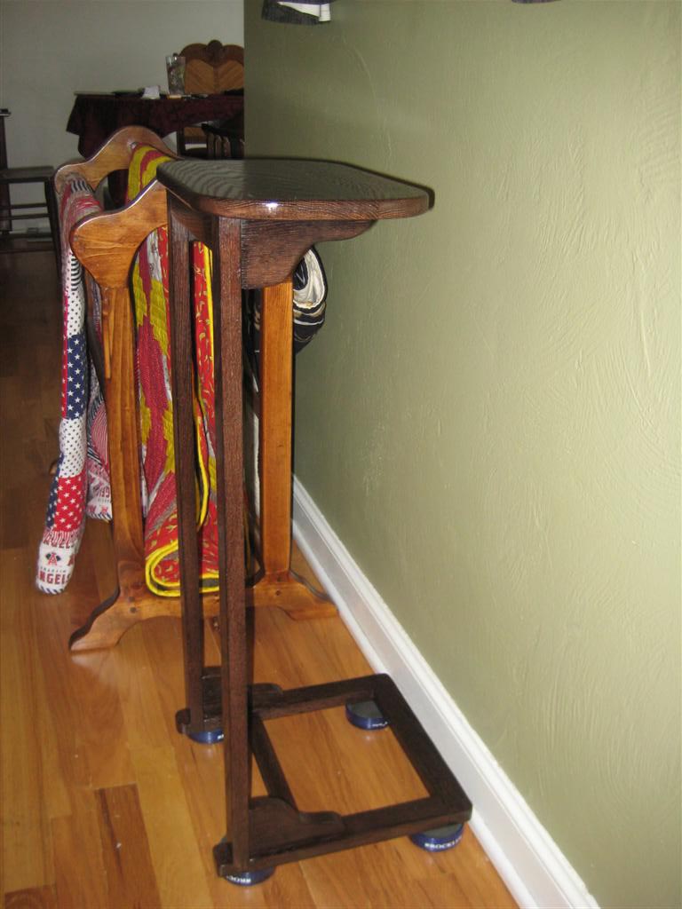

    It was constructed out of red oak, and joinery was a combination of hidden pocket holes and plugged screws, with a couple of biscuits thrown in for alignment. The table was ebonized using the vinegar and steel wool method, and finished with General Finishes poly/oil blend. I've attached a couple of pics of it unfinished to give an idea of how the ebonizing works.
    Thanks for looking,
    --tlt
