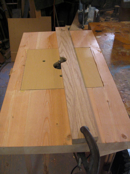

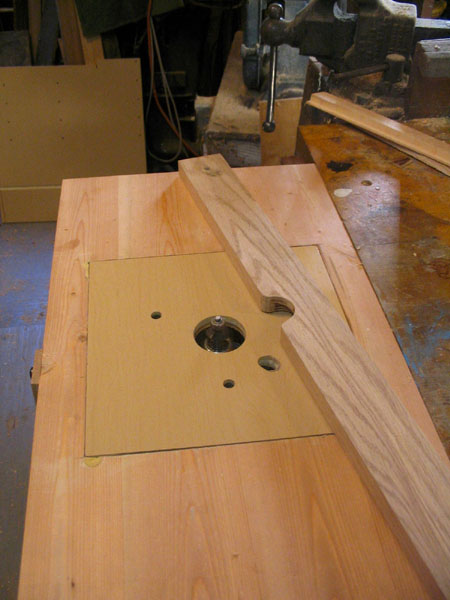

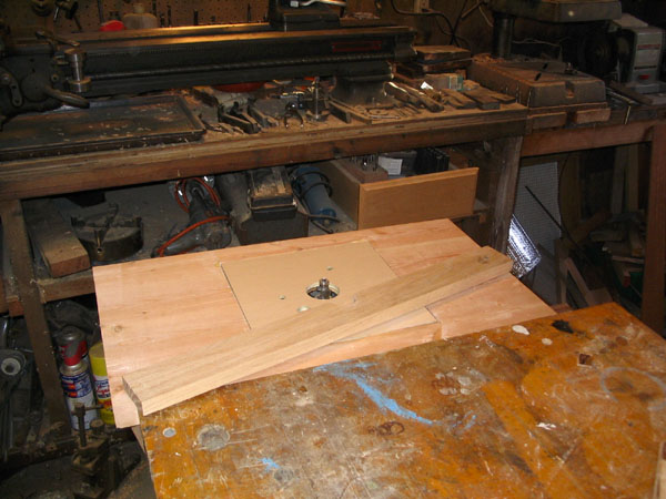

    I have been thinking about what kind of router table to make or get. What I ended up with is a home made router table fastened to the end of my workbench. Here are some photos.
    The top is made from #2 2X4's glued together to make a 12X24 inch top
    The insert is made from material from a cabinet I cut out when installing a dishwasher.
    The worktable supports are pieces of oak bolted to the workbench (hanging underneath) using one bolt so they can swing. They have pins that slip into holes in the underside of the router table. They are shimmed so the router table is even with the top of the workbench.
    The fence is a piece of oak pinned to the table at the far end with the other end clamped in the desired position.
    One oak leg on the side completes the job.
    I didn't cost me a dime. All the material I had lying around.

    good practical DIY shop woodworking. Nothing wrong with your bench/router table and I take it the price is right.
      Very nice. That's a great way to get a nice router table without putting out a bunch of cash.

        One of the really nice things about that setup is the bench acts as a really long in/out-feed table or a very deep support for something large. The face edge of a door can be done with the whole door supported by the bench and router table top.

                          I used a very simple one like that in the beginning. Eventually you want someplace for the dust and chips to go.
                            That is awesome! Check it with a straight edge every once in awhile to make sure that the top stays flat. Nice thing is that if it ever curls it will be easily planed flat again.

                              Yes, I thought of that too late. I forgot my being taught that when gluing boards, to alternate the ring pattern. Most are glued with the rings going the same way.
