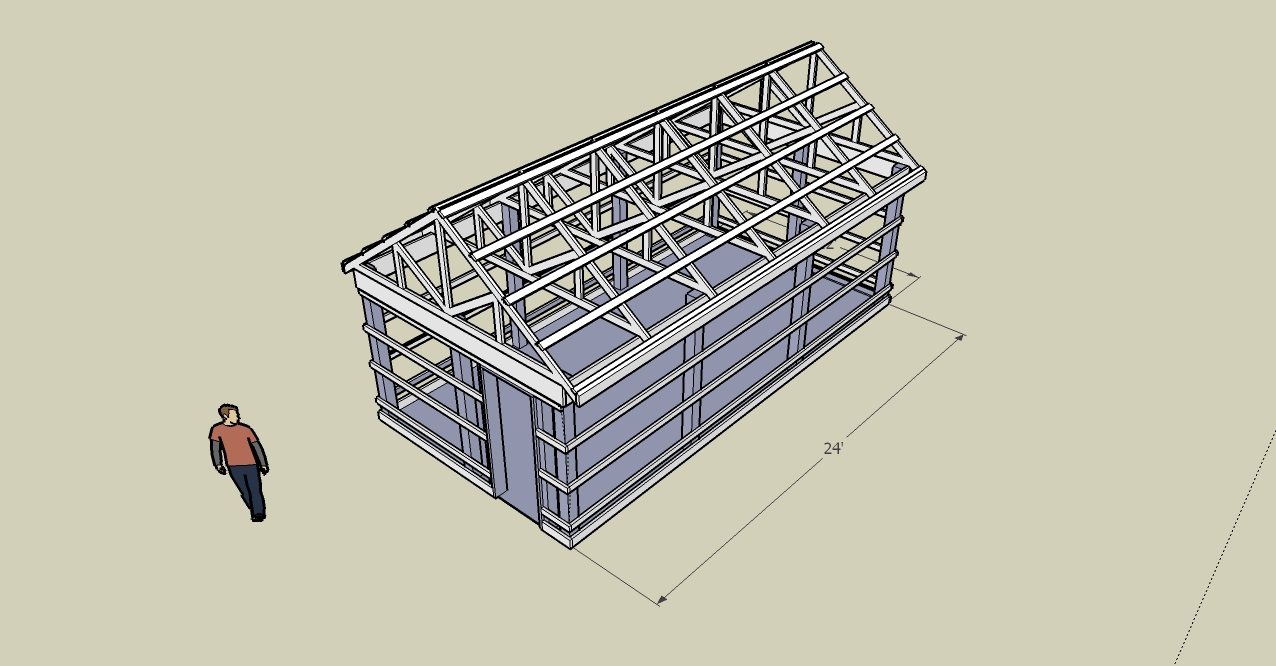

    as always started as a plan

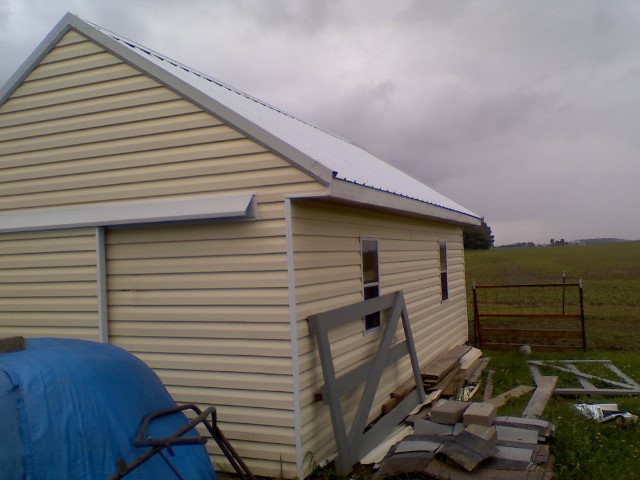

    decided to change the plans a little
    had some extra lumber so put on a nice 6ft lean to.

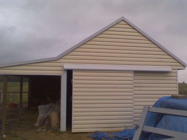

    has a metal roof but was vinyl siding because we were given all of the siding for free (leftovers from a million dollar project). Bet you have never seen a vinyl siding sliding barn door before.

      looks great! i like that sliding door. i think that sliding doors are also resist high winds better than ordinary doors. how long did it take you to build? any shots of what the inside looks like, the trusses, etc? did you also build your own trusses? did you do that rendering in google sketch?

          Slick. I wondered about the siding when I first saw it. Innovative idea using it on the door. Keeps the weight down.

                          the sliding door was one of the biggest challenges, it took a little ingenuity but I figured it out.
                          The door is 2" thick before the siding was added. To start I wrapped the top and sides with the metal drip edge that has a folded over (not sharp) back edge. I then put j channel on top of the drip part of the edge and sided like regular. I then caulked the seams between the drip edge and the j to make it look seamless.

                            and yes that is a rendering from sketchup
