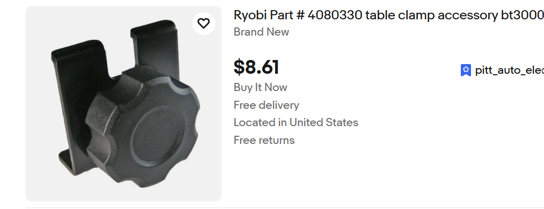

        Do you have the accessory table rear clamp add-on? It is basically a small metal clip, a knob with a threaded shaft, and a T-nut that fits into the rear fence rail. This locks the accessory table, from below, to the rear fence rail. Without it, the accessory table can wiggle a bit when used with a router... not good. Especially if you are using the BT3's rip fence as a fence for router operations. If you don't have this clamp, I would find it first before worrying about the insert rings. You may find it is better to make a dedicated stand-alone router table or make one that fits between the BT3's fence rails and replaces the accessory table. The accessory table is rather small for a router table too. The two router fence things that came with the BT3 "accessory kit" (which included the insert rings, router mounting plate, a jigsaw mounting plate, a clear plastic bit guard, the rear clamp, and other misc hardware) are generally considered a joke. You would be better off making something that attaches to the BT3's rip fence and provides longer fence faces on either side of the router bit... and keeps them inline/co-planar. The things Ryobi provided need to be adjusted to be co-planar which is a constant nuisance. A few pieces of plywood or stable hardwood make a basic router fence that can be clamped to the BT3's rip fence. Rockler's "Universal Fence Clamp" gizmos (and similar things from several other manufactures) are great for attaching router table fences or sacrificial fences (what you would use in combination with dado blades while making rabbets) to the BT3 rip fence. I have a few sets scattered about my shop; they're that useful. And they go on sale a couple times a year.

          If you use the Aux table with a router with a bearing like for roundovers, coves and chamfers, the rear lock is not necessary. But if you use the table and router with the fence kit that mounts to the BT3000 rip fence, then yeah, you need the clamp to keep the table and router from moving relative to the rip fence. The clamp locks the aux/router table to the back rail, and the attached front clamp locks to the front rail. Without the rear clamp (part of the router mounting accessory kit), the back end of the table can swing a little and cause divots in your work.

        The OEM are plastic. If you choose to use a router in the accessory table be sure to use the clamp bracket, knob and t-nut. Check the articles section fro the instructions for the router mounting kit.

          You are a life saver! I played with the router table today and noticed the wiggle and was ready to just deal with it. I had a black bracket in my box of accessories that I was unsure of, but after fitting it up, it's definitely the accessory table clamp. I don't have extra T-nuts and knobs, so I needed to borrow one from the router dust collector, but I tested it and locked on great.

              I use my aux router table a lot, and the rear clamp is essential. I have some of the original router rings from the accessory kit, and mine are steel. I 3D printed my own rings from my design in Tinkercad, which I copied from the originals. There may be some free designs on one of the 3D sites, but I'm not sure. Anyway, I much prefer the steel ones as their weight keeps them in place, whereas the light plastic ones can be lifted by dust collection, which could be inconvenient when the router is running.

                I used the BT3000 mounted router loaded with Bearing guided chamfer bit or roundover bits, for edge treatments. When you use it this way you DO NOT NEED the auxiliary table clamp. Because the router and the table are fixed in relation to each other. Shown below:

                However, if you use the router with the router kit fence that attaches to the rip fence, then you do need to lock down the auxiliary table with the clamp, because the back end of the table will have some wiggle and move with relation to the fence allowing the workpiece to be gouged by the movement.

                  I am going to strongly disagree with Loring here. For safety's sake if you are going to use a router in the accessory table you should always use the rear clamp. The table can walk on you even if you are not using a fence. That can be a rather dangerous thing. If you are just using a bearing guided bit are you also using the OEM dust control for the router? The table can walkfar enough to cut the edge of that.
                  Safety should be your primary concern with the use of any powertool. Why shortcut safety to save the < 1 minute to install the clamp?

                    OK, I have two auxiliary/router tables on my saw.
                    They lock at one point on the front. On the rear, they are captured under a lip on the rear rail so they can't lift up. They can only swing side to side with whatever slop there is with a rectangle captured between two fixed parallel objects (the rails) one of which it is clamped to (the front clamp).
                    Now I just went out and pushed on the back ends of both of them and saw no visible amount of movement. So I think its perfectly fine for bearing guided edge trims because the motor and the table and the bit and the bearing are all in the same strongly coupled system. If you are doing edge trim work, you tend to bias any movement toward one side pushing on the bearing, any way, the bit the router and the table as one solid piece in relation to the rails.
                    If I was to use the router fence, attached to the saw rip fence, even though I see no movement, I would clamp the rear because the movement of the rear table could cause a few mils of movement spoiling the fence guiding. Just on the principle that one clamp point makes a pivot.

                      I used a router on my BT3000 about 20 years ago and had the same issue as Marc / Black Walnut. The acc table was well locked on the front and correctly in the lip on the back. I did not use a rear clamp and found that the table began to "walk" rather quickly when pressure was applied with the board against the bit. The subtle fine vibration allowed the walking when the feeding of the board into the route bit began. The front clamp was not enough to stop it. I did not have or could not find the rear clamp, so I chalked it up learning a lesson that I needed that clamp.
                      Although I am getting older and forgetting more, that is one issue that I remember, and if I remember correctly, that issue has been discussed here a few times over the years.
