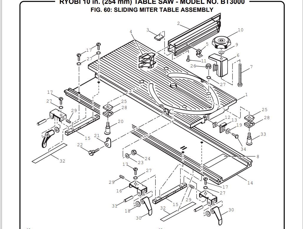

    and here is a good parts diagram of a BT3000 SMT and miter fence which should be almost identical
Name:	SMT exploded diagram.jpg
Name:	SMT parts callout.jpg

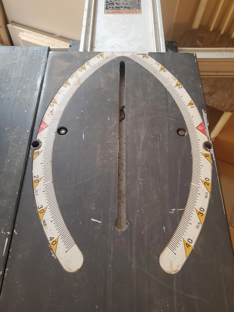

      First of all the name for your piece is the Sliding Miter table (SMT). Helps if we all use the same terminology.
      And your picture is upside down, the silver extension is usually on the front of the saw. It can be a hip basher when not in use, people mount it backwards like you picture when not in use for miter cuts.
      You are missing the Miter fence Assembly.

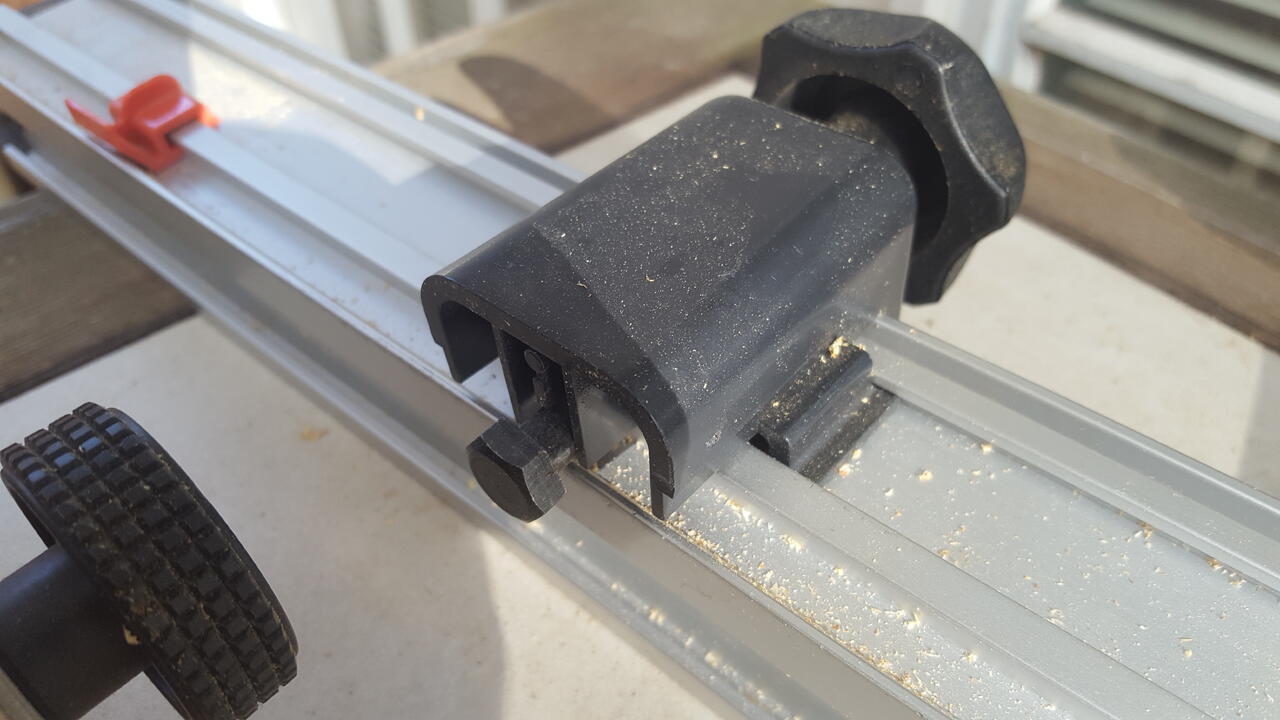

      • Fence extrusion
      • Miter fence holder - a block that uses a knob and bolt to tighten to the track that travels in the slot in the SMT
      • A 5/16 Bolt whose head fits through the hole at the end of the slot to capture the knob and holder

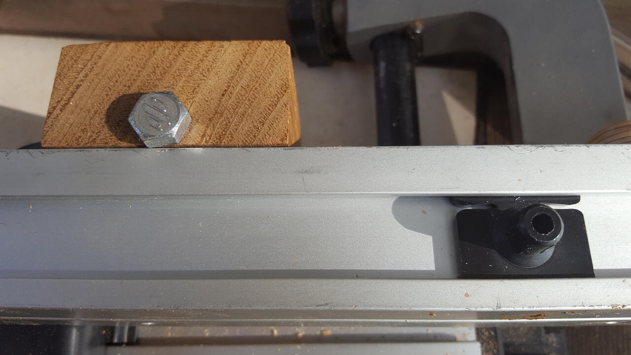

      • A sliding black plastic pin that rides a slot in the bottom of the fence extrusion and pins in one of the holes on either side of the SMT.

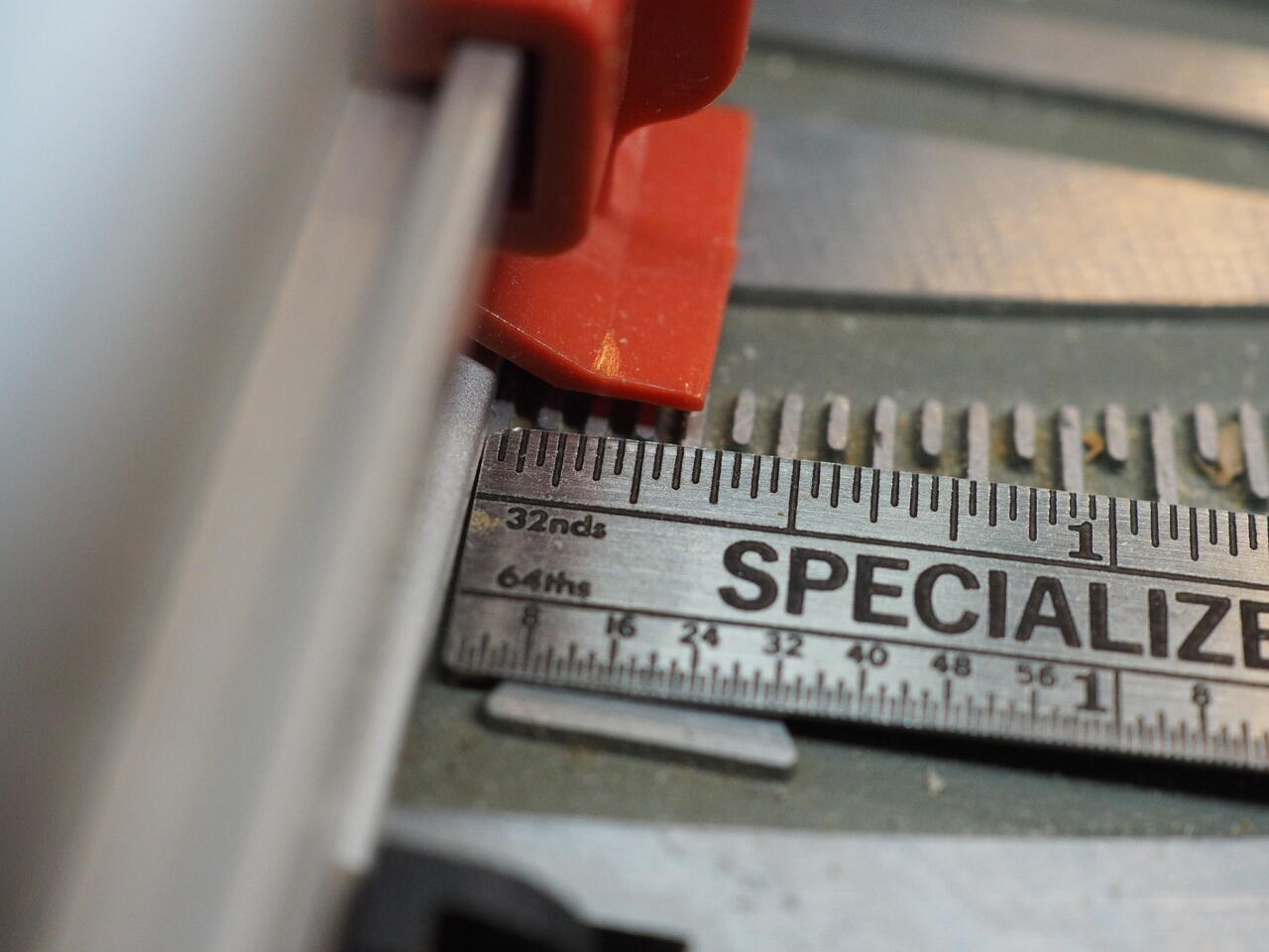

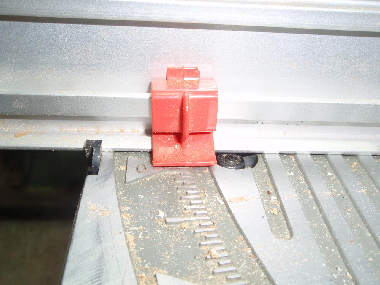

      • An orange plastic pointer that mount to the back of the fence extrusion and is about 1/4" back from the back edge of the fence, and indicatred the miter angle; the back of the fence in its normal position does not indicate the angle

      Holes for the sliding pin - use one or the other as convenient.
      Click image for larger version  Name:	image.png Views:	0 Size:	584.8 KB ID:	862129
