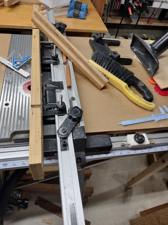

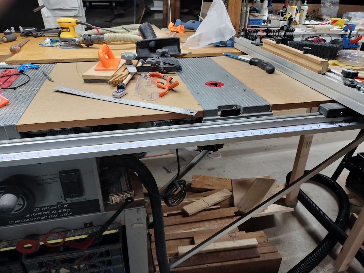

                I have the BT3000 with the router accessory kit with the Ryobi 3 base router mounted in it. I've been using it for years, even professionally for working with plastics for custom fitted yacht electronics installations. I've thought about replacing the Ryobi in the router table with my Hitachi, but really don't have any reason to do so. To me, there's no point in using more horsepower to do anything on a router table, it just burns bits and wood. It's usually best practice to begin a large cut in incremental steps, anyway. I would recommend leaving the Ryobi in the table and saving the PC for handheld work.
                There is always some kind of niggling inadequacy in a router table setup and no over-engineered router lift or table overcomes them all. I've wanted an above the table height adjustment for years, just "because", but from what I've seen from way too many YouTube videos; the end result is the router must be clamped from below the table anyway, and then the height has to be test cut, and then usually adjusted, not to mention the access for collet wrench control difficulties.
                The important thing is to space the accessory table where there's plenty of access.
                Click image for larger version  Name:	image.png Views:	15 Size:	1.43 MB ID:	859301
                I think the only good thing about the router fence accessory is that they're ready made brackets with mounting designed in. In reality, they won't be at 90° in practice and can mess up an operation if doing vertical work.. The two piece concept looks good in the brochure, but it's a huge pain to set them up quickly. I mounted the brackets on a stout full length fence and then fitted blocks on the side where it clamps to the Ryobi fence to enforce perpendicularity. Then I added a sacrificial fence to that. I bought enough T-nuts from T-nuts.com back in the day to leave several in place on the fences and rails. I have the extended fence rail, and it just stays on the Ryobi fence. An important tool for critical work is a fence micro adjuster, which I thank Loring for every time I use it. He's the person that inspired mine by pointing out that a full revolution of a 10-32 screw is a 32nd of an inch!
                Click image for larger version  Name:	image.png Views:	13 Size:	870.1 KB ID:	859302Click image for larger version  Name:	image.png Views:	12 Size:	512.6 KB ID:	859303

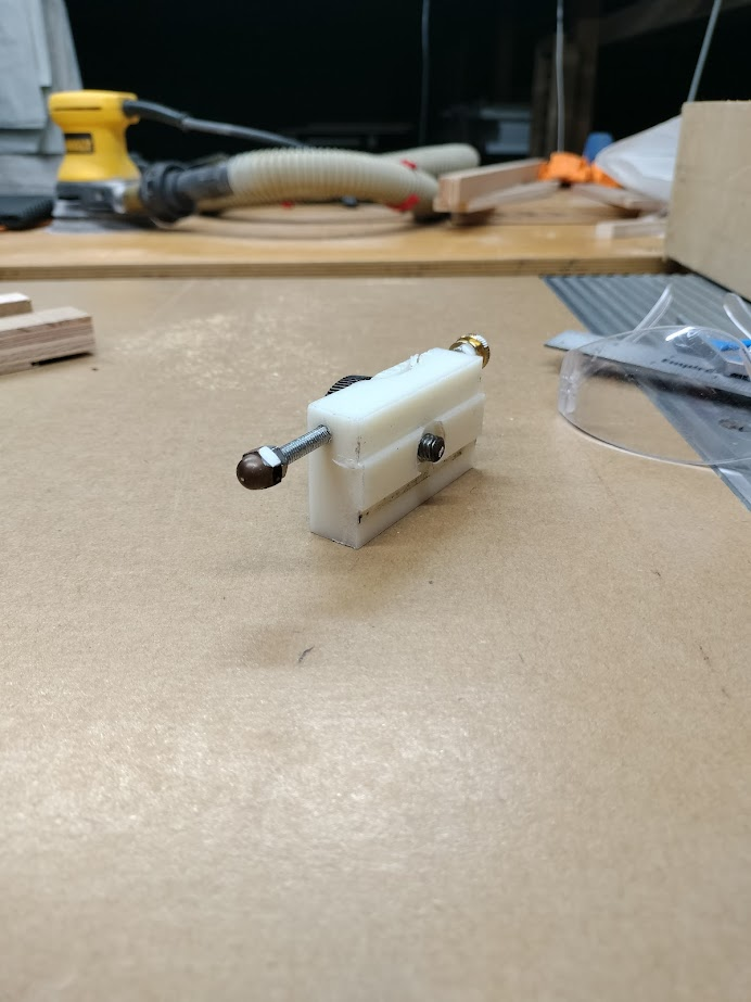

                I've recently replaced the table top inserts with 3/4" MDO, as the 3/4" mahogany plywood inserts I had for 29 years, had warped. There was a miter slot in the predecessor, but I never used it.
                Also handy is a miter slot that fits on top of the rip fence to hold featherboards for routing or thin plywood sawing applications.

                  D_Meister makes a good point, if the Ryobi currently mounted is working, why bother mounting the PC at the expense of a new table and custom mount.
                  Once mounted to a table, most routers lose most of their unique features and just become a motor that needs to be raised and lowered.
