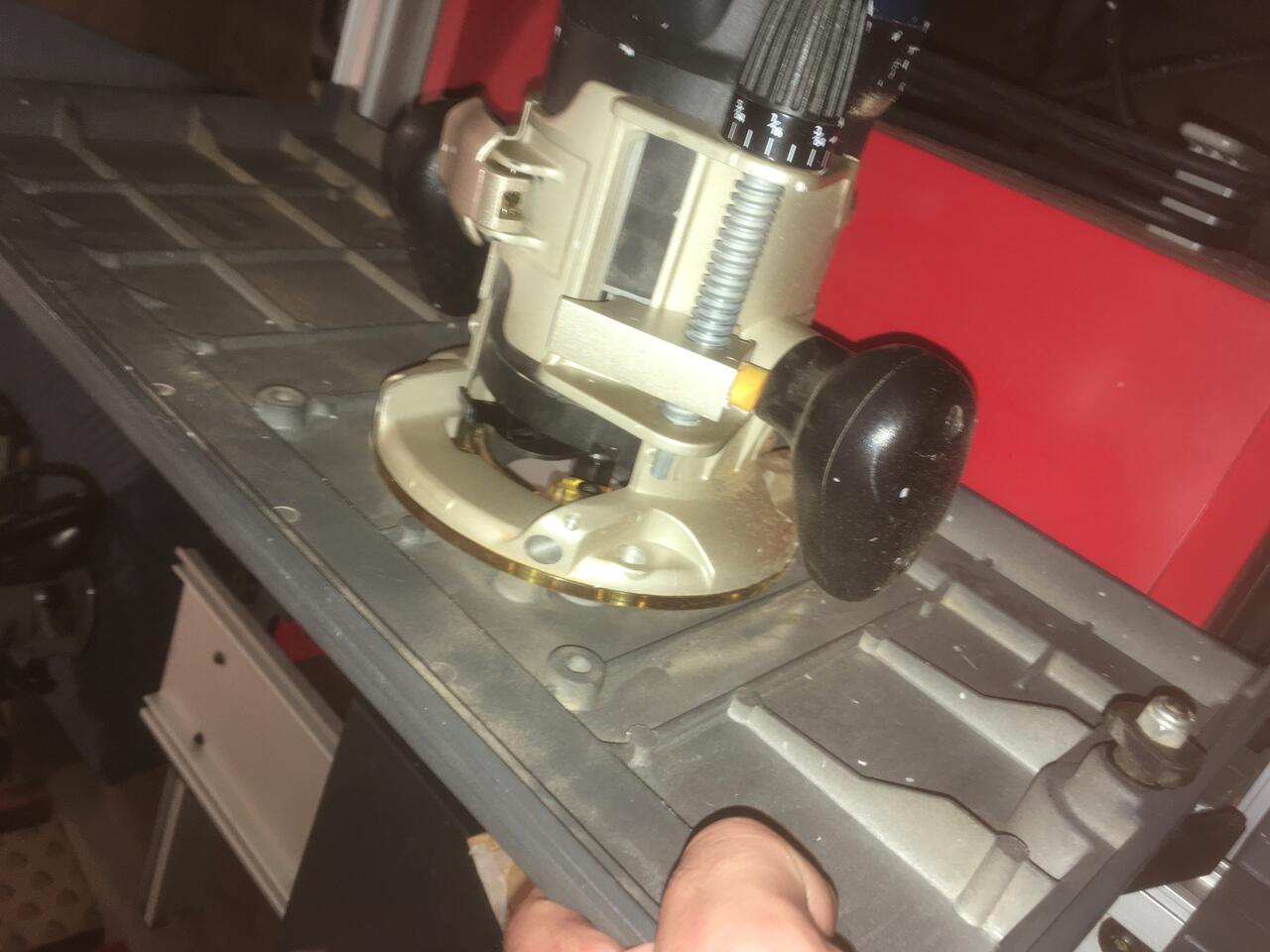

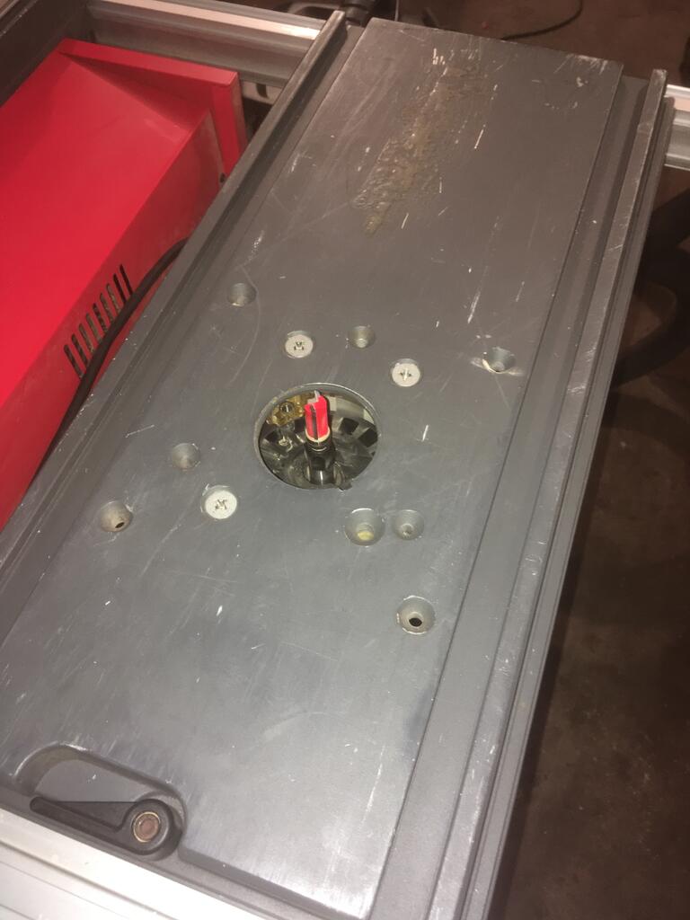

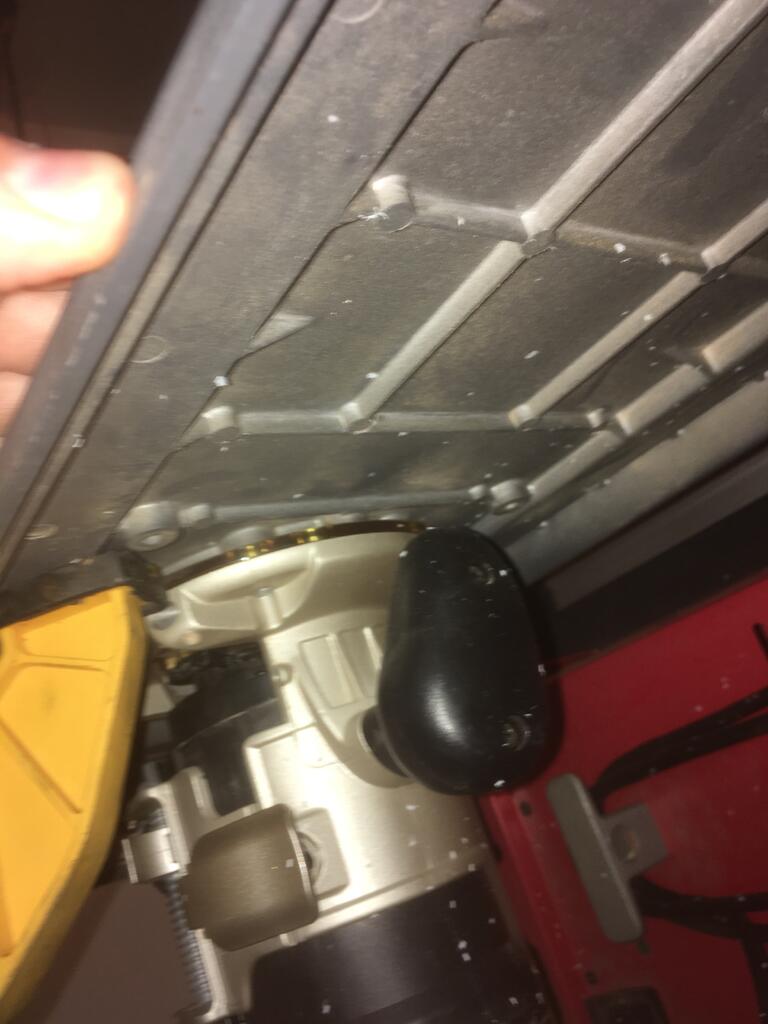

                      I've got some pictures of the craftsman router plate. It looks like it's not particularly thick, it only has support for where the screws go. I think the original idea of the original BT3000 flat surface router plate with with the router accessory it is a good idea. I can drill my own holes for the porter cable router pretty easily, and then get an additional fence for all the router attachments. This should make a pretty elegant solution. Unfortunately between the router accessory kit, the plate, and an extra fence, I can see the prices creeping up. Maybe someone on this site has these parts available, saving the ebay fees.

                        The 21829 rails were about 5-6 inches longer than the BT3x or 22811 rails which were 42 inches long.
                        From the looks of it, the 21829 router table you pictured has some holes pre-located.
                        Click image for larger version  Name:	image.png Views:	0 Size:	239.8 KB ID:	859281

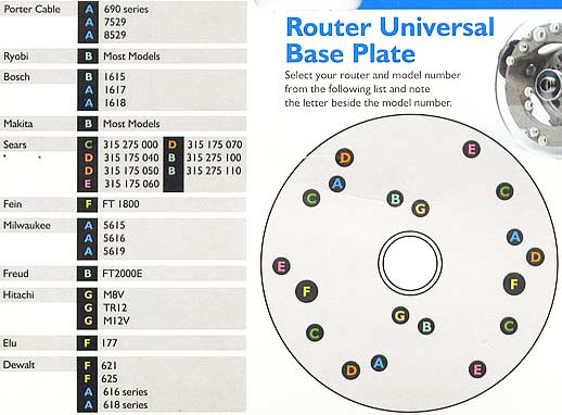

                        The three holes I tagged here look to my eye like they are the holes for the popular Bosch/Porter Cable/Dewalt/Milwaukee routers.
                        On my Bosch router base I measure 3.858" edge to edge and 0.144" hole diameter which makes the center-center distance 4.000 inches. So that should be easy for you to verify.
                        The attached router plate hole patterns shows the Dewalt 618, Bosch 1617, the Porter cable 690 (and 890) series, the Milwaukee 5600 series are all the same (A).
                        Using the holes provided has the benefit that there are thickened "bosses" for the screw and countersink, and that they should be accurately drilled. Personally I'd say this is the way to go if you have the PC 690 or 890 style routers and want to use them. You'd still have to get the Ryobi mounting plate and drill holes if you wanted to mount a router to the OG Ryobi table.
                        My other recommendation to mount ANY router would be to mount the router to a 1/4 or 3/8" plywood board and then mount the plywood board to the outer four existing mounting holes in the table. You can do this for either the Craftsman 21829 router table or the old style Ryobi BT3 router tables if you don't have the aluminum mounting plate. I can elaborate on this if you want but I could type on for a long time, so ask if you want to do this.

                          I appreciate the detail in the post. The three holes you pointed out, those unfortunately do not fit the porter cable router. They are too far apart.

                            What model PC router do you have???
                            What is the hole-center to hole center distance of the three hole pattern on that table?
                            STANDARD 3-HOLE PATTERN
                            Bosch MRC23 Series, 1617-1618
                            DeWalt 616-618
                            Hitachi M12VC (fixed and kit)
                            Makita 1100
                            Milwaukee 5615-5624
                            Porter-Cable 690, 890,
                            7529, 97529 and 8529
                            Ridgid 2930 Combo Kit
