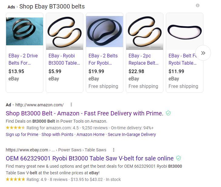

    We know that the original Ryobi supplied dual belts were Specially made poly urethane ribbed belts.
    For the last few years prices were exceeding $20 each and you need two usually.
    You will notice now on eBay there are sellers selling belts purportedly for the BT3's - they appear black in the pictures but are supposed to be exact replacements.
    Ryobi BT3000 Table Saw Replacement V Belt # 662329001 969207002 -2PK
    Brand New! Includes (2) 662329001 Belts. New, Bulk Packed. OEM replacement part. Consult owners manual for proper part number identification and proper installation. Compatible with: Ryobi : BT3000 10" Table Saw, BT3100 10" Precision Woodcutting Table Saw, BT3100-1 10" Table Saw
    Best thing is that you can get 2 for under $20... the price range reflects various shipping charge extra vs free shipping.
    Maybe now is the time to pickup a spare pair... insurance... before they become scarce again.
    Apparently Amazon, too. Just ordered a pair with slow shipping from China... price +taxes +shipping was $10.80 I'll let you know when I get them in a month. Search BT3000 belt on either Amazon or eBay.
    One month+ shipping from China, don't wait until you need one.
    Click image for larger version  Name:	Ryobit bt3000 belts.JPG Views:	0 Size:	75.6 KB ID:	845597

    Loring, this sounds like a good idea - and I like your "insurance" strategy

          Ordered 10/2 and I did receive them on 10/18 almost three weeks earlier than promised.. Black, as was pictured, not the original OEM belt amber color.
          But they appear to be correct. I am not going to change them out for no reason so I am going to assume they will work.
          Storing them in a light tight box so no UV degradation will occur, I hope.
          Here's the eBay link where I bought them (sale item is a pair of belts.).
          https://www.ebay.com/itm/324004487986

            Just ordered the same ones to have as spares. Looking at the pics they appear to be more like reinforced rubber rather than the PU of the originals.
            Not convinced they will last 23 years like the originals but not sure I'll last that long either.
