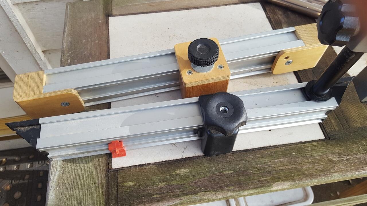

      Plus, I have Rod Kirby's shop made one he sent me when he retired his BT3; I use it, its set up on my long miter fence.
      Click image for larger version  Name:	image_25721.jpg Views:	0 Size:	208.8 KB ID:	856899
