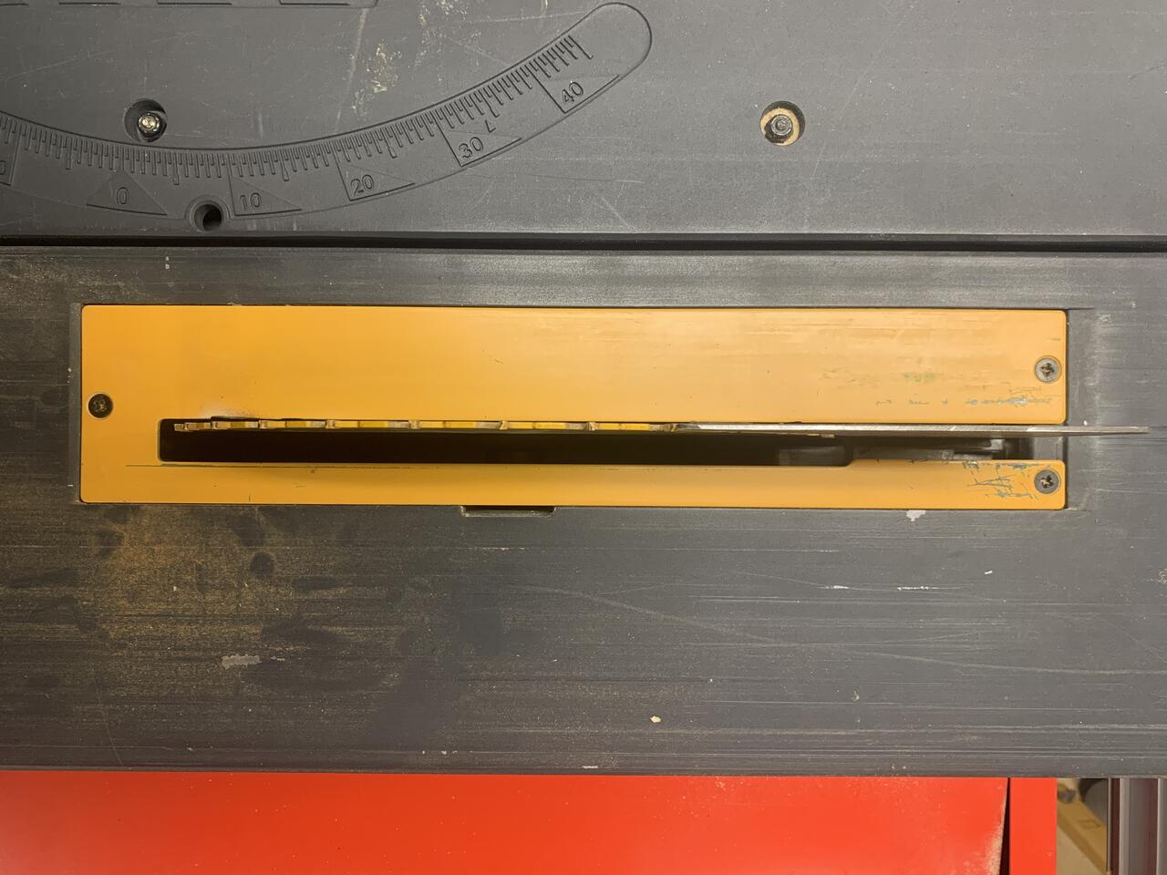

    After my cheap router tables particleboard surface sagged too much, I discovered the router actually has the correct hole pattern for the Craftsman clone accessory table. Using the saw fence didn’t have great dust collection options, so I drilled a hole to access the above the table lift feature and mounted the other tables fence via the miter slots using ‘adjusted’ elevator bolts or miter slot blocks and press fit oak strips into the front of the slots to prevent work catching when crossing. Both the saw and router are plugged into the same vac switch so I only need to switch the vac hose when changing tools.
    I also took the router sub-fence that came with the accessory kit and swapped the pan head screws for flat head. Then, when mounted the sub fence has nearly a 1” depth (1.030 or a 1 1/32”). A swipe of the plane or sander brings it to an exact 1” for use as a stop block for the table saw. Since I use the fence ruler, I can merely add 1” to the needed size.

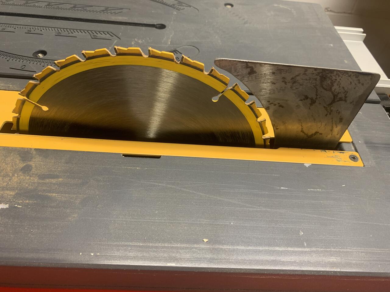

    Edit: Riving knife made from old saw blade.
    Still need to ̶m̶a̶k̶e̶ ̶a̶ ̶r̶i̶v̶i̶n̶g̶ ̶k̶n̶i̶f̶e̶ ̶a̶n̶d fill out the tabletop — especially now that the accessory table can’t meet upto the saw table with the router installed.
