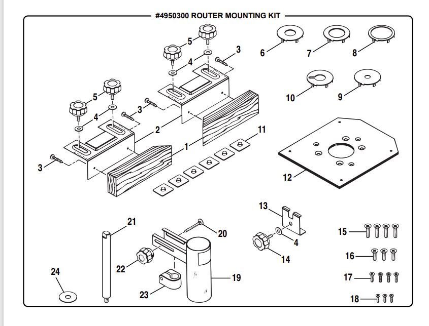

      Like cdjr, I'm also just starting out in router world. I'm curious about your comment that a quality router can be mounted to the BT3000 accessory table as is. The holes on the accessory table are 6 inches apart in a square pattern which doesn't seem to match any of the popular modern routers. So is the idea that this isn't a problem because these routers come with adaptor plates to fit the six inch spacing?

        most router bottoms are only 6" diameter.
        The BT3 accessory table is designed to take a metal plate with two beveled corners. The metal plate is found in the Ryobi router mounting kit 4950300. Read about it in the BT3 FAQ.
        Click image for larger version  Name:	BT3000 router mtg kit picture.JPG Views:	0 Size:	67.4 KB ID:	844569
        The router is fitted to the plate #12 in the picture, then the router plate and router is fastened to the accessory table with four screws.
        Early router mounting kits had a plate with only Ryobi router holes in it, but later versions had a more universal set of holes.for the PC690/Bosch/Dewalt routers and others.

            • 8796
            One WARNING: The vibration from the router causes the router table to come loose from the rail at the rear and then slide. Therefore Parts 13, 14 & 4 for FIRMLY locking the rear of the table to the rear rail is a necessity!
            ON SECOND THOUGHT - I am not sure if that is the locking parts or not, But there IS a separate locking part/knob needed for use with the router table to keep it from sliding during use.

              • 22062
              Yes, 13, 14 and 4 are for locking the rear of the router/auxiliary table to the rear rail... and of course the front rail lock lever that is part of the Aux table should also be locked. This is primarily important when you are using the rip fence as your router fence, having the rear of the table moving around even a little will have you gouging what should be a smooth edge provided by the fence.
              Here is my experience FWIW. I have a free standing router table but at one time I did have a spare router installed in the auxilary table of my BT3 but I used it for bearing guided edge routing... Chamfer, roundover, ogee etc. It was convenient for that and did not require use of the rip fence and mounting all those parts.... When not in use I just lowered the router below the table often with the bit still in the collet. So I did not have to worry about changing my router table setup to use the saw or the saw setup to route. It was handy to just have a router mounted for edge finishing that was easily accessed, quick to set up and did not disturb either the table saw setup or the router table setup. Since the fence was not used, I did not use the rear locking mechanism... straight edges were assured by the use of the bearing.
