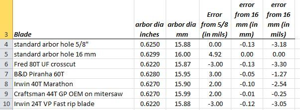

                      I took a quick survey (have a lot more blade but I did the first 5 I found)
                      Click image for larger version  Name:	arbor survey.JPG Views:	0 Size:	34.1 KB ID:	843332
                      basically all the blades were within 3 milliinches of either 16 mm or of 5/8"
                      I think in inches still for machining and measuring although I do a lot of metric. 3 mils is about a typical tolerance for metalworking.
                      I would think they would all work on a 5/8" arbor or a 16 mm arbor.
                      So the vice versa is probably also true for 16 mm blade on 5/8" arbor.
