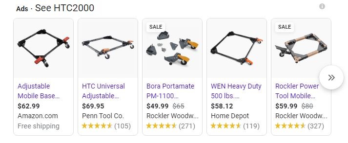

    There are various commercially made devices called mobile bases, low profile, for putting fixed tools on to move them around without raising the height significantly. Some of them have adjustable metal frames and others you cut wood braces to size.
    One is the HTC2000 with adjustable size and four casters that can be lowered to stabilize the tools when parked and used. I have three and recommend it.
    They are available from Amazon and other places for around $70... search for HTC2000 tool base
    You can also do a search on this website sawdustzone for mobile bases; lots of discussions over the years.
    Click image for larger version  Name:	mobile base.JPG Views:	0 Size:	45.7 KB ID:	842118
