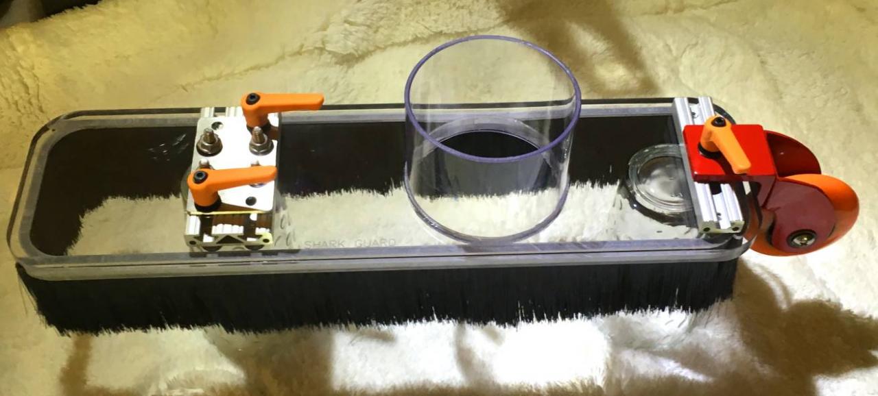

                        Capt, we do make brackets that will allow you to easily attach a shark to an overarm mount that you design.
                        http://thesharkguard.com/overhead.php
                        We are also coming out with a new product. Replacement covers for after market arms. I am shipping the first custom one of these designed to fit a Beisemeyer overarm system today.
                        This one has no hard sides. Just brushes.
                        They cut odd shaped aluminum extrusions that are sometimes bent and they clamp them in jigs and do compound miter cuts on these. The brushes only will work better in their case.
                        The standard ones are still in R&D, but are sort of similar in appearance. They will likely use hard sides, but retain double brushes in front and single in rear.
                        I will post a picture or two later of custom one.

                          #27
                          Here are a few images of what I mentioned above.
