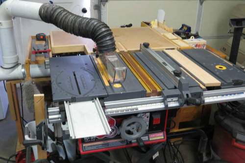

                  I just wanted to follow this up to (like many before me) compliment Lee for being a wonderful guy to work with. I caved in the other night and decided I needed a Shark Guard because my new dust collector has been an underwhelming improvement over my 6.5HP Ridgid shop vac when hooked up to the 21829's 2.5" dust port (really wish that was a 4" port). Not much that port can do about the above table dust (especially with a ZCTP) I suppose.
                  Lee has been super responsive to emails and very helpful with recommendations. He believes he has a riving knife that matches the one above for the 'newer' 21829's. I still need to confirm that against his template though. I'm looking forward to joining the SG club though!
                    • 1865
                    Tim,
                    Lee will add an optional dust port on the SG, you pick the size (will add a few $ to price). Works well for above-table DC. Mine has the 4" port. I split my DC line going to the tablesaw, one leg goes to the 2.5 port on the back, and the other leg above-table arm with flex hose which attaches to the SG. I'll post a pic in a minute.

                            Mine's a whole lot more "ghetto" but it works: I have a y-adapter at the saw, right before the built-in dust port. I then have a 3" flex-hose connected to that, connected to the arm from a swing-arm desk lamp that mounts to my rails (my saw needs to remain portable), which then drops it onto the top of the Shark. The nice thing is that I can still get some minimal dust collection from the top even with the guard removed for certain cuts, and also bend it around to clean up the top of the saw.
