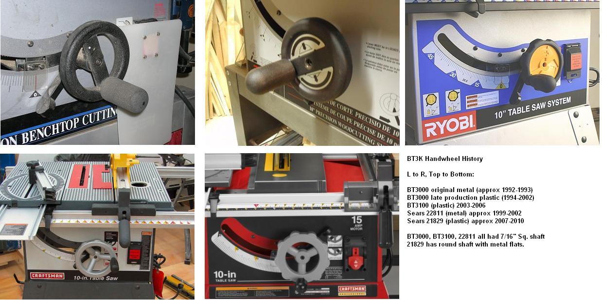

BT3 Handwheel History
    • 22060
    I collected this a couple of years back and never posted it.
    Click to enlarge the thumbnail and see the different handwheels used.
    That's interesting.

      Thanks, Loring!
      Now I can identify my inventory.
        Awesome. Great pics.

          Are most of the Sears parts interchangeable with the Ryobi saws? Or maybe a better question: Are the saws actually the same as far as specs go or do they just look the same?
            • 22060
            most all parts are interchangeable.
            If you don't have it, ask me for my BT3FAQ (sig line, below)
              If you put the metal handwheel on, can you power your way through lack of lubrication of the shims but maybe in the process strip the threads in the motor casting?
                • 9554
                Better off stopping to figure out what is wrong before you power through cranking that handle too hard!
                I must admit I have a certain affinity for the 22811 handle's looks compared to the BT3100s...
