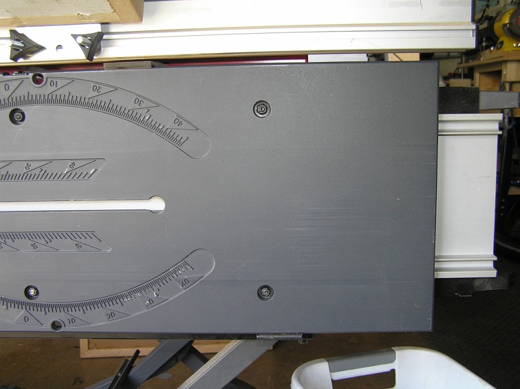

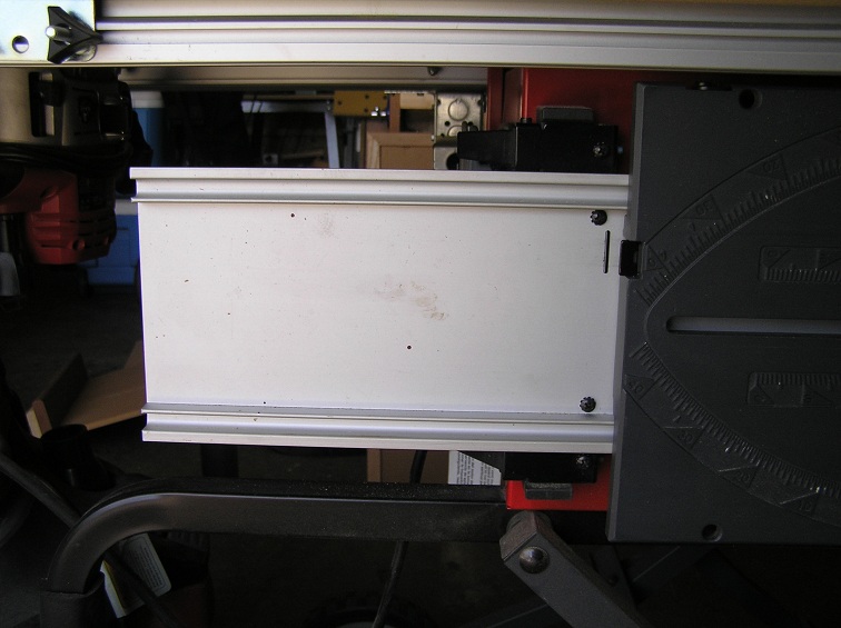

        Here are some pics, two showing holders and clamps, one from side of saw.
        To supplement instructions from Cochese - with the SMT properly oriented on the rails, first lock the SMT table into rearward position on track. Unlock the rail clamps, front and rear. Take SMT to rear of saw. Place table into plastic holders with the rail portion aligned so the front clamps will position over the small plastic/rubber blocks - lock the front rail clamps onto these blocks.

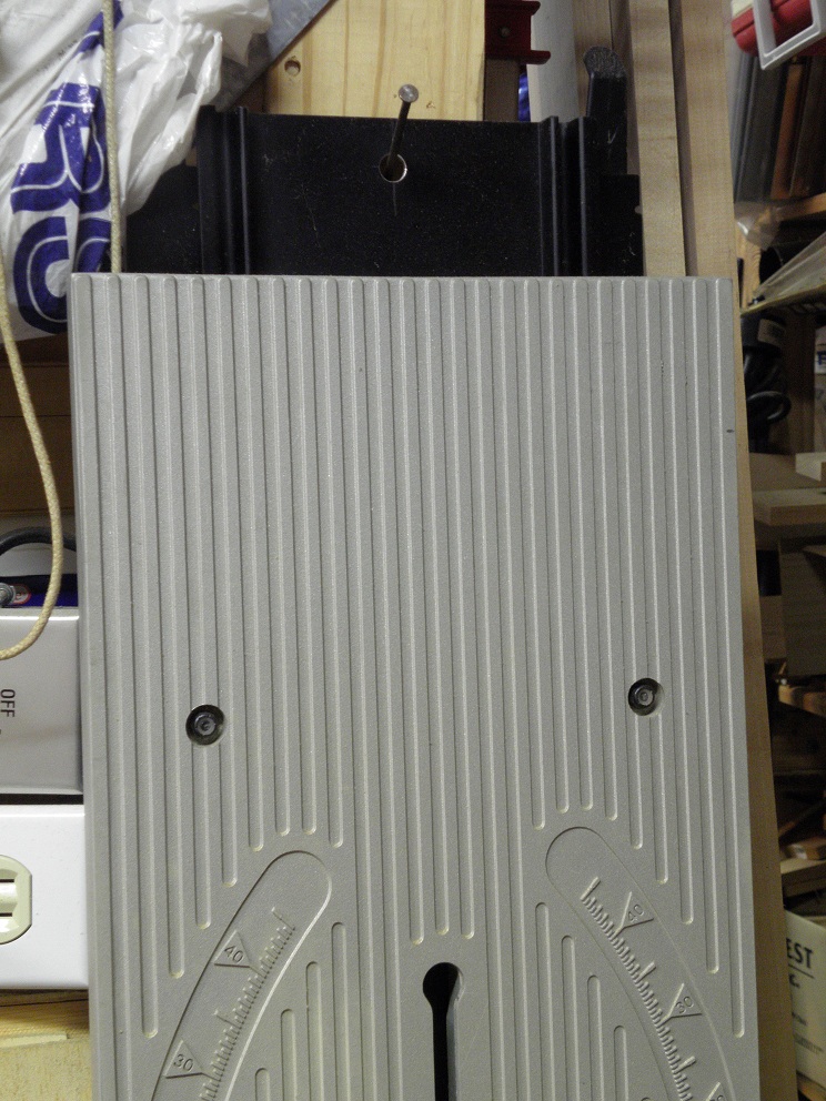

            I drilled a 1/2" hole in the stationary rail and hang the assembly on the wall.

              You mean like this? My Spare's been on the wall for years.
                Exactly like that except that it's my primary SMT.
                Just can't give up the 'old-school' miter gauge and sled.

                  I just bought one of these and it was a challenge to figure out how to store miter table. I'll have to look at it again tonight but mine has an added challenge. In Bill's last photo the clamping bar (vertical silver square bar to right of clamps) extents above the rails so I need to slide the table under the rail first. After a few tries I'm getting good at it.
