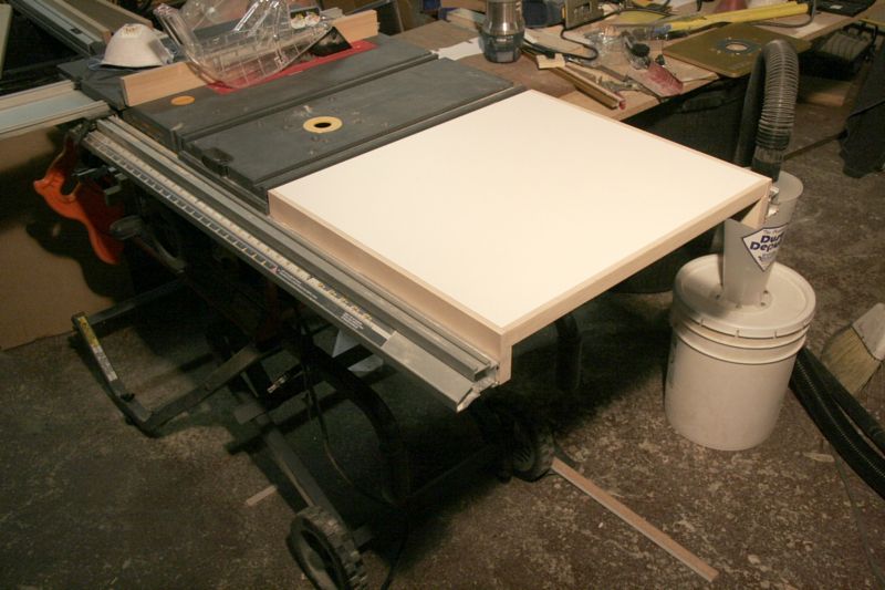

    Certainly lots of great feedback here on router table tops. I'm learning a whole heck of a lot. While online last night at Home Depot, I saw they have 1 inch thick melamine coated particle board designed for workbenches. I actually have a number of melamine boards around the shop, and went around checking various pieces with a straight edge. , All of them seem to be completely flat, which is more than I can say for the un-coated particleboard, and MDF is a joke. I hate that stuff!
    So, I picked up a small 19.5" x 48", sku # 339928, and I think it was under $15. Comes in a cardboard box, so it's well protected. Totally flat out-of-the-box. All of the edges and top and bottom were coated. So, made up some maple supports for the sides, and we'll see how this works. With a large router plate in the middle, there doesn't seem to be a whole lot of room for ribs or supports. Second, how well is particleboard actually going to hold screws to keep a piece of angle iron secured?
    Tomorrow, I will rout out the section for the Incra router plate. Speaking of which, I'm thinking of offsetting it, similar to the stock location. Maybe about 9 inches from the front edge to the center. Anybody have any words of wisdom on router location? Seems like the closer it is to the center, the harder it would be on the back, and outstretched arms get fatigued pretty easily trying to keep pressure against the stock. The only plus I can see to centering the router plate is it's easier to use if you're using the table from the end or saw. Most of the time I think I'm going to keep my extension table closer to the saw blade. Seems like it would be less stressful on the rails in that location too.

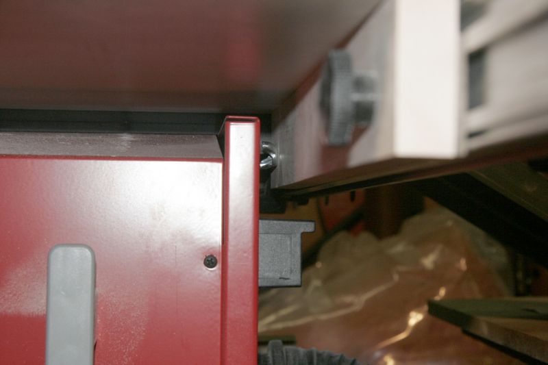

    For anyone contemplating an extension table like this, the only problem I ran into was not having enough clearance between the back rail and saw for the one of the plastic knobs used to fasten the support pieces to the rails. |See photo. I just switched over to a wing nut here. Seems to work fine.
    Here's a few pictures of the project in progress, who doesn't like pictures!
    Cheers,
    Troy

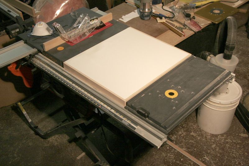

        I normally work on my router table from the end, so I centered mine. I kind of like it centered in order to have more outfeed support. My knockdown outfeed table for the saw makes for plenty of infeed support for the router.
        Before I added the half rails to my 21829 I had to break down the router setup to use the saw all too often. Having the router table as far away from the saw makes things easier for me. I also like keeping the 21829 accessory table to the right of the blade. The SMT can be easily swapped out with it when required.

          You mentioned you had to break down the router set up to use the saw. I assume that you are not using a removable plate? I plan on using the Incra aluminum plate, and will be removing the router when not in use to keep the weight off the table (and hopefully keep it flat).
          As to more outfeed room, I guess it's also the opposite if you're using the router from the front and the router is offset (closer) to the front. Of course it's just the opposite if using the router from the end. I also plan on using the incra positioner (25"), so that would have to be turned around to use a router on the end of the bench.
          I certainly see your point about the SMT being easier to change out, although loosening four knobs for the small extension table is fairly easy too.

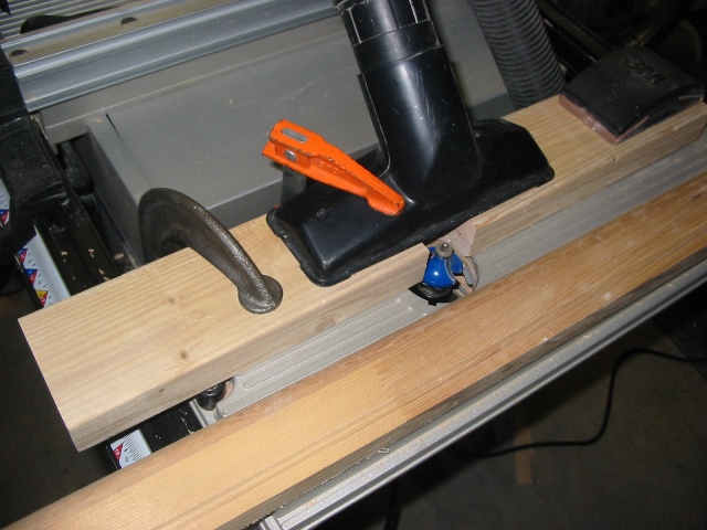

                  My first router fence.. A high tech solution including dust collection..
                  hammer tap micro adjust..
                    I like it. Simple and it works. I like the idea of using the vacuum head.
