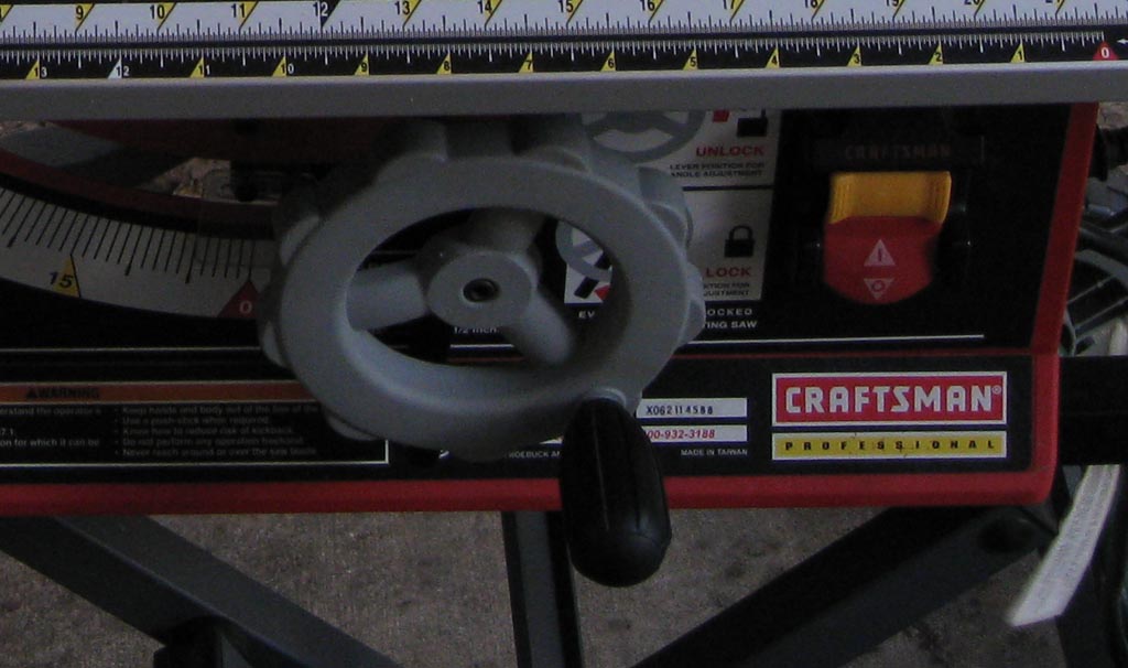

                    That one looks like the 22811, as the 21829 is wider/fatter.
                      • 9551
                      That looks like a 22811 hand wheel... Mighty good looking too. Have I mentioned I hate the yellow center on the BT3100 hand wheel?

                        It's much beefier than the OEM.

                          This is a shot of my 21829 wheel:
