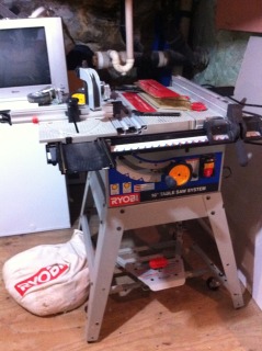

    So I have "Lurked" on this site for a while and finally tomorrow morning I will have reason to quit stalking! I am picking up my first BT3100.

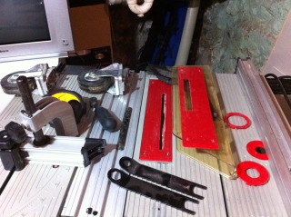

    Attached are the CL pics and it looks like it is in good condition. Anything I should look out for when I go to pick it up other than the shim issue?
    I'm paying $225. I think this is a fair price.

    I'd say that's a very fair price, since it appears to be complete. Make sure the aluminum router mouting plate is included, and make sure there are no audible or visible issues with the motor/blade, and that the fences and SMT don't appear to have been abused. I paid $175 for mine a couple years ago, and it literally had only a couple hours' use on it.
    A good tip regarding abuse is checking to see if the latches for the SMT are intact....
      That's a good price. There are quite a few extras included.

        looks like you also have the contents of the accessory kit that was available for the saw, which retailed for $99(?) by itself. enjoy your BT. just beware that it's a right tilt. it's possible to catch the workpiece between the blade and the fence when bevel ripping wide material.

          It does come with some extras. It comes with the 8 piece accessory kit ($100) as well as a Herc-U-Lift he said he paid $75.
          I did not know that this was a right tilt saw. Good to know.

              Is that a Herculift on there, also?

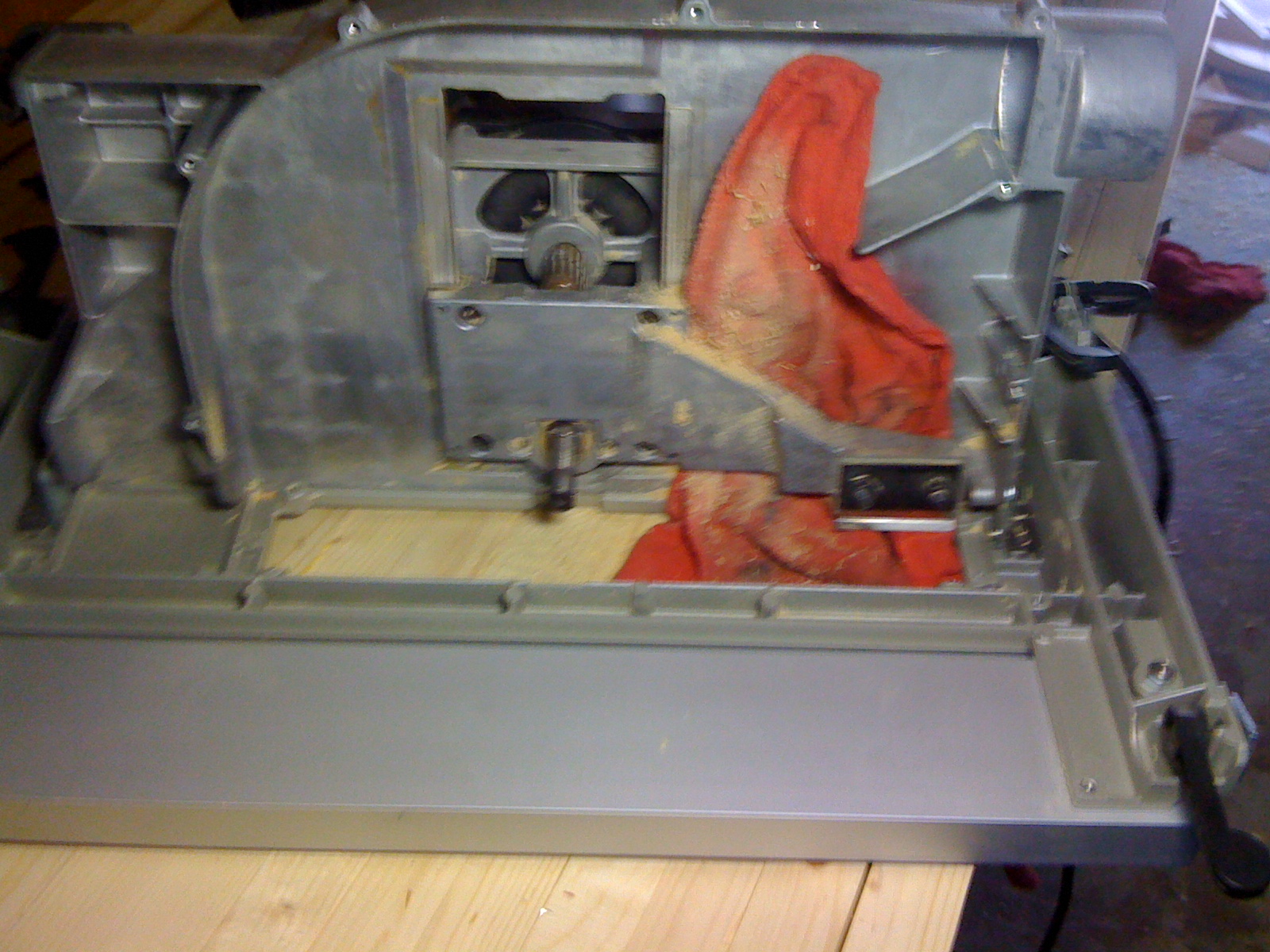

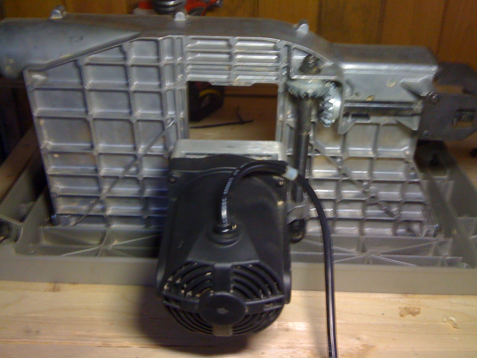

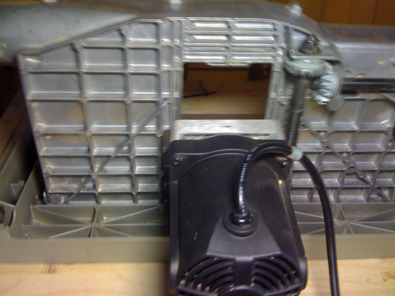

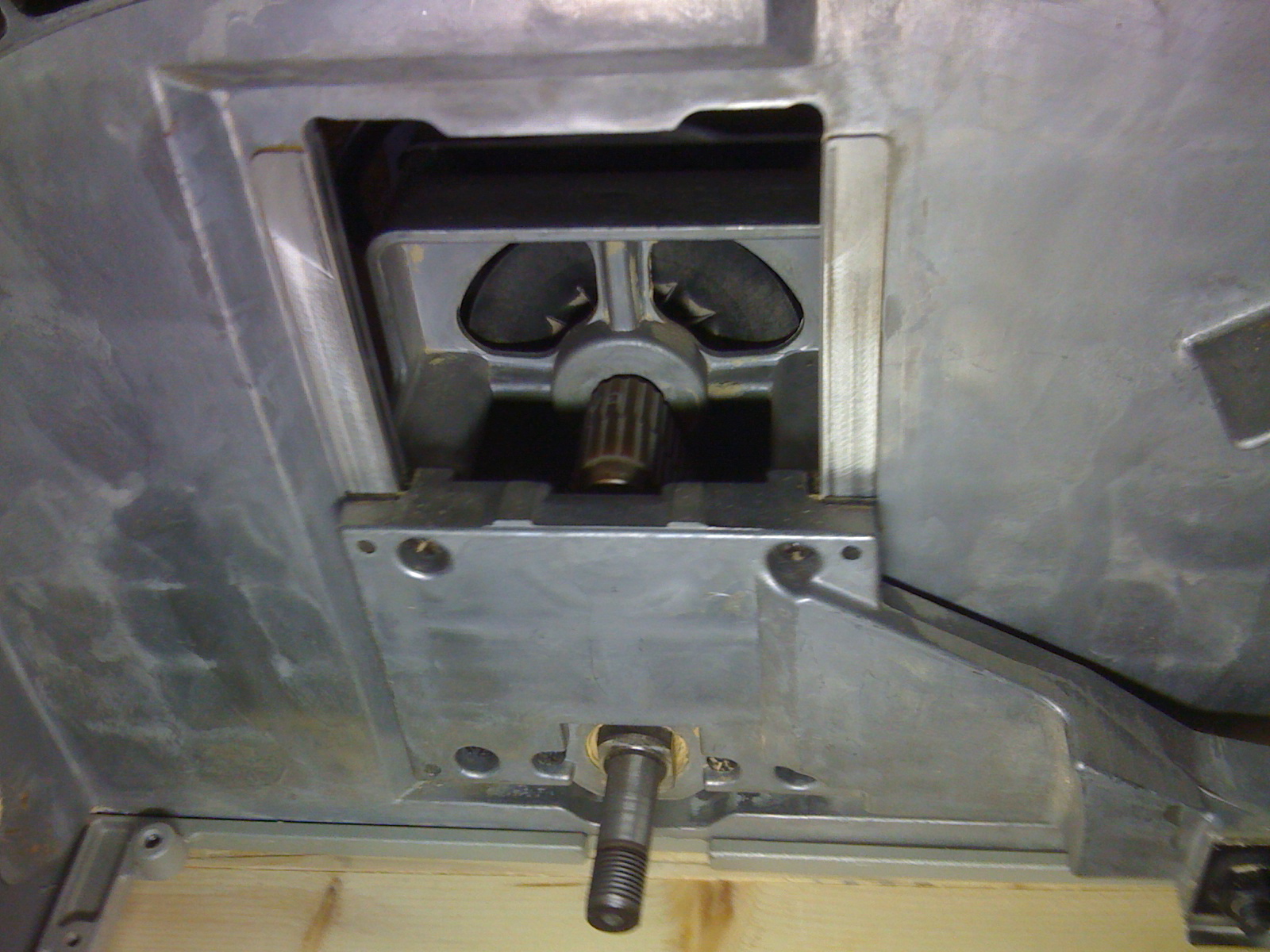

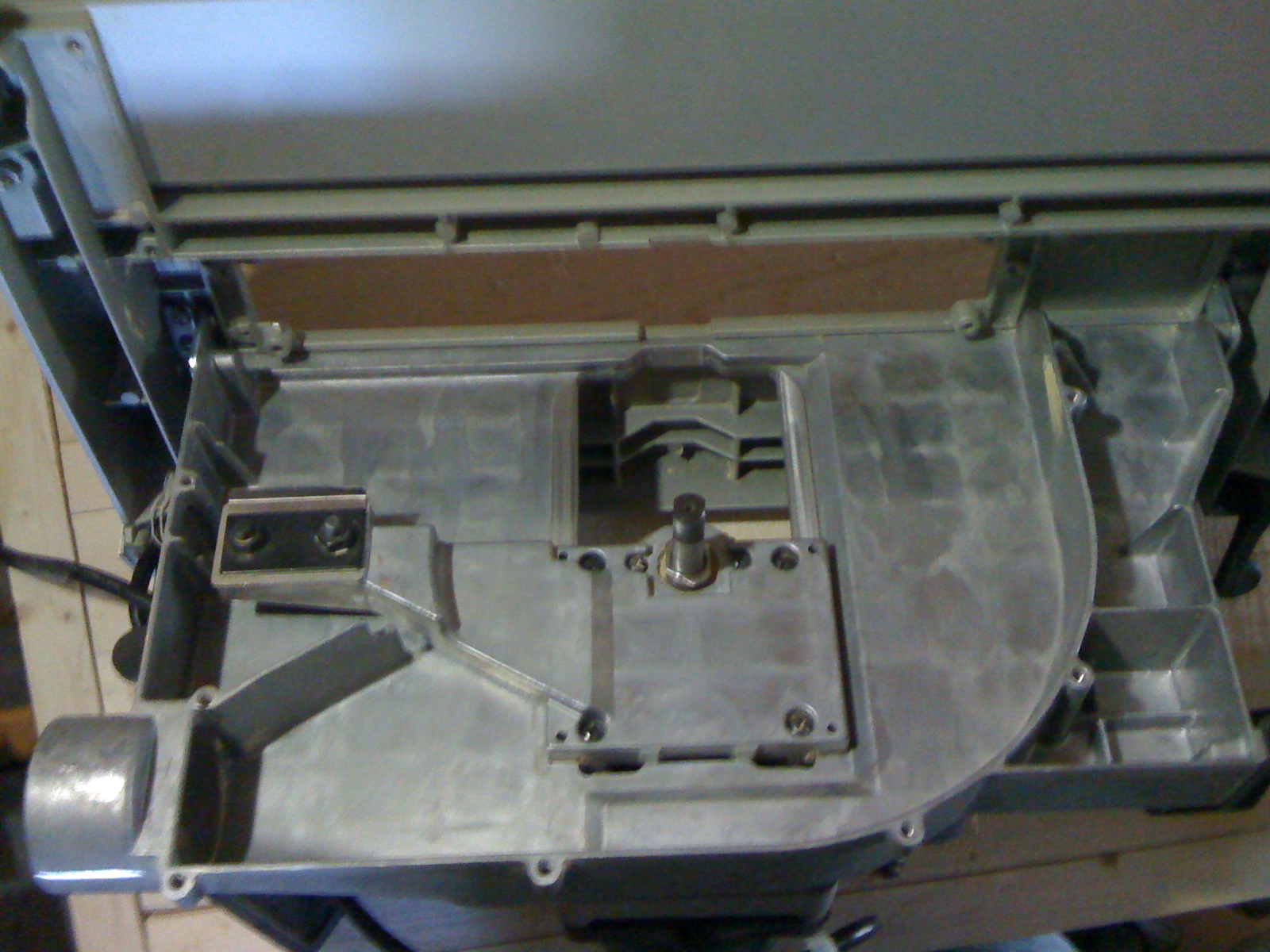

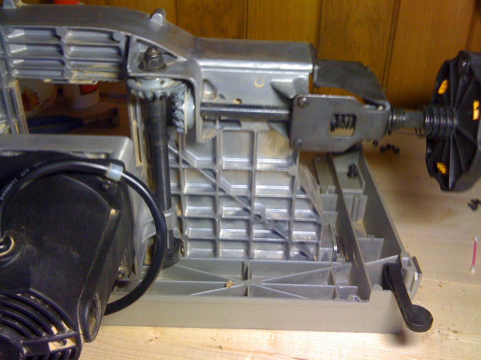

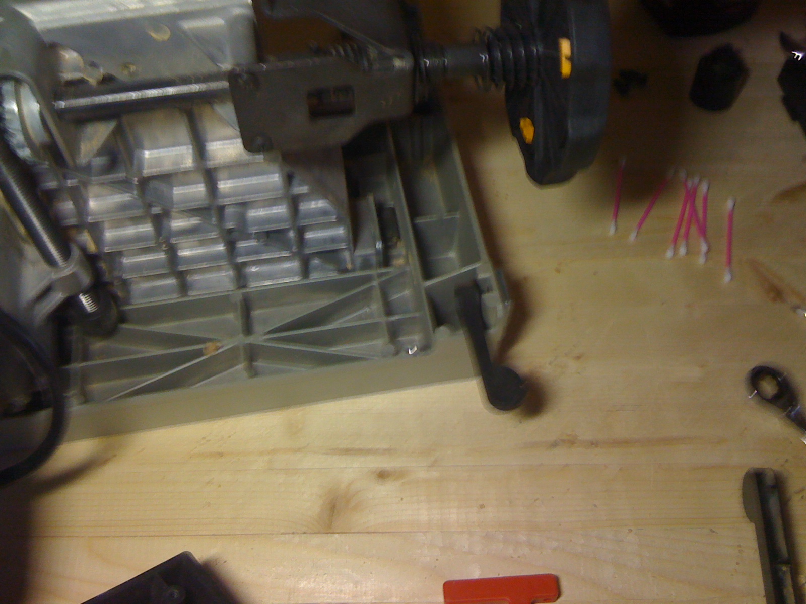

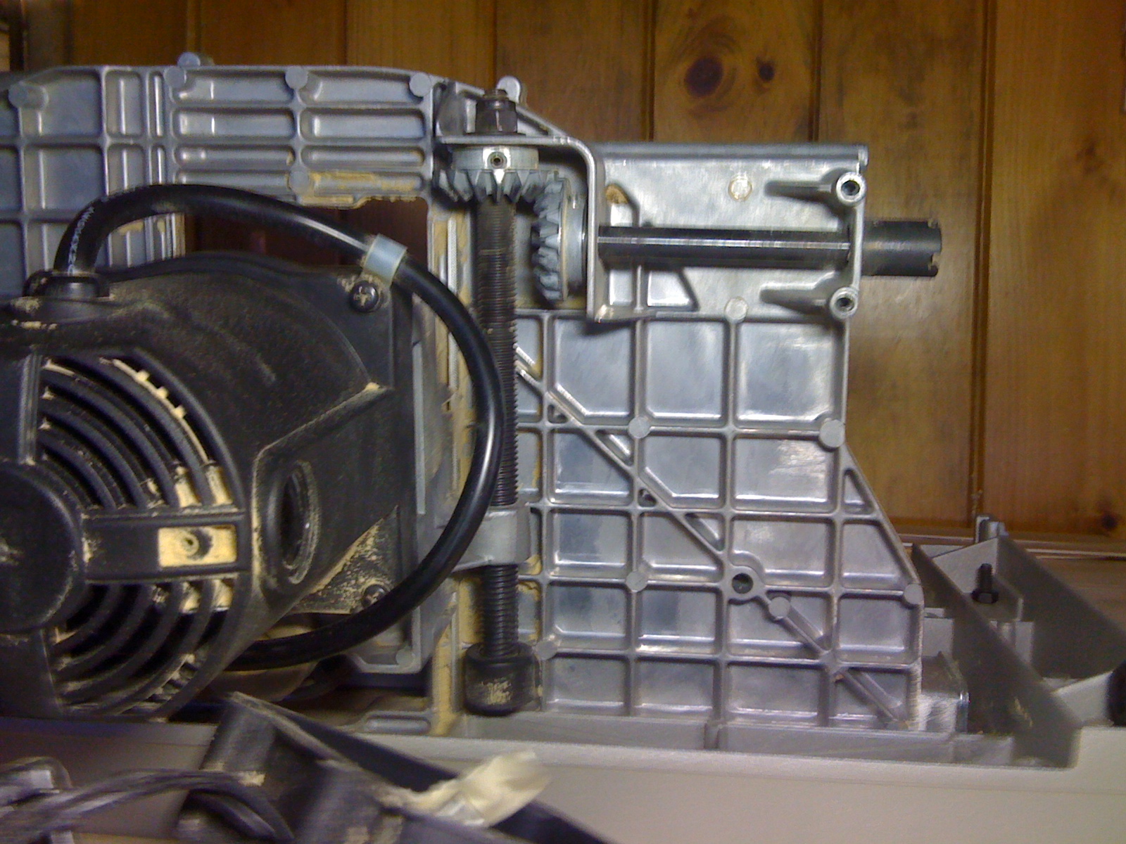

                      Ok so I decided the best way to figure out what was going on was to take this thing apart. I cleaned the heck out of this saw however it was dirty but not extremely dirty.
                      I cleaned the rail that the saw elevates vertically on however it still really difficult to spin the adjustment wheel. If I were to use the nob on the wheel I believe it would break off! I have it completely taken apart and can see that I am not going to break anything but it just doesn't seem to be working correctly.
                      I do not want to remove the motor and mess with the belt but I am afraid that I need to so I clean track that sits on the rail?
                      Thanks
                      Greg

                          It doesn't look too dirty, and the crown gears look to be in good shape. Try some lubrication on all the moving parts & mating surfaces. Especially the height adjustment screw. I like using just paste wax. You should be able to clean & lube everything without taking the motor off. Lower it all the way and do one portion, then raise it to do the other.
                          Clean the crown gears with a brush & lube all those mating surfaces and any shaft connection. Cleaning & lubing all the sides where the saw slides up & down on the shims makes a big difference. Cleaning & lubing the main height adjustment threaded rod is the biggest thing though. I like holding a shop towel around the rod and then operating the height adjust wheel to clean it, then loading up a towel with wax and doing the same to lube it.
                          There are some good threads on lubrication and height movement.

                            LChien sent me the FAQ list last night. I have read through them and this is the reason I decided to dissemble the saw and thoroughly clean it.
                            Does the elevation of the blade tend to be difficult to change? Cleaning did fix the wheel so I could tilt the saw without resistance.

                              Sounds like the lever that changes the crank action from blade elevation to blade tilt is doing something funny. If everything else is ok that is about the only thing left to look at.
