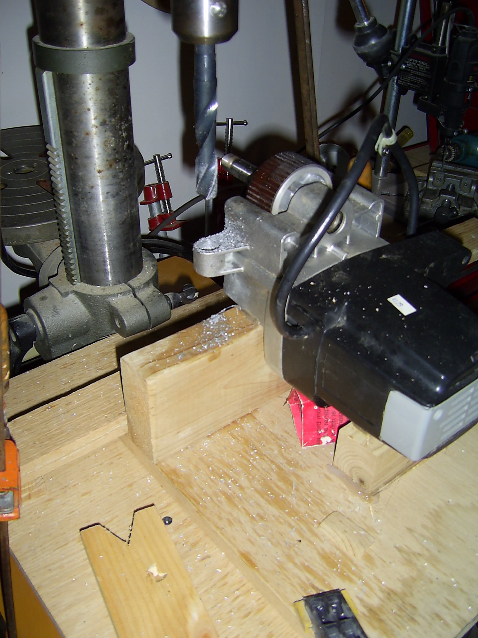

    So after the flu, holiday season and a lot of procrastination I have finally gotten around to fixing my saw.
    Getting it apart was not hard except for the roll pin at the base of the shaft.
    I made a jig to hold my motor square to the drill press and drilled a hole to accept the helicoil insert. Aluminum is very easy to drill .
    Next will tap the hole.

      don't forget to use a cutting oil (probably any oil lube will work) when tapping the threads in aluminum. Also don't forget to back up frequently (maybe every half turn or so) to clear the threads.

        Thanks for the advice. I used WD40 and backed the tap off often. It seemed to go easily. Insert went in and the treaded shaft fits.

            Saw is back together and works better than it has in a long time.
            I put a new switch on it and spent a bit of time squaring the sliding table and miter guide. Don't remember the last time I did that.
            I am happy with how it turned out and want to thank everyone for their encouragement and guidance.
