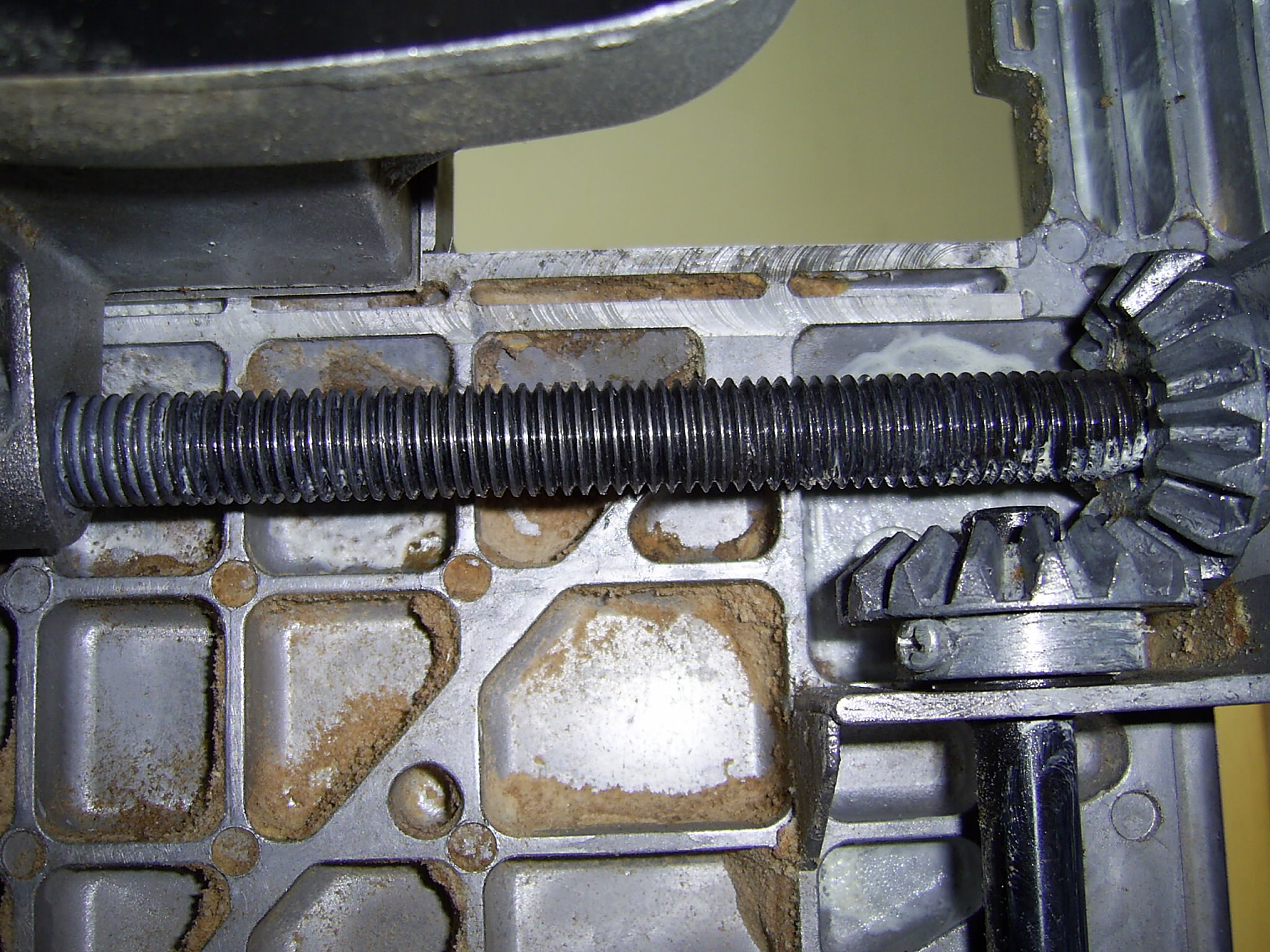

            Here is a photo of the threaded shaft with motor raised.
            I can't see a problem but maybe one of you can.

                A few of those threads in the middle portion of the shaft look to be slightly flat. I suppose if the aluminum threads are worn too, it might be slipping on those worn threads on the shaft. You did mention that the dropping happened in the middle of the range.
                You might get under the saw and start lowering the blade to see what is slipping. I've got a feeling that the aluminum threads are worn, and you'll see the blade raising arm slide down over those worn threads.
                  Like Erik suggested, watch from under the saw as someone lowers the blade for you. If you continue to use the saw without fixing the problem, every time it drops the damage is going to get worse.

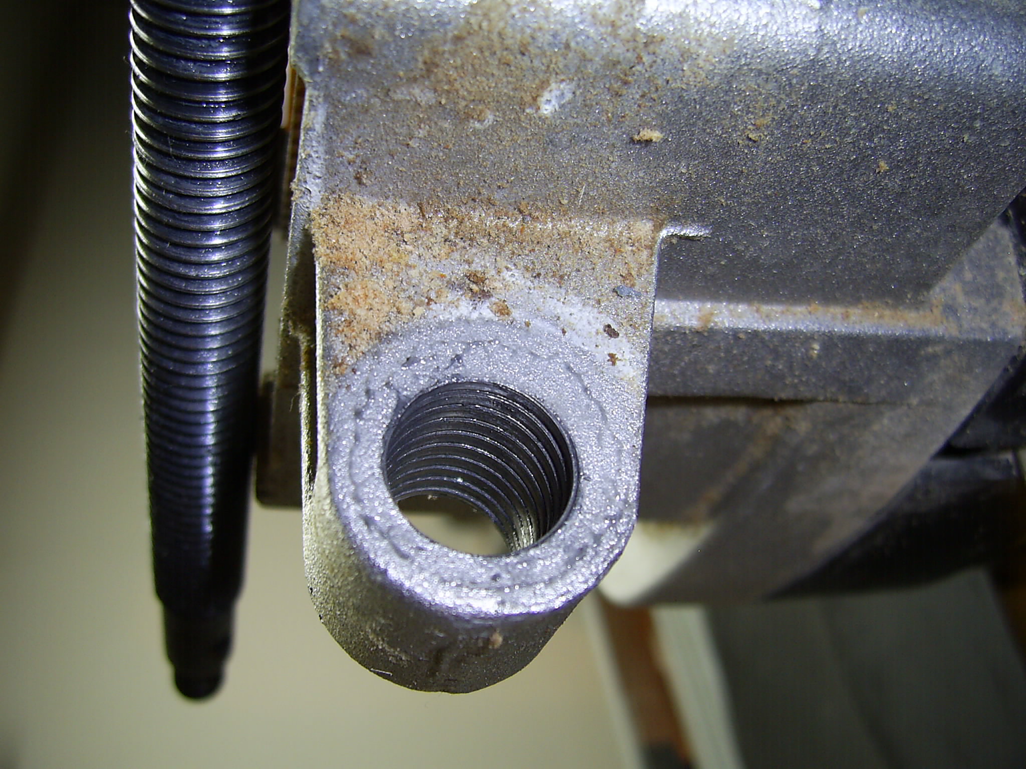

                          I finally got the motor out of the saw. Once you've done it it doesn't seem so difficult.
                          Sure enough the aluminium threads are stripped. Have a look at the photo.
                          Now I am off to find an insert.
                          Thanks again for your help everyone.
