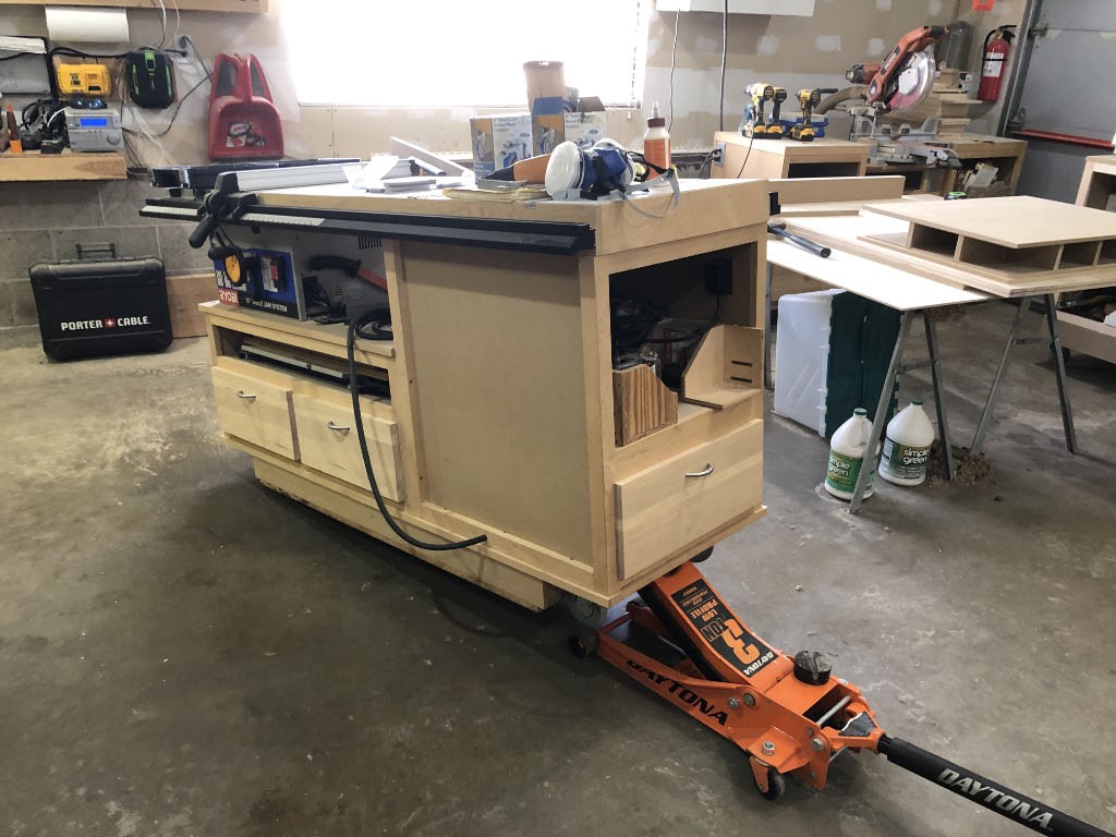

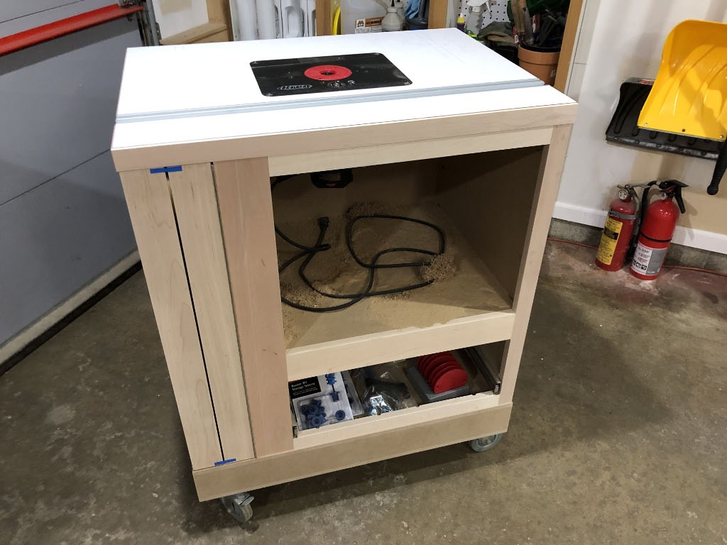

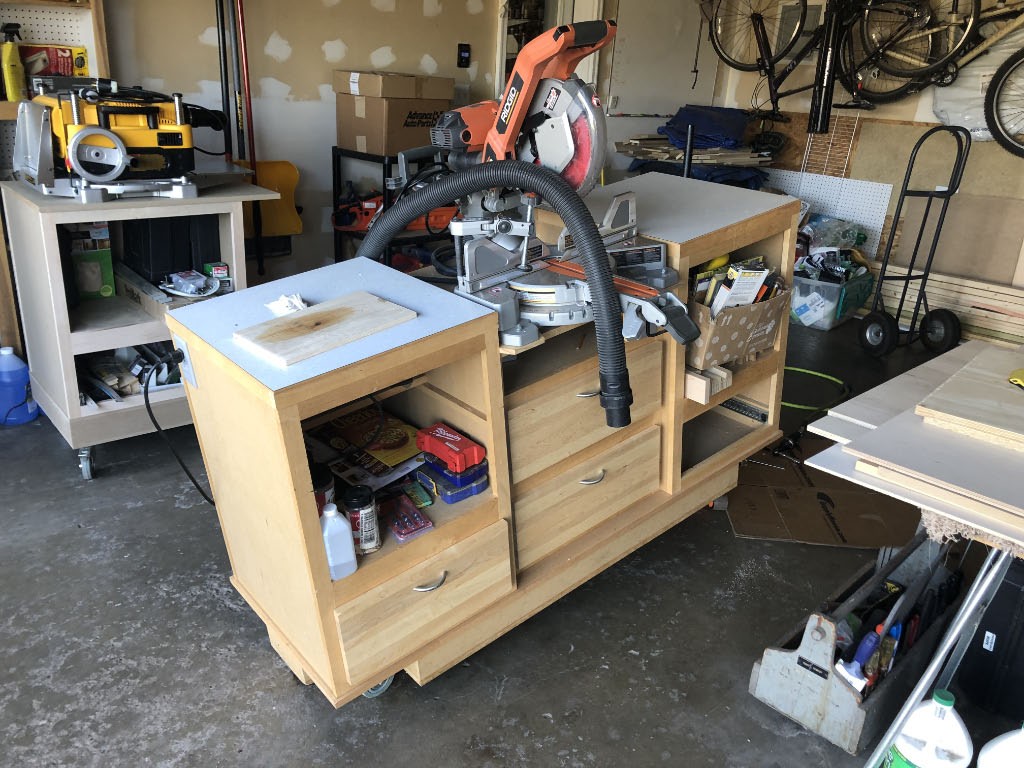

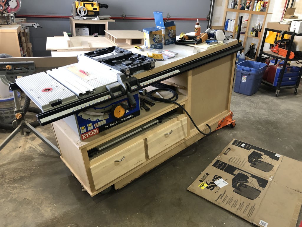

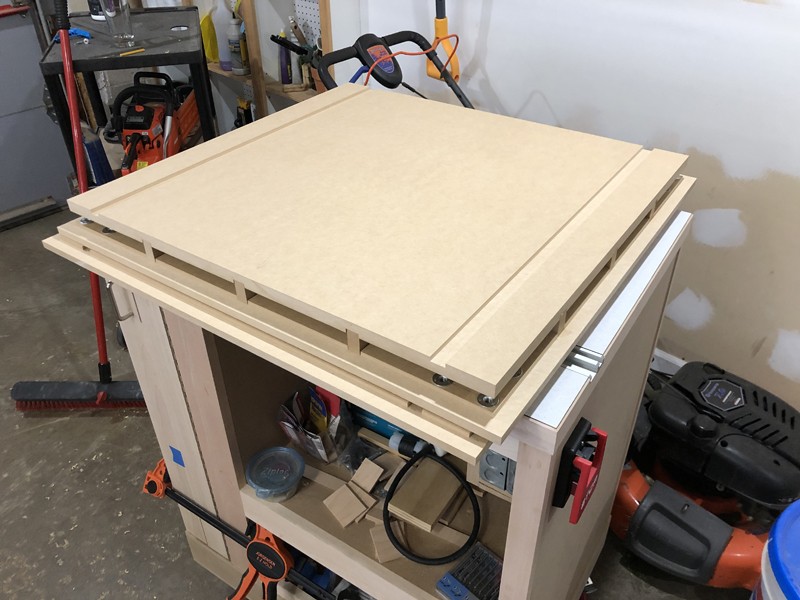

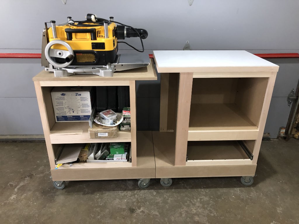

      I started on the router table over the winter and needed some casters so I decided to upgrade the rubber casters on the big saw tables to urethane and then re-use the rubber ones on the router table. I also took the opportunity to relocate the casters underneath the torsion box. Doing so reduced the dip in the table saw base to almost nothing. Made for an odd sight too:
      That brings both of the original saw tables up about 4" to my preferred new working height. I already like it better. Router table build pics next.

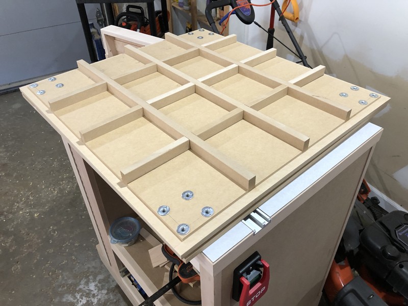

        #63

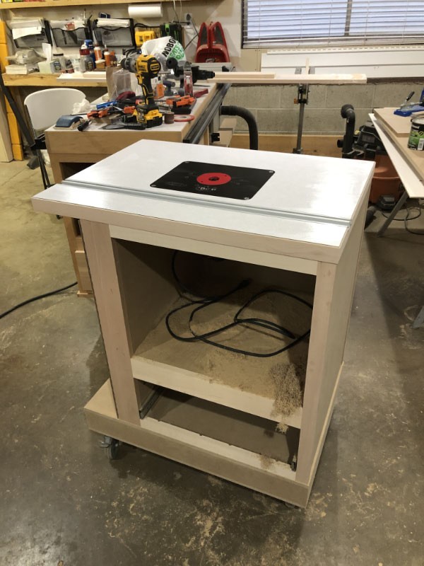

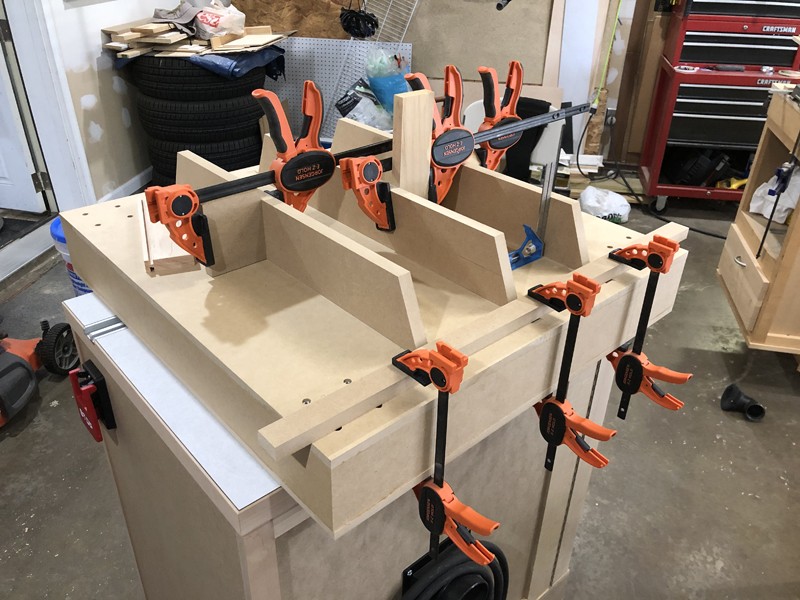

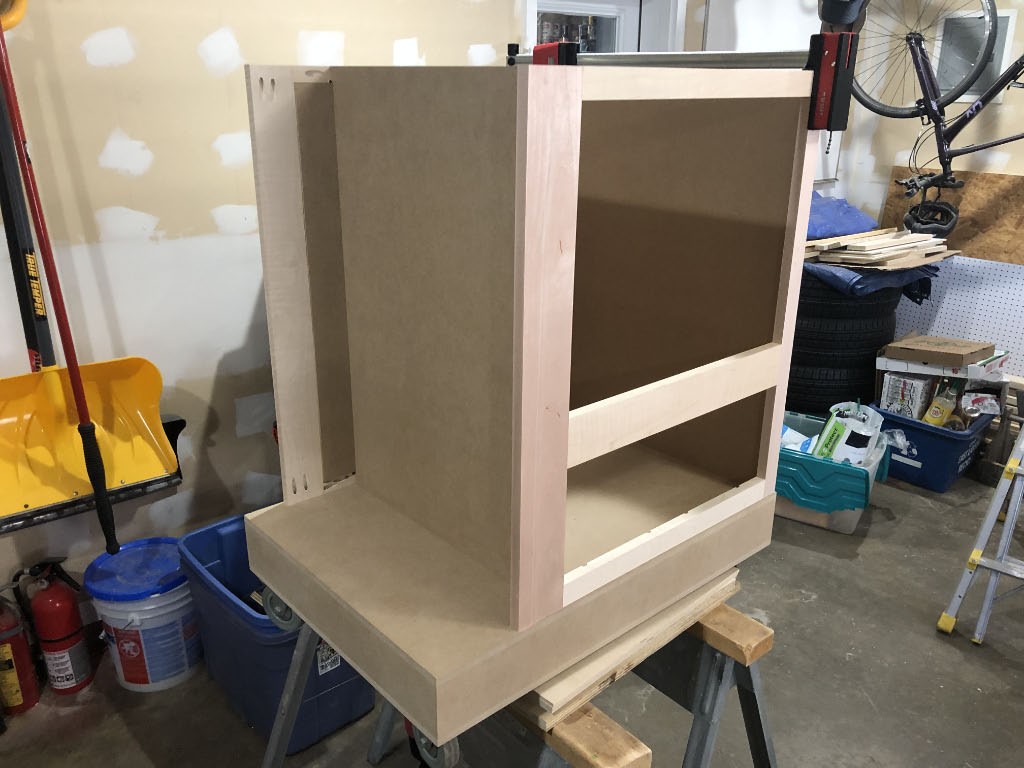

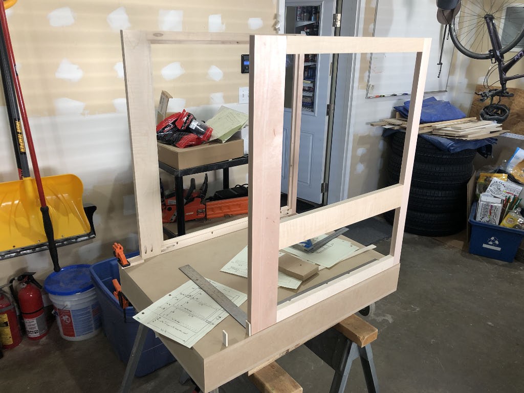

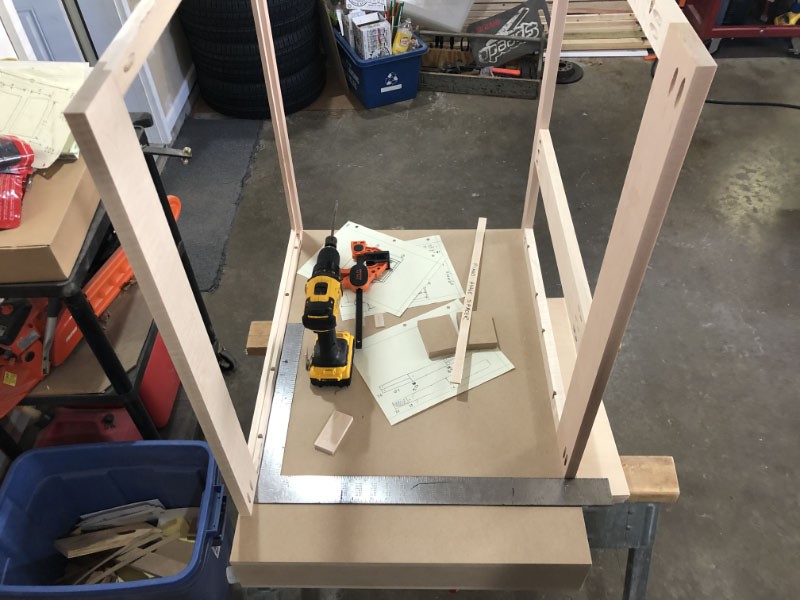

        OK here's the router table build. This is essentially the same dimensions as the planer base, but a mirror of it, and I decided to do storage doors on the left, nested together. It required some careful measuring to make sure that the doors closed together correctly, and I'm really happy with how it turned out.

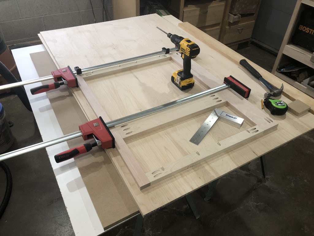

        Torsion box base build was exactly the same. Here's the face frames going together:

        I started running out of pocket hole real estate and mis-drilled a couple so you can see some oopsies here.

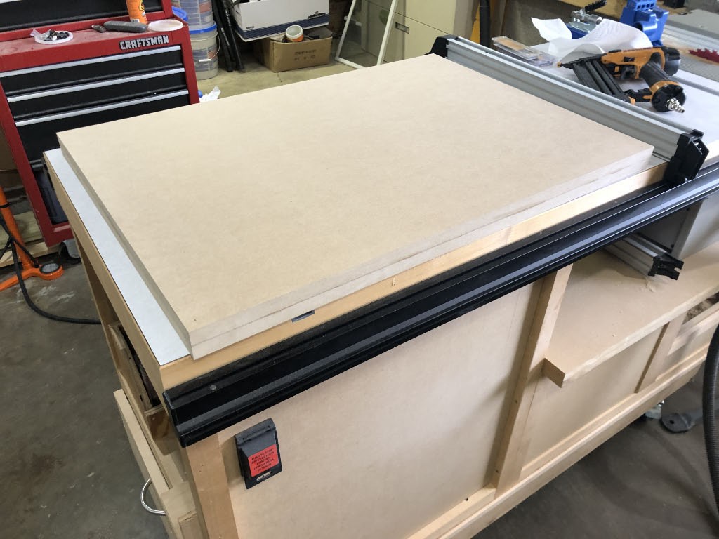

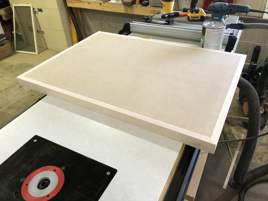

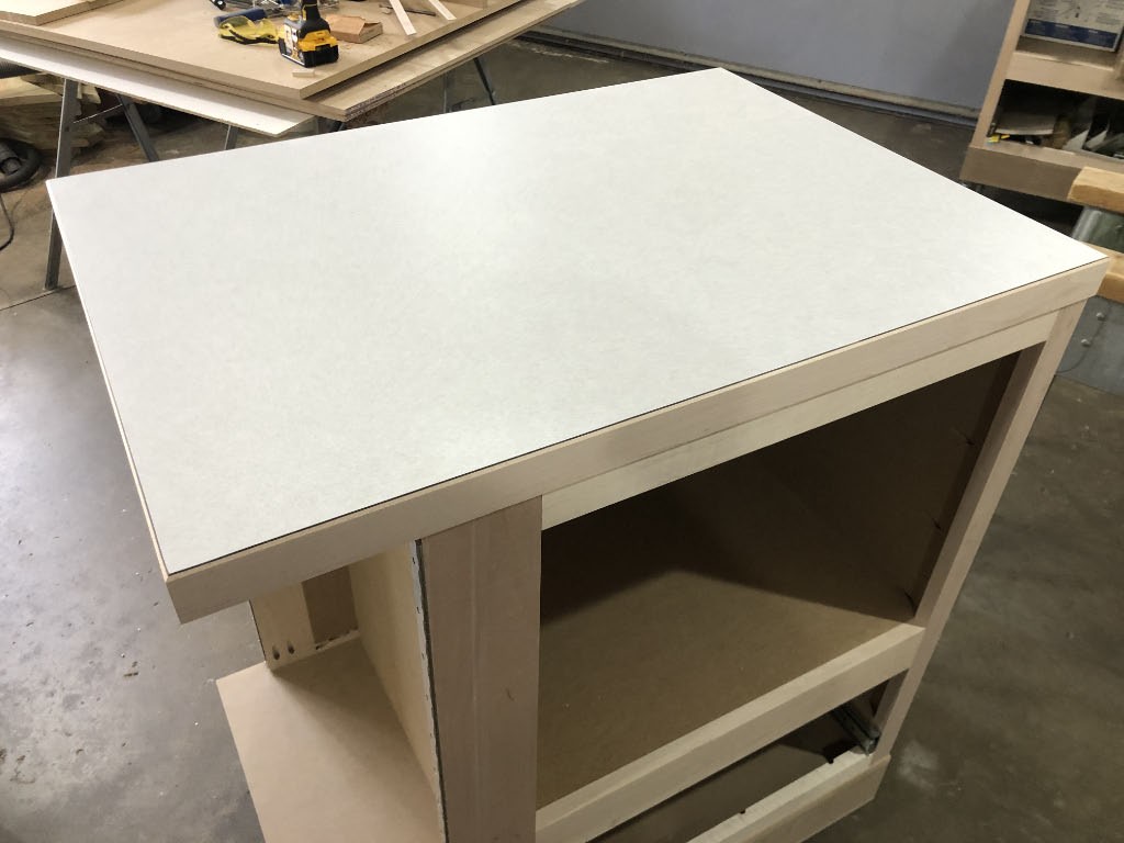

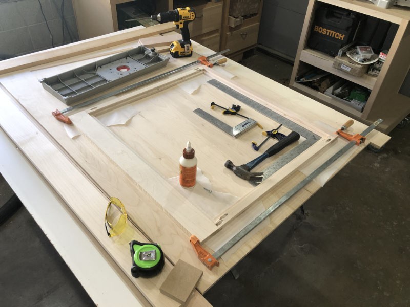

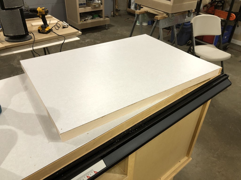

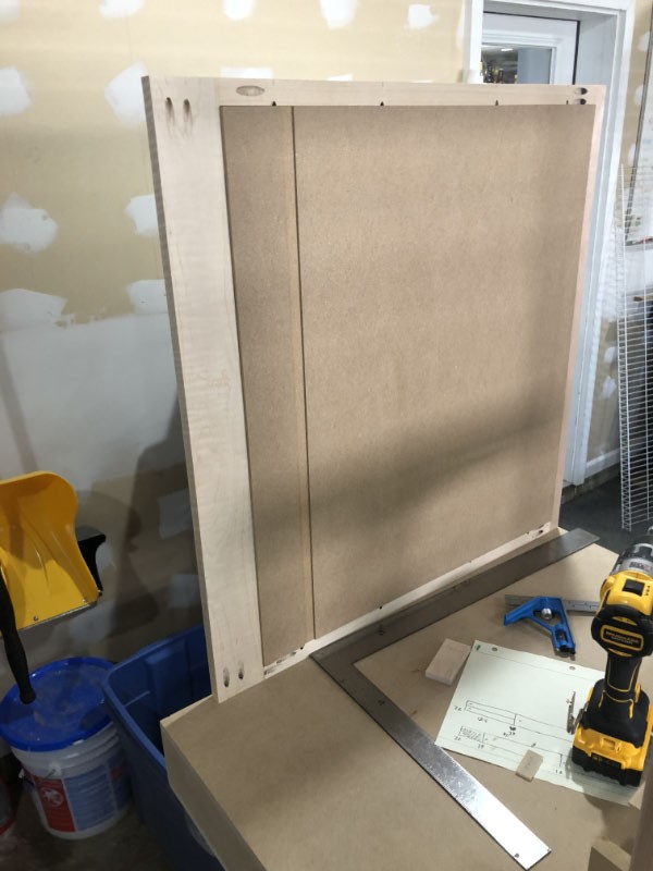

        The top is constructed much like the one on my BT and CMS bases, 2 layers of 3/4" MDF wrapped in maple (thought I mitered the corners this time):

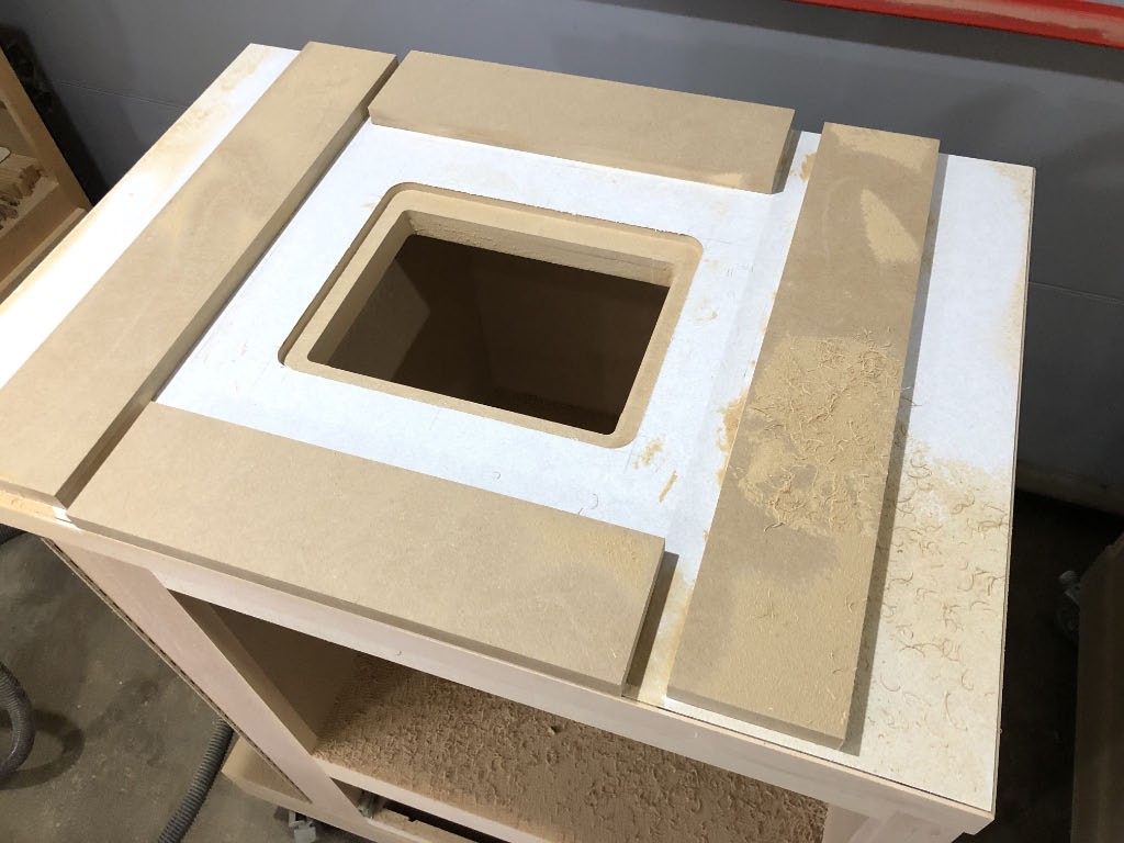

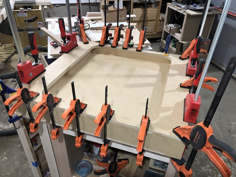

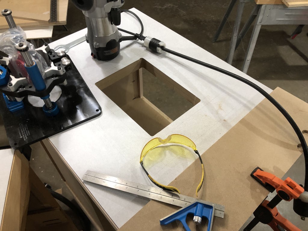

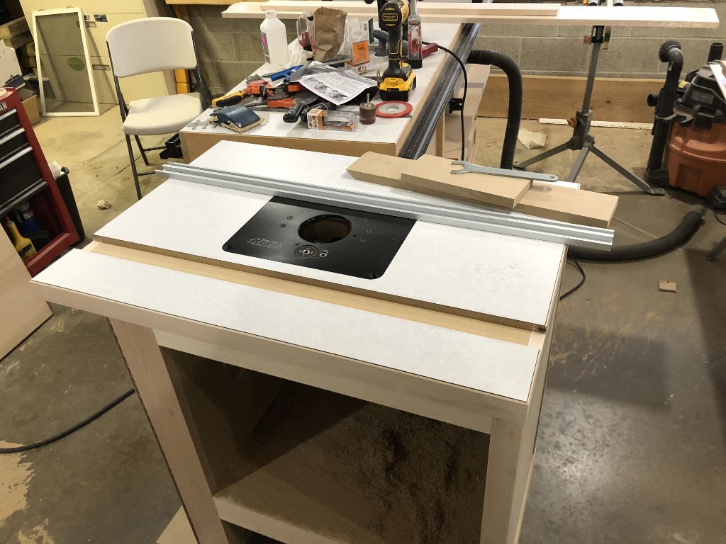

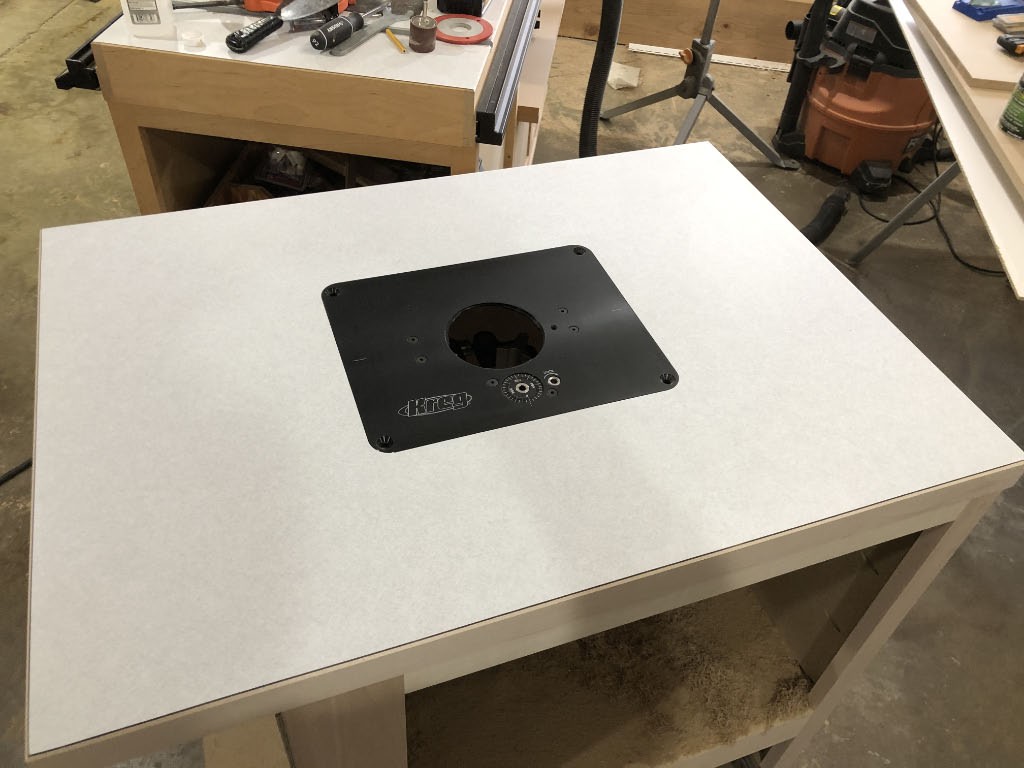

          Now to chop up the top for the router insert, using essentially the same procedure as when I added the router insert to my BT table top at the beginning of this thread (still just as nerve-wracking):
          The rabbet (on account of the way I chose to route it) required a 1-1/2" straight bit. It was a monster.

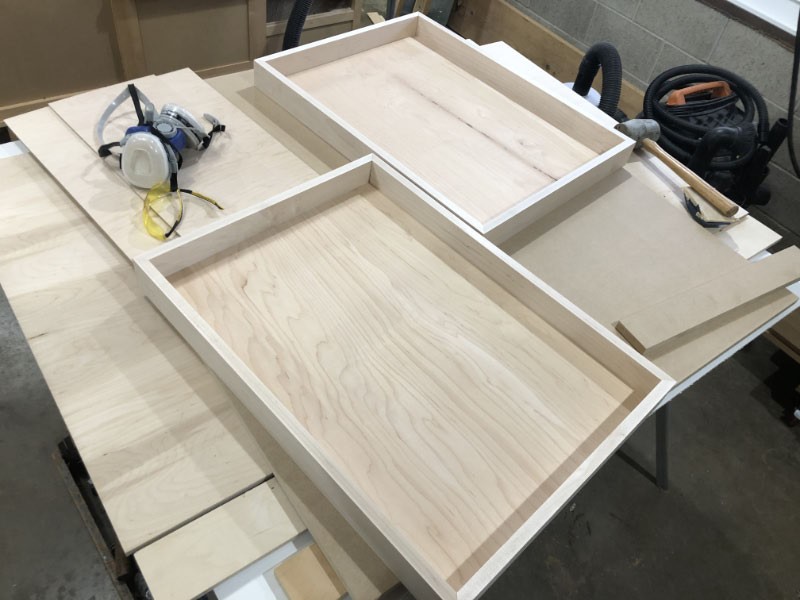

          Now for the door construction, which is basically like building drawer boxes but with mitered corners:
          (I reinforced the corners with biscuits)

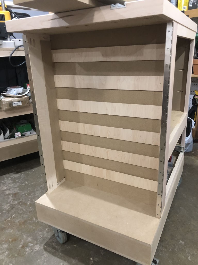

          I decided to use french cleats to give me some storage flexibility. The cleats were ripped out of 1/4" MDO maple to help stick with the same materials as the rest of the cabinet:

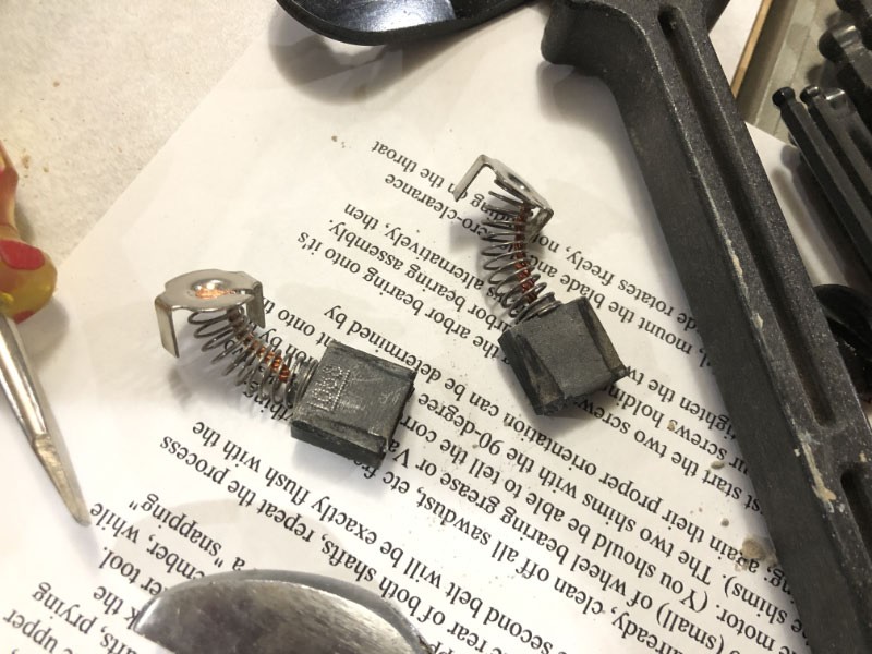

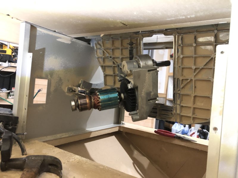

            I'll interrupt the construction narrative for some major surgery on the BT. It would not turn on and, as suspected, carbon build-up was keeping one of the brushes from seating properly. Cleaned it out and it's been fine ever since (I wish I could say the same for the elevation rack).

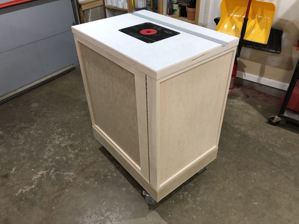

            So here are the cabinet doors installed. The inner door is held in the closed position using rare earth magnets epoxied flush with the outer edge. I will use a mechanical latch or clasp for the outer door. I haven't decided yet what style to use.

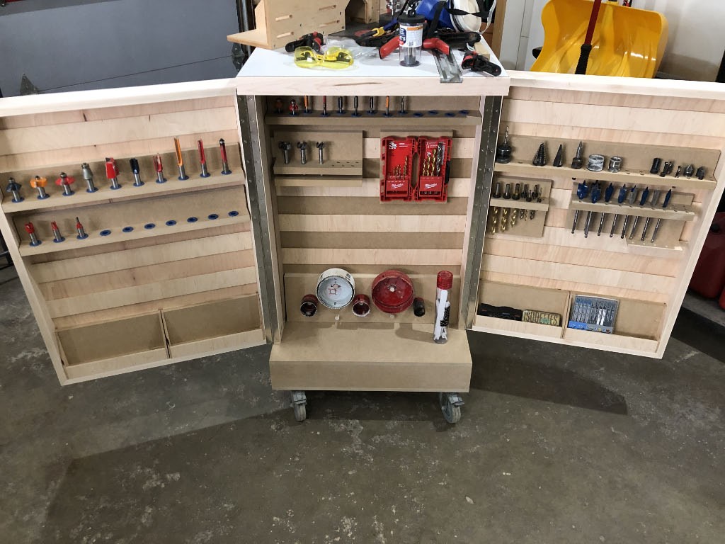

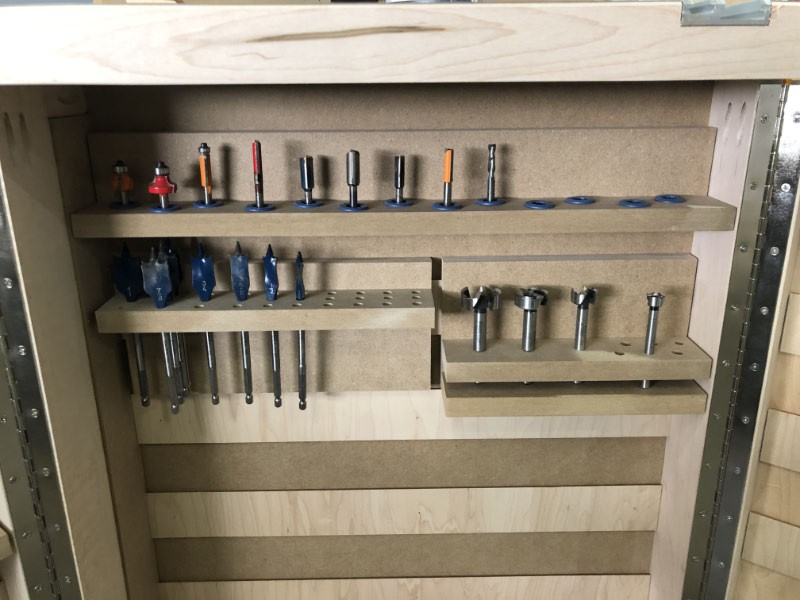

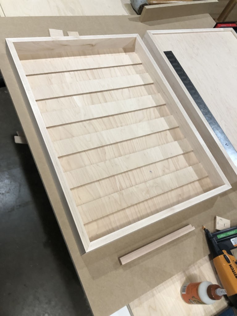

            And here's the first batch of storage "units" after spending a day or so trying different construction methods
            The plan is to store drill bits and saw blades of all types in this cabinet:

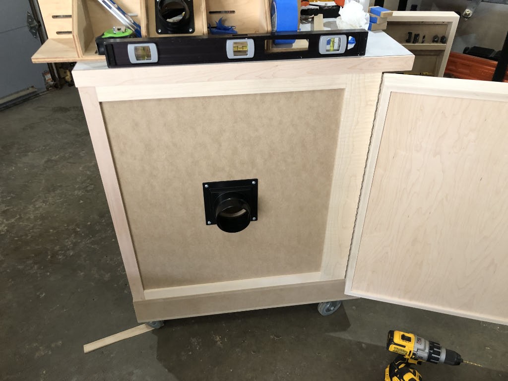

            DC port on the back. This is from Rockler:

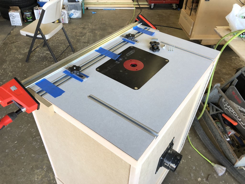

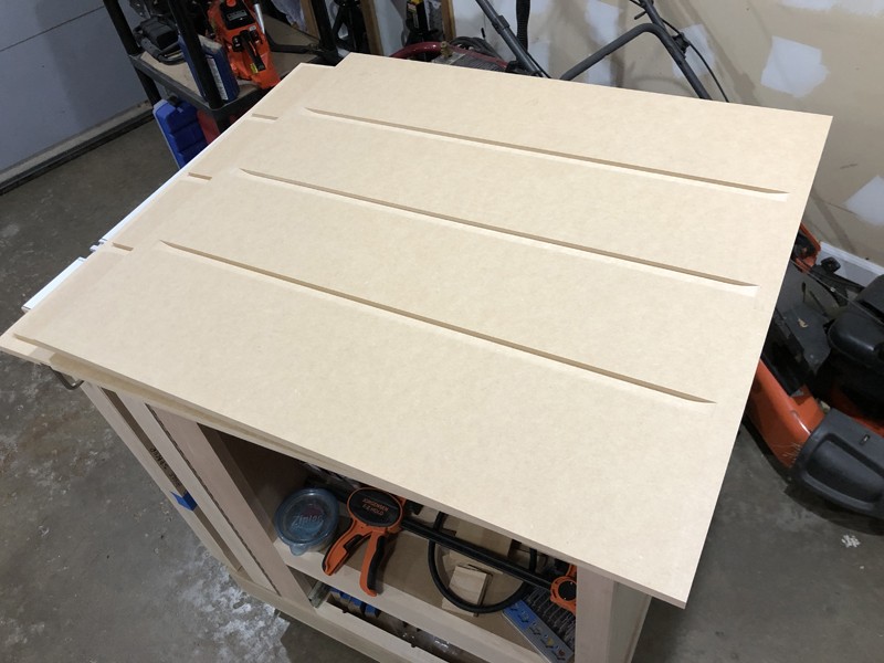

            And now chopping the top up again for t-track. I did not have a 7/8" router bit so I had to create a template and use a bottom- bearing router bit. Really, really nerve-wracking:

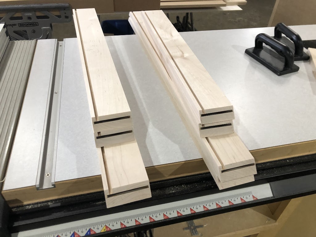

            After debating for a while, I elected to leave the radius at the tend of the t-track slots, and used the miter saw and a hand file to make the matching radius in the track:
            Routing for the t-track worked well except for some avoidable tear-out in the maple banding. Another oopsie. Epoxying everything into place:

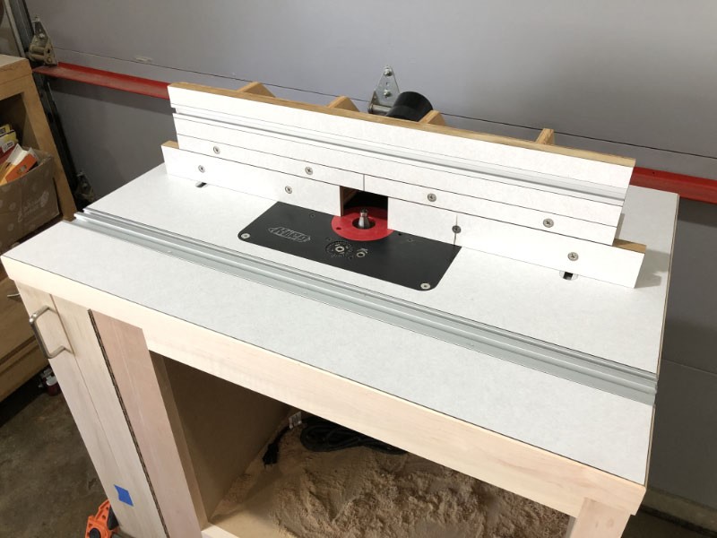

            Adding the WOOD Magazine router fence that I started, oh, 6-7 years ago:

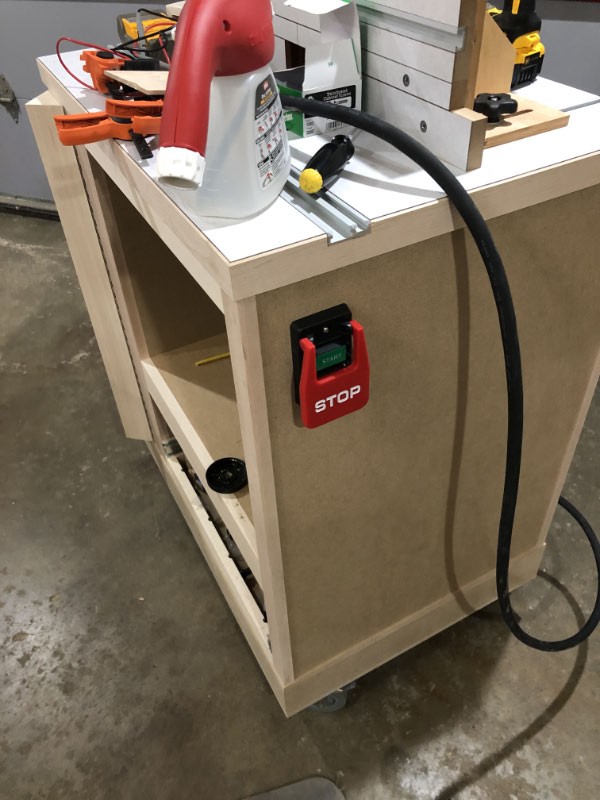

            And, lastly, a new safety switch:
            That's it for now. I'm shopping hard for a used cabinet saw and have been considering how to construct a mobile base for a larger, heavier saw that will still use the DNA of the bases and cabinets that I've built in this thread. I will post further once I have made some progress with that.

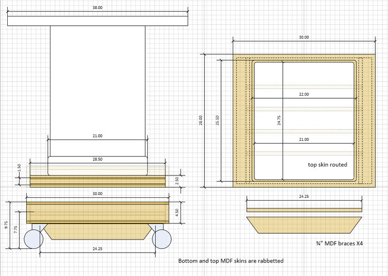

                      Here's the plan I came up with to hold a 400lb+ saw:

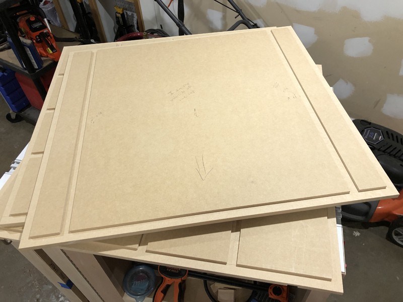

                      The torsion box can only be about 2-1/2" high in order to keep the saw table at my 41-1/4" working height. The sides remain 4-1/2" tall just like my other bases, and I routed out the top to achieve the "look" I was going for. To compensate for the shorter torsion box, I added 4" tall ribs across the bottom. Everything is registered using 1/4" dados. Here is the underside of the bottom skin showing the stopped dados for the bottom ribs:

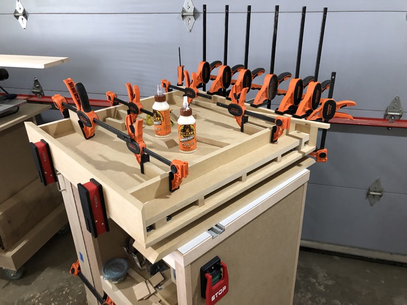

                      Next the dados and rabbets cut for the bottom and "middle" (shelf? platform?) skins. Both were rabbeted in order to line up the dados precisely, then I'll cut off the rabbets on the middle skin in order for it to fit down inside (hope the pics help this make sense):

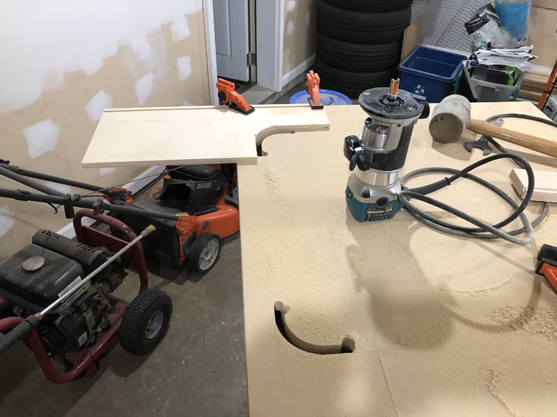

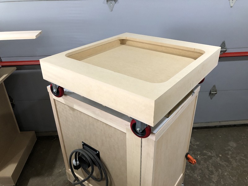

                        Now I'm routing the cut-out for the saw cabinet to sit down into. I used a 4-1/2" hole saw to form the radius in a template made out of 5mm birch ply, and routed it out with a bearing bit. The straight parts were done with just a straightedge. This was a bit too much of a job for my poor trim router, though.
