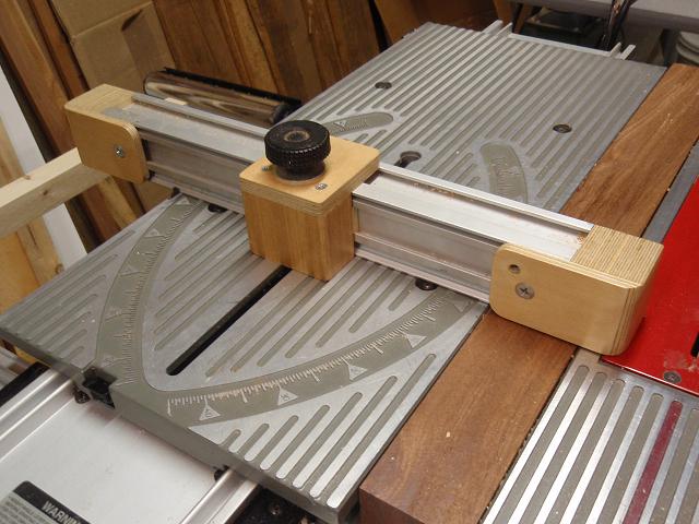

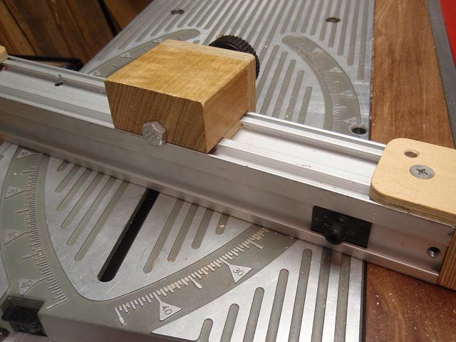

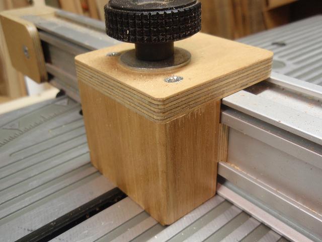

                              back to the OPs original question, it's been done where someone made the miter fence hold down block from wood. I'll try and locate the picture. It was done by our Australian friend and long time BT3000 owner Rod Kirby who has since moved on to another saw... I actually have the original Kirby hold down in my possession. I will take a picture tonight if I can't find one in the archives. All you need after that is the standard 5/16-18 x ? hex head bolt and washer available in any Lowes or HD or Ace hardware.
                              And a 5/16-18 female thru-threaded 5-star knob, should also be available in any decent hardware store.
                              Attached: photos of Kirby DIY Miter Fence Hold down:
