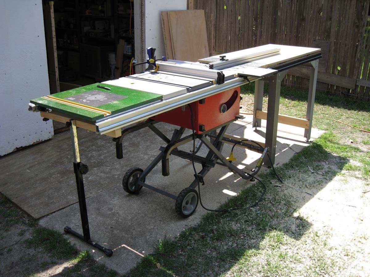

              You may be forgetting that you can move the rails. I love being able to slide the rails on my 21829 all the way to one side for cross-cutting long boards. for 12' pieces you still want some sort of outboard support, but sliding the rails, then clamping the work piece to the SMT will get you most of the way there.
              Doug Kerfoot
              KeyLlama.com
                I don't have a miter saw either.
                I've crosscut and halflapped 12' long 2x12s on my 21829 with the SMT. I also have a set of half rails on one end and I put another extension set on the other and I was using the long miter fence too. Sometimes I'll need a rigid flip-top stand or two. I will clamp the board to the fence.
                I prefer to rough cut the long pieces with a circular saw & speed square, or a hand saw for smaller boards, then take them to my 21829
                This is about 9'-3" of surface length.
