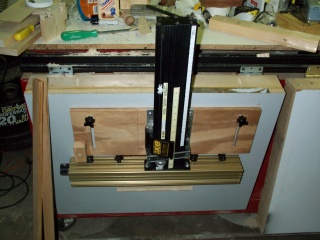

    Originally posted by Cike

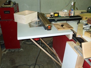

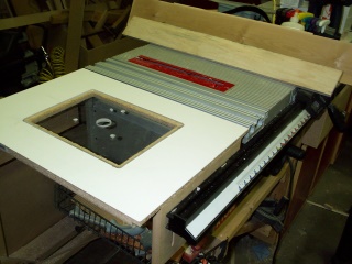

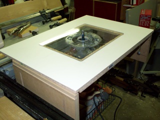

    Bill, do you have any pics?
    Sure.
    The white melamine top is the table I built to replace the factory accessory router table.
    The gray top melamine is the outfeed table. I have dual rails so this is way off to the right of the blade.

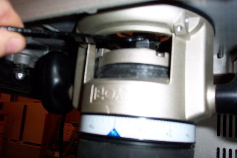

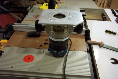

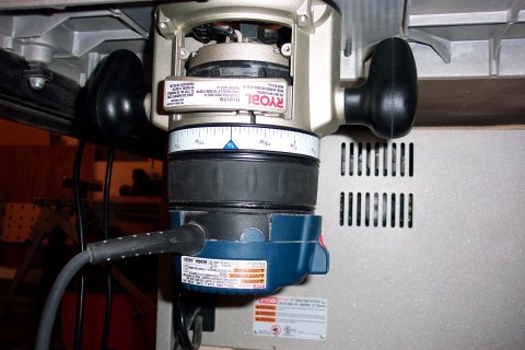

                When mounted, my router ends up with the axle-shaft stabilizing pin at the back, away from the user, so it can't really be reached to change bits when the router is mounted. This is doubly so, where the wrench won't fit in the space between the saw housing and the router.
                So that I understand, you attach the mounting plate so that the particular base that you use is positioned like this, correct? I'm using the fixed base; normally, I prefer the plunge base because it has the fine-depth adjuster.
                I agree that this configuration puts the collet locking pin at the back, which isn't convenient, but I don't find the collet locking pin to be unreachable.
                I don't understand what you mean by the wrench not fitting in the space between the saw housing and the router. Pardon the fuzzy image (I really need to get a tripod!), but even with the router at full depth, I was able to fit the wrench to the collet locking nut. Note that I took out the front dust shield to gain access to the collet locking nut.
                I think if you put a slight bend in the wrench, it may even fit in easier.

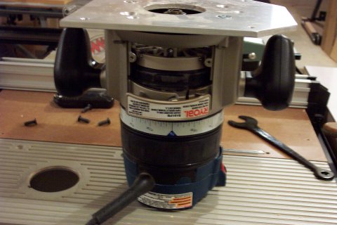

                The other option is to rotate your base of choice 180° like this:
                It makes the collet locking pin easier to reach, but then it makes using the wrench difficult.
                As to the issues with the Ryobi three base kit, I wonder whether I'm the one person that got the one good kit. I have not experienced the problems with depth adjustment when using the fixed or D-handle base. My shop is in the basement, so perhaps I don't have issues with contraction/expansion because the temperature doesn't fluctuate. Plus, I'm very dedicated to removing the motor and giving the unit and whichever base I used a thorough cleaning when I'm done.
                The collet locking pin took a few tries getting used to how it worked. Once you become aware of the hangups, then you're more in tune with how to avoid them.
                Brian

                    I'm not clear on why this is a problem (the clumsiness issue aside). Yes, dropping the router out of the base will lose your depth setting -- but you're only dropping the router out to change bits, right? And changing bits will itself cause you to lose your depth setting.
                    Unless I'm missing something ...
                    No, I think you're probably right. But the move is terminally inaccessible because of the other reasons stated. You just can't get at my router under the table. You have to remove the entire table, is my conclusion, because working under the table with the clumsy shaft stabilization pin and wrench which is too long to fit between the router body and the frame of the saw ...
                    Do you see what I'm saying?

                        Now, that is a TIGHT build-on. I must say. Don't suppose you created plans for it? Did you keep the Ryobi router table hardware?
                        Pretty neat job.
                        Thanks for the illustrations.
                        Don.

                                Brian,
                                BTW, thanks for all the obvious trouble you put into this thoughtful reply.
                                [ATTACH]4691[/ATTACH]
                                I don't have the router just now, as it's in the shop. But that doesn't look like what I have. I wonder if different bases are rotated, one from another? That would REALLY be a crazy piece of engineering.
                                It's pretty hard to get at, if not unreachable. I suppose I'm comparing it not with having the collet pin at the front; marginally better; but with having the router removable from the router table as with an insert. A whole lot better.
                                If you come in from the front, after removing the dust shield, it could be done. But I have the dust shield in, and need to both depress the pin and use the wrench in the same opening, which is away from me and between the body of the saw and the router body. I don't think anyone would see that as convenient. Also, as I remember, the wrench is too long to fit between the router body and the saw. Or, if not, it is so close to too long that it gets in the way.
                                If I take out the shield, that might be better, but then I will be coming in from both sides, under the table. Maybe I could get used to this. I still think for short term I will probably end up dismounting the entire table and throwing it up on the BT3 saw body or preferentially on the work table. That seems really much more direct.
                                [ATTACH]4692[/ATTACH]
                                [ATTACH]4689[/ATTACH]
                                [ATTACH]4690[/ATTACH]
                                It's neither expansion/contraction, nor debris causing it. It doesn't fit. Evidently Ryobi is going to fix it for me and anyone else who comes in within the warranty 2 years. IMHO they should fix it for everybody, as it's a defect that evidently results from a missed decimal point in engineering or production, and not breakage or the like. That is, I see this as more a product recall situation than a warranty situation, but if they will make the set work?
                                I can only hope things will progress.
